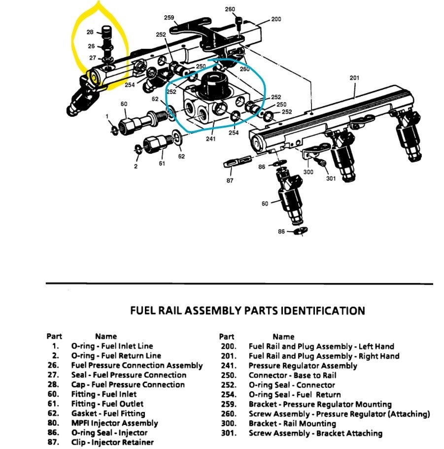

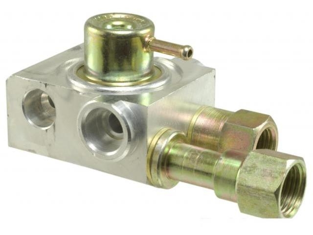

If they smell like fuel then it's possible you have an issue with the fuel pressure regulator or the pump, the problem there is that testing requires the engine be running at the time and you will need a fuel pressure test gauge which you can get as a loaner tool from many parts stores. The test gauge gets hooked to the test port on the fuel rail. Then you test the pressure with just turning the key on, then starting and running at an idle and then running at a higher speed. You want to see between 41 and 47 psi of fuel pressure with the key on, then at idle it should be between 3-8 psi lower with the vacuum line attached to the regulator and it should slowly increase as the rpms go up.
The other thing is to pull the regulator vacuum line off and see if there is any fuel in that line. If there is, you need to replace the regulator which on that engine isn't a fun job as you have to remove and take the entire fuel rail apart to replace the regulator block? For that you get the entire unit as a replacement Delco part number 217-3054.
