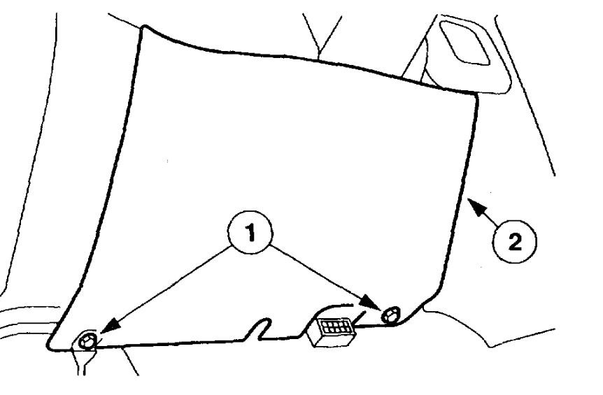

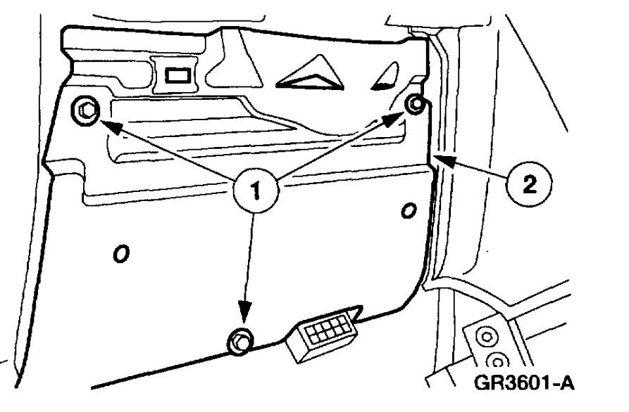

1. Disconnect the battery ground cable.
2. Remove the instrument panel lower steering column opening cover.
1. Remove the screws.
3. Remove the instrument panel lower steering column opening cover reinforcement.
2. Remove the instrument panel lower steering column opening cover reinforcement.

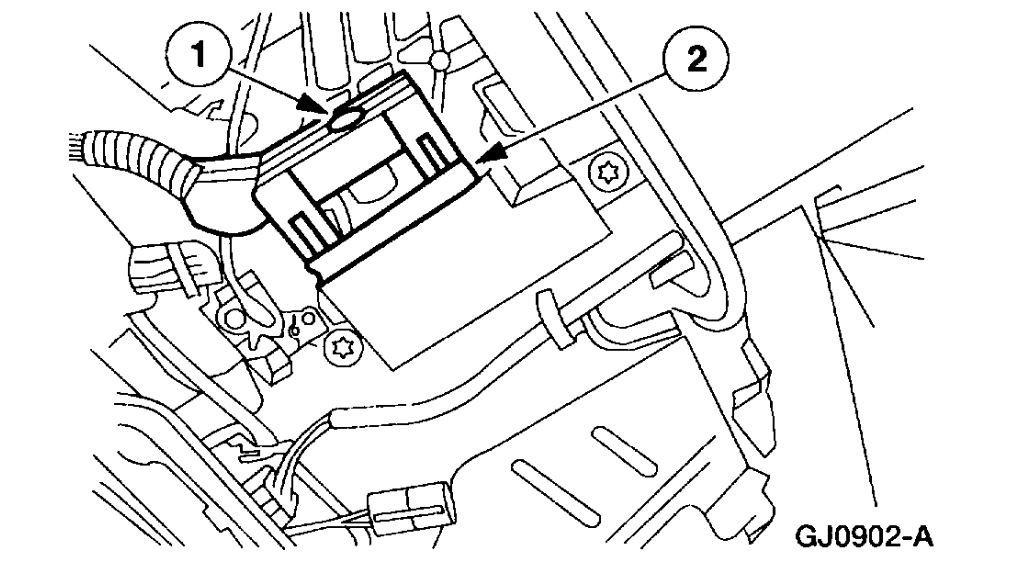

4. Disconnect the ignition switch electrical connector.
1. Loosen the bolt.
2. Disconnect the ignition switch electrical connector.

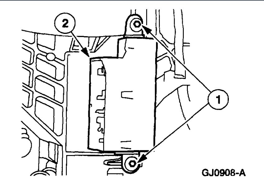

5. NOTE: The ignition switch should be in the OFF position.
Remove the ignition switch.
2. Remove the ignition switch.
