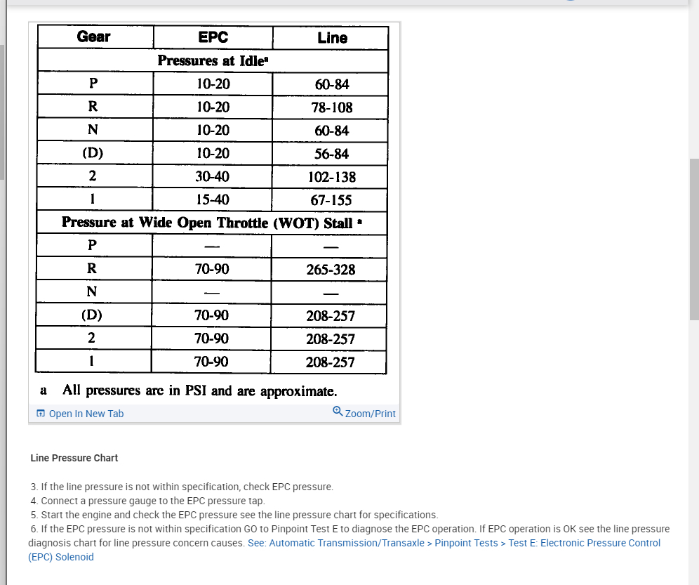

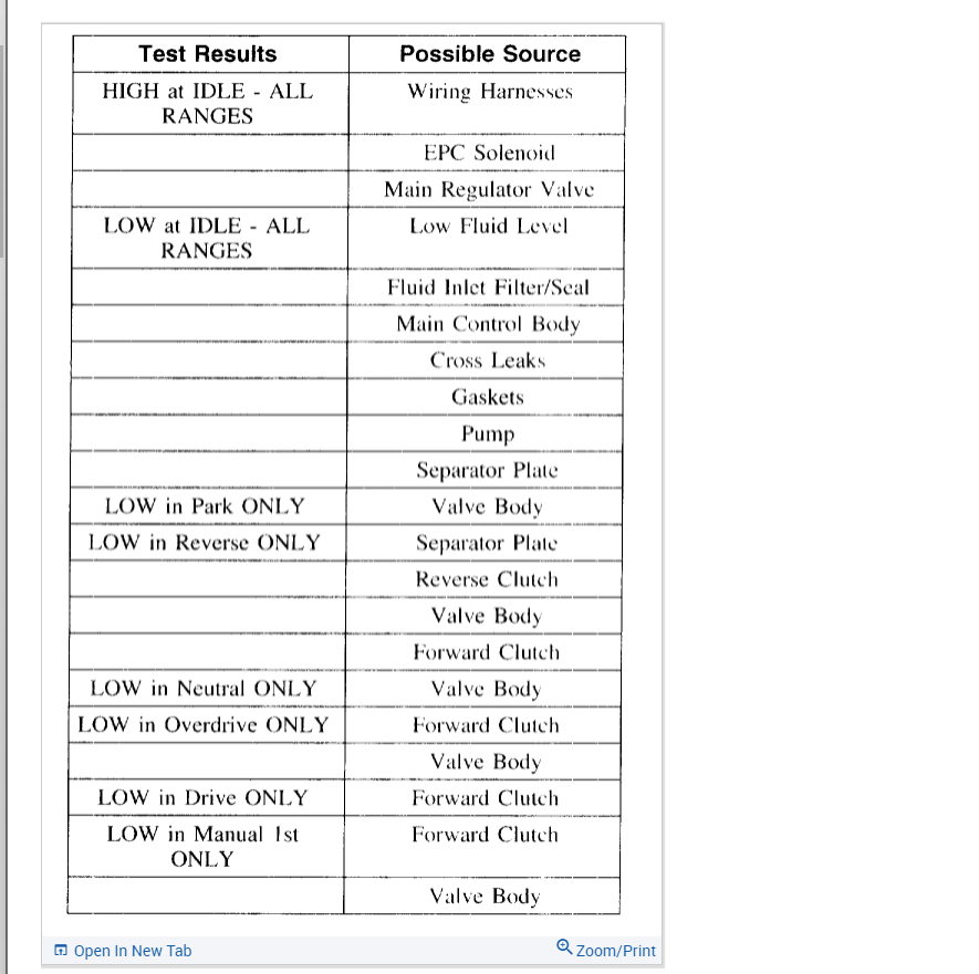

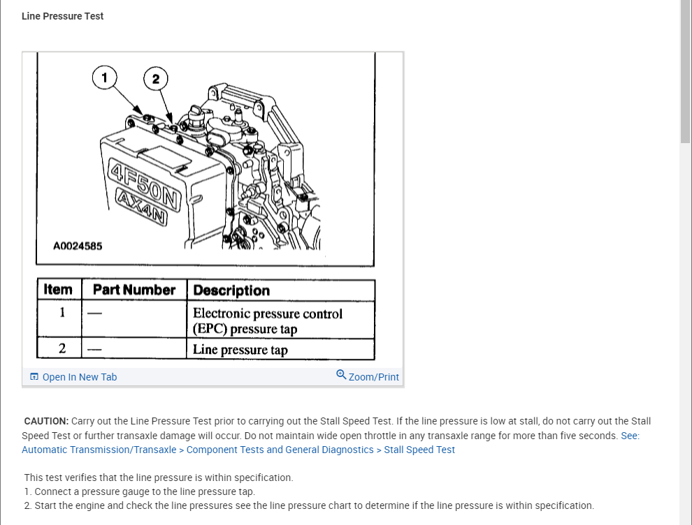

If the fluid is full and in good condition, then we need to do what is called a line pressure test.
This will tell us if there is an issue inside the unit with either the pump or seals not allowing the pressure to build.
I attached this info below. Please run through this testing and let us know what you find, and I am sure we can figure out next steps.
