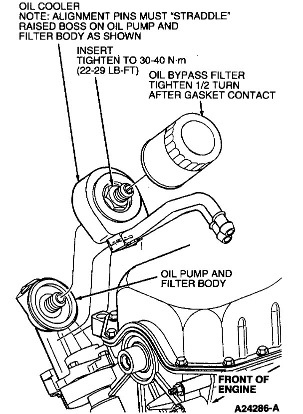

The oil cooler has a hole in it and you need a new one, Here is what I am talking about. Check out the images (below). Let us know if you need anything else.
