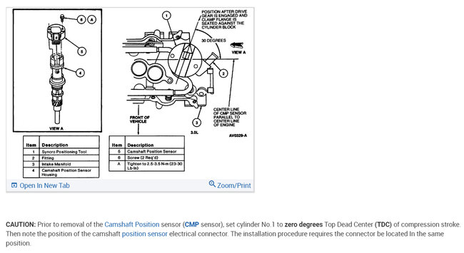

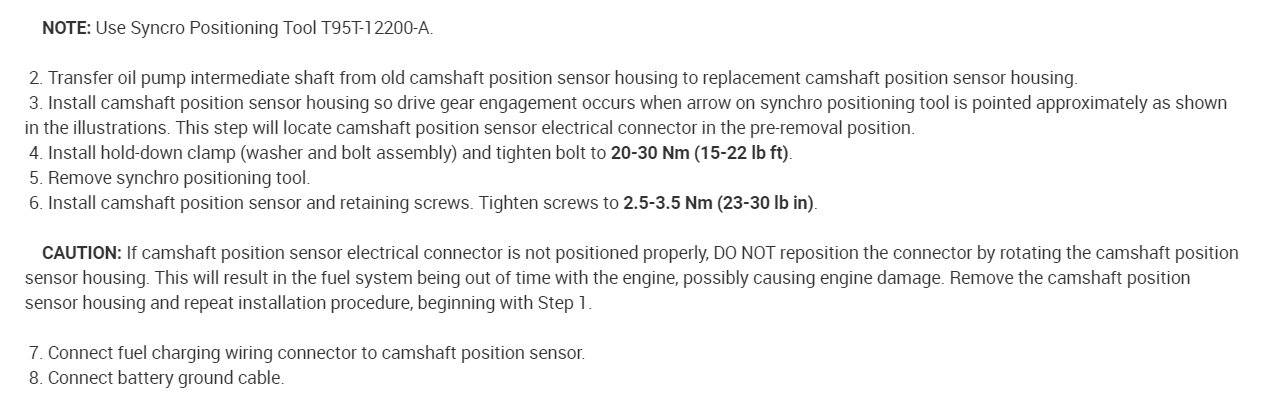

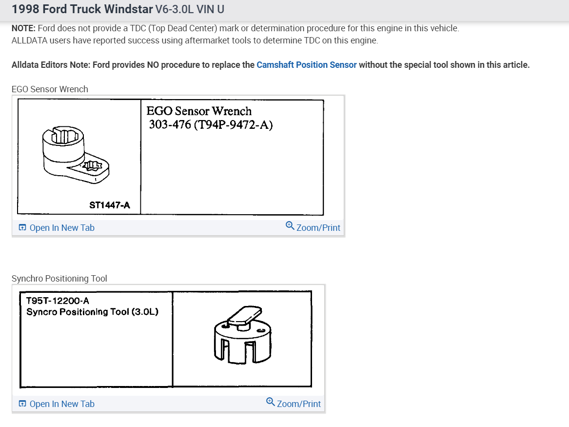

Here are the complete instructions on ow to replace the camshaft angle sensor. Check out the images (below). Please let us know if you need anything else to get the problem fixed.

Was wondering. Wouldn't it be simpler to use the alignment tool on the old unit, bumping or turning the engine until you could line it up with the tool? Then remove the unit and use the tool on the new one to reinstall. Rather than trying to find 27 degrees after TDC?
Apr 20, 2023 at 10:45 PM
Yep, you are correct, it is easier to proceed with the alignment before the removal of the old unit. Just make sure the alignment is still okay with the new part. You may need to move the oil pump drive rod slightly FYI.
