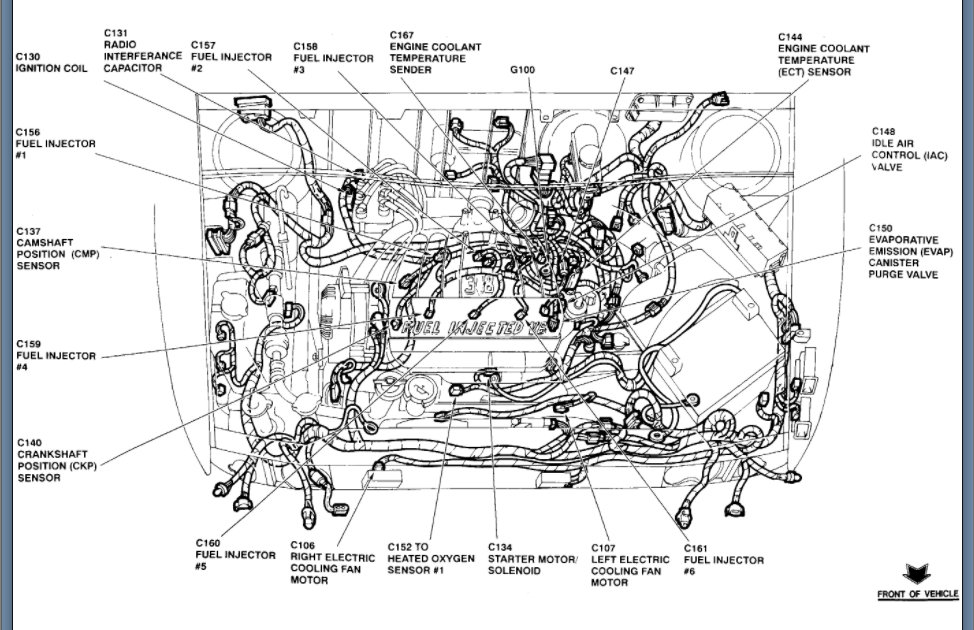

Here are a couple guides that will help with more info on this:

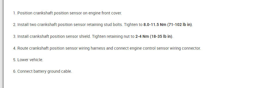

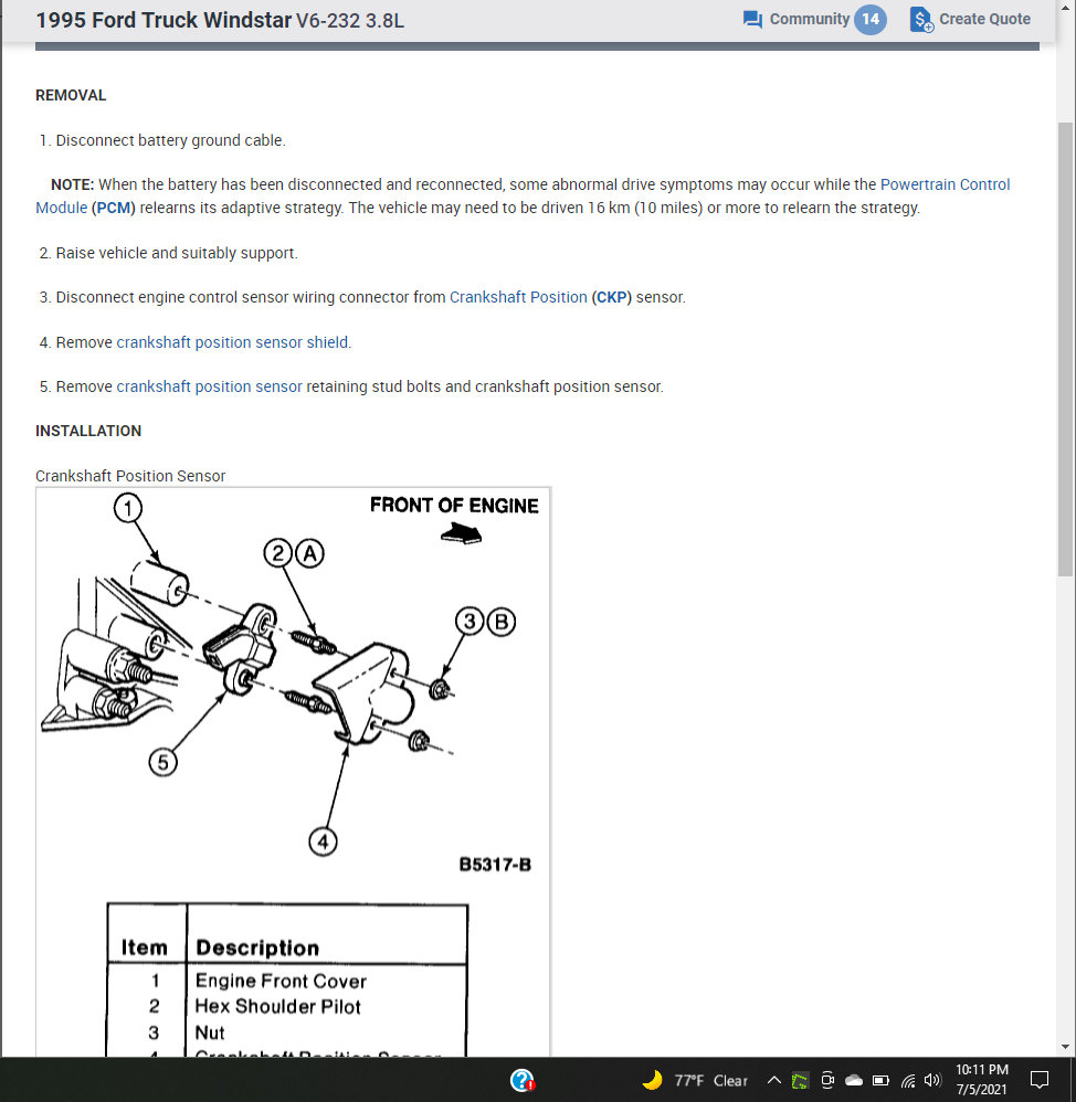

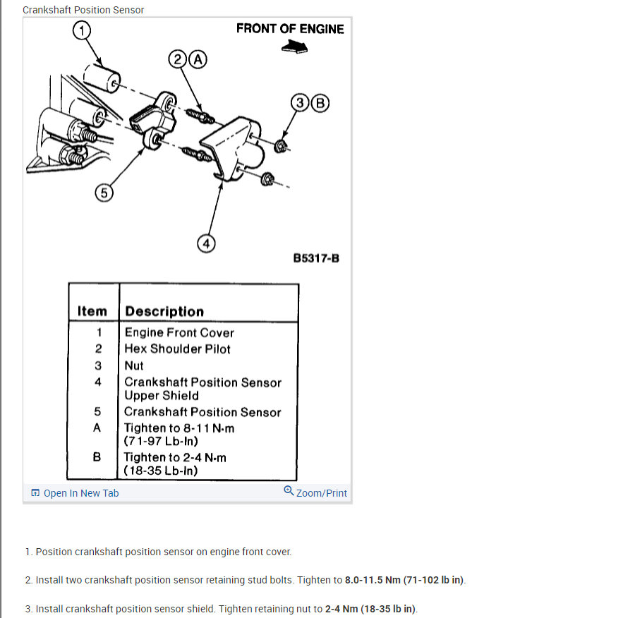

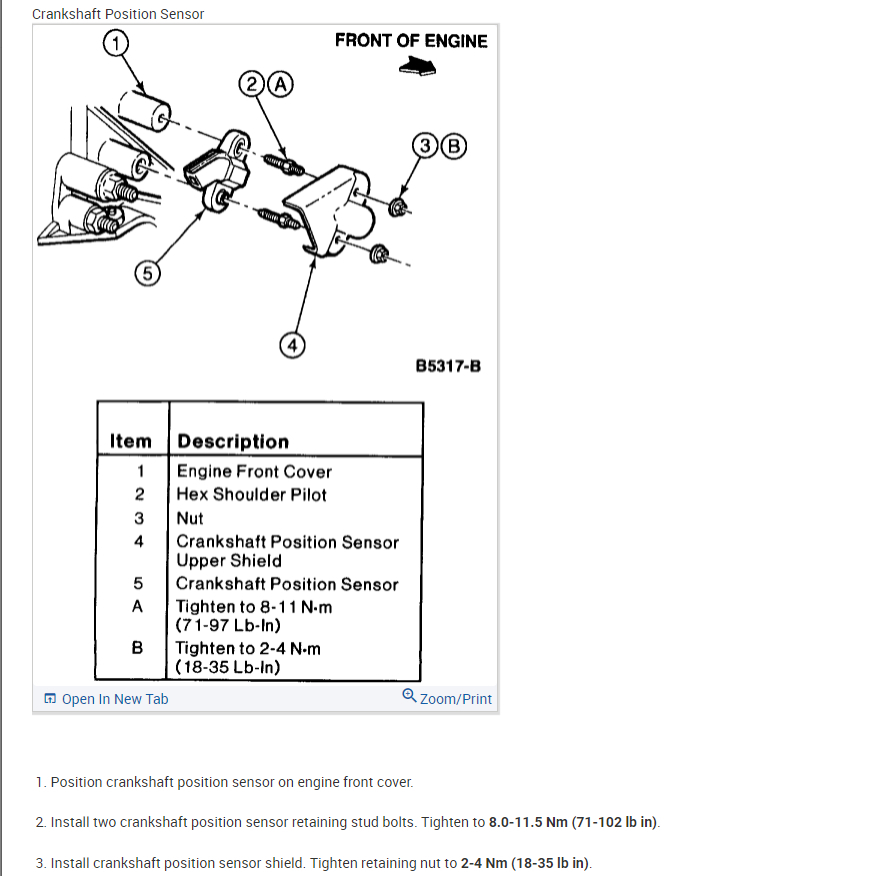

Below is the process from the manual that will give the detail needed in order to replace it if needed.
Please let us know if you have other questions. Thanks
