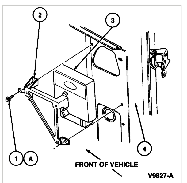

Here is the location of the engine computer, (PCM). There is no programming necessary. Remove the kick panel on the passage side of the car, (inside) the computer is behind it. Check out the images (below). Let us know how it goes
