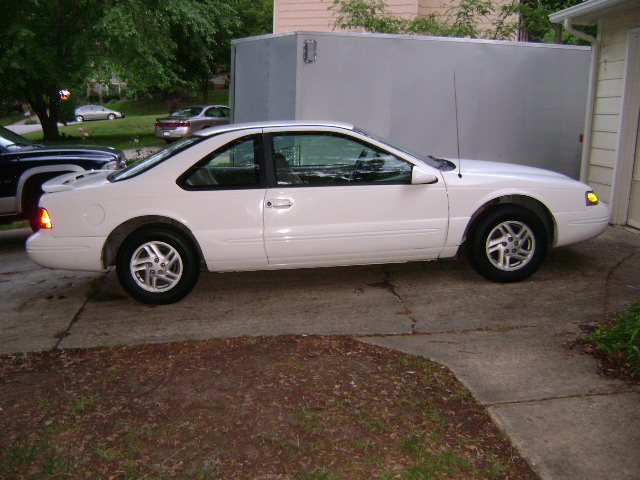

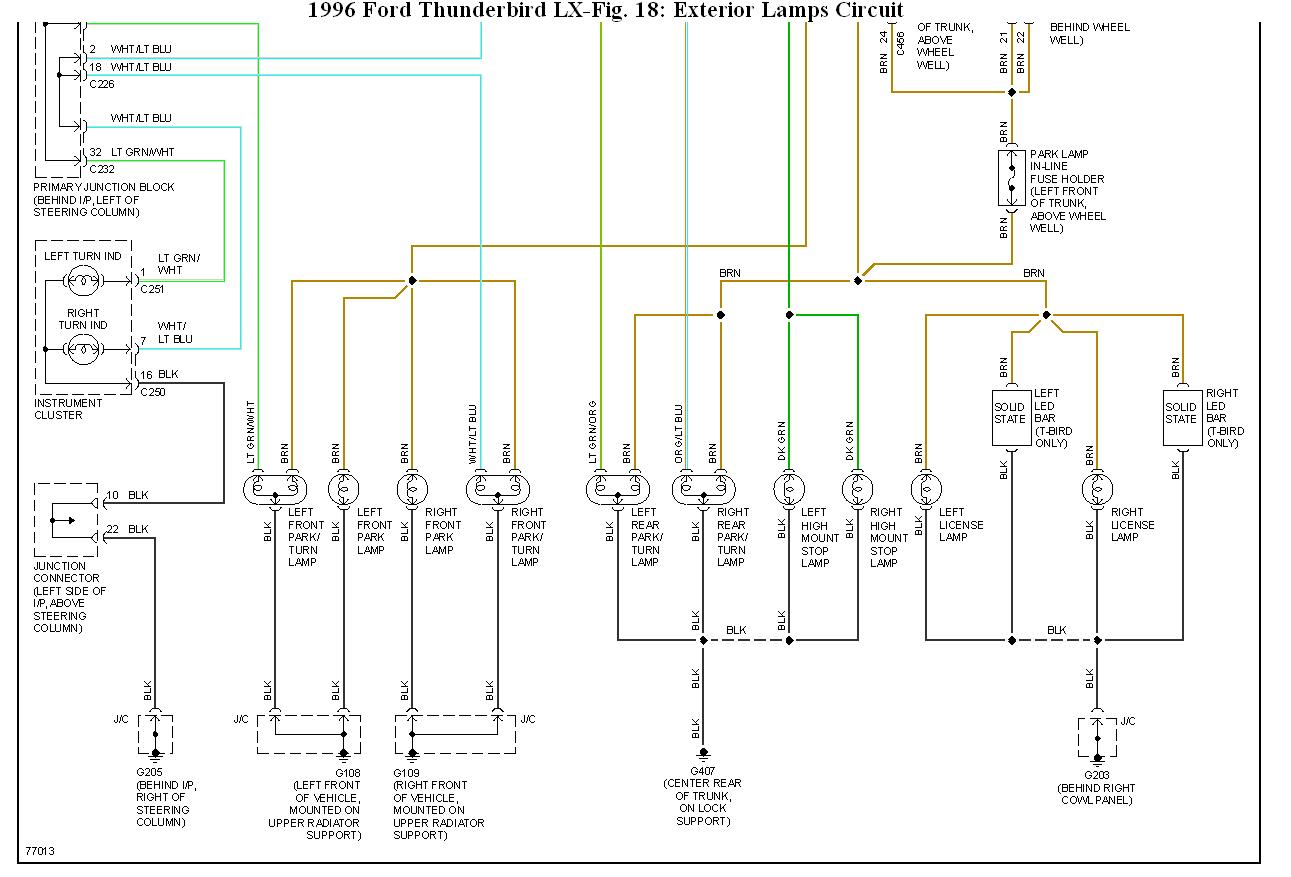

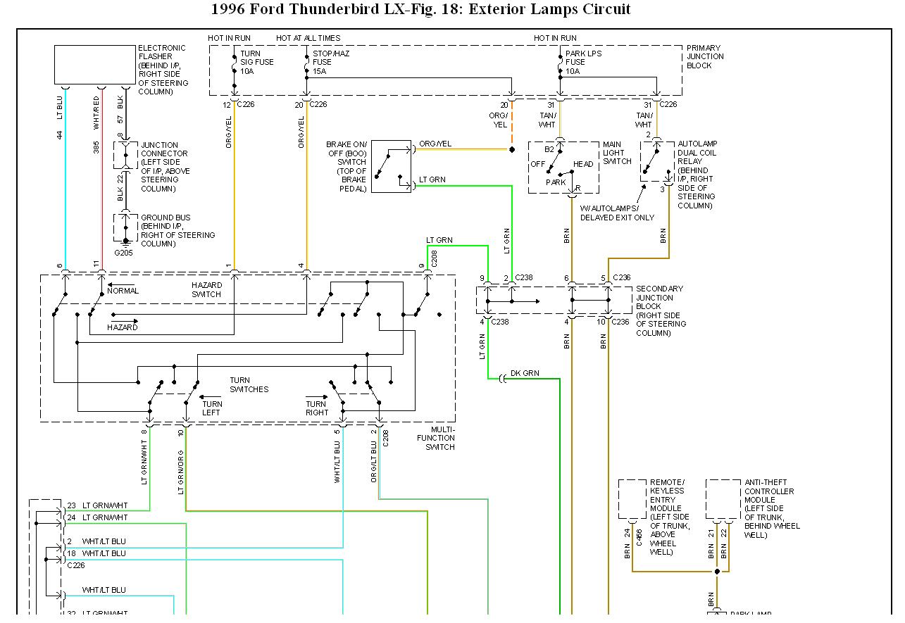

Left & right outer lamps do not flash when turn signals are activated (sequentially) all lights do operate when brakes are applied. The sequintial flasher, the turn signal relay and the stop lamp relay in trunk have all been replaced to no avail, problem not corrected. Lamps are good, wireing in trunk feeding the lamps are O.K. Where do we go from here?
