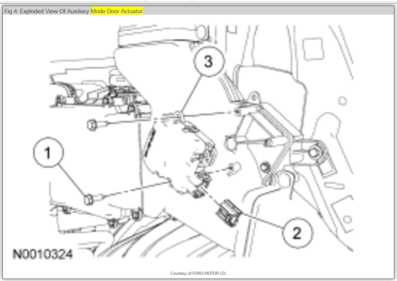

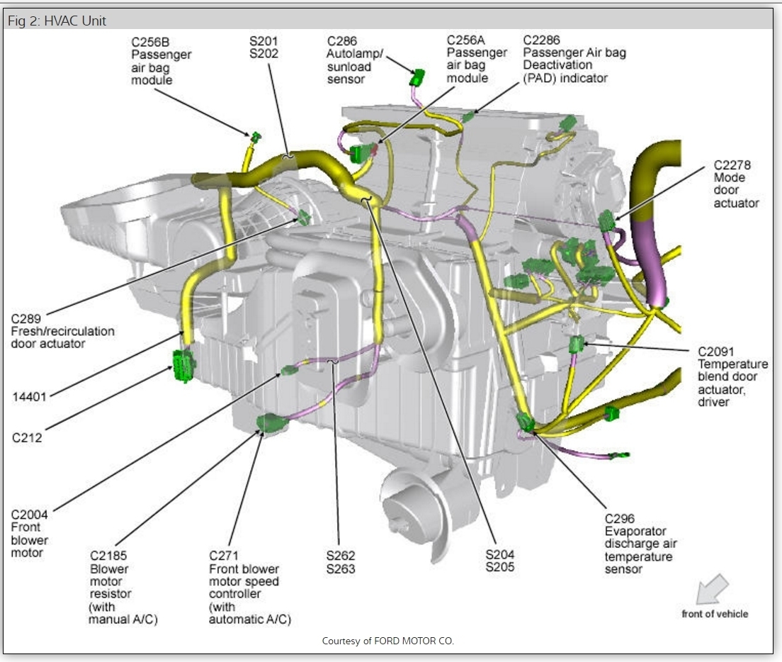

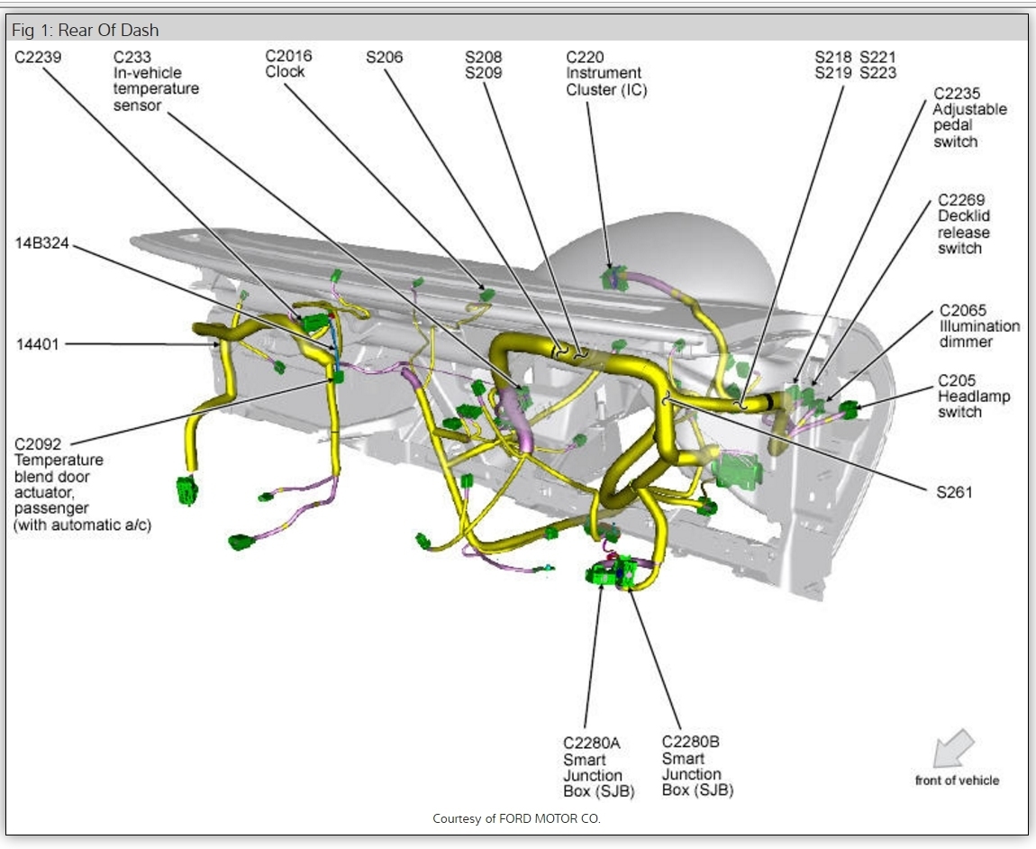

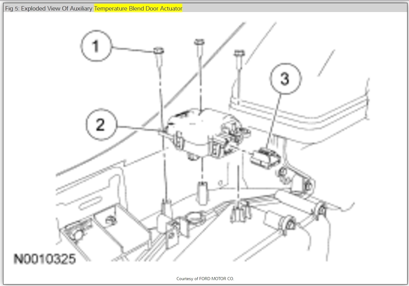

Hey guys!
Yes this is a common problem with this car and the fix is to replace the blend door actuator, the problem is this actuator has plastic gears inside which break which causes the tinking noise. here is a guide that will show you what you are in for along with a diagram to help you replace the actuator yourself and save some cash.
Please let us know what you find so it will help others.
Best, Ken
