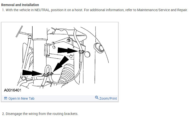

when applying brakes the ABS comes on I did some checking and the right front ABS wheel speed sensor is bad can you help please?
Jun 25, 2009 at 9:38 PM
DANNY L
  • 5,648 POSTS
Hello, I'm Danny.

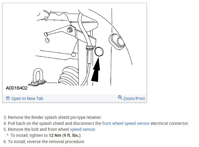

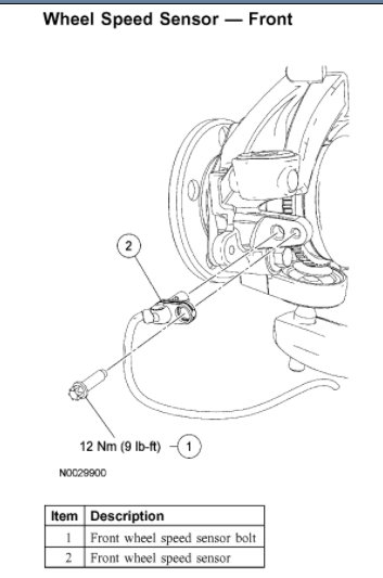

Here is the information you requested. Here is a guide to help you step by step with instructions in the diagrams below to show you how to perform the repair on your car:
https://www.2carpros.com/articles/how-to-replace-an-abs-wheel-speed-sensor
I've attached picture steps below on how to change the wheel speed sensor on your car. Hope this helps and thanks for using 2CarPros.
