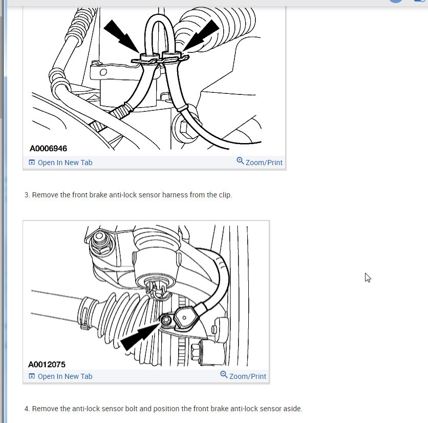

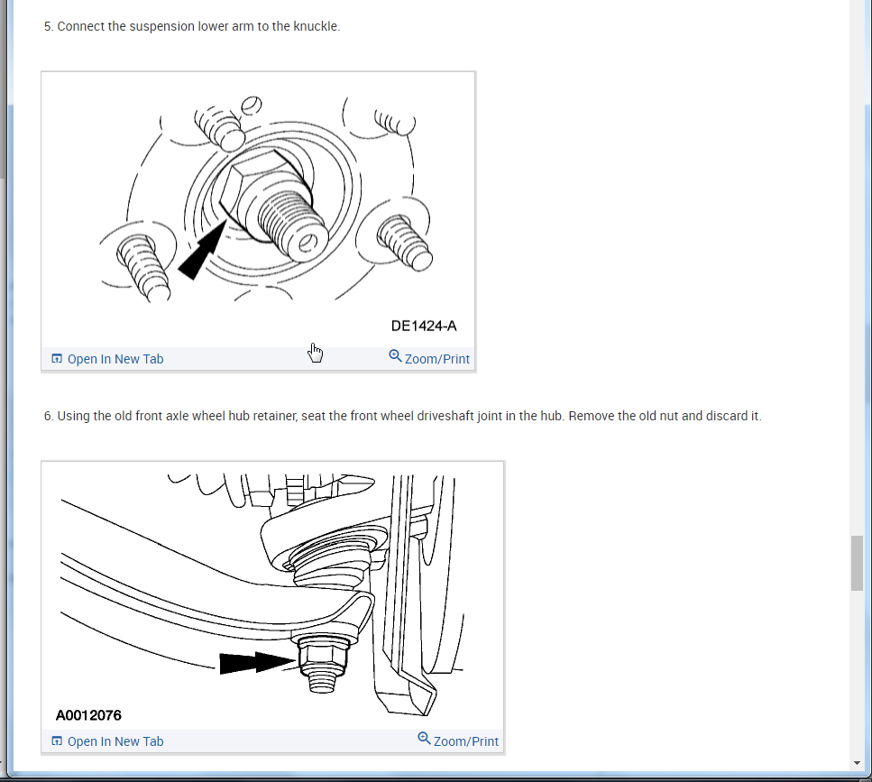

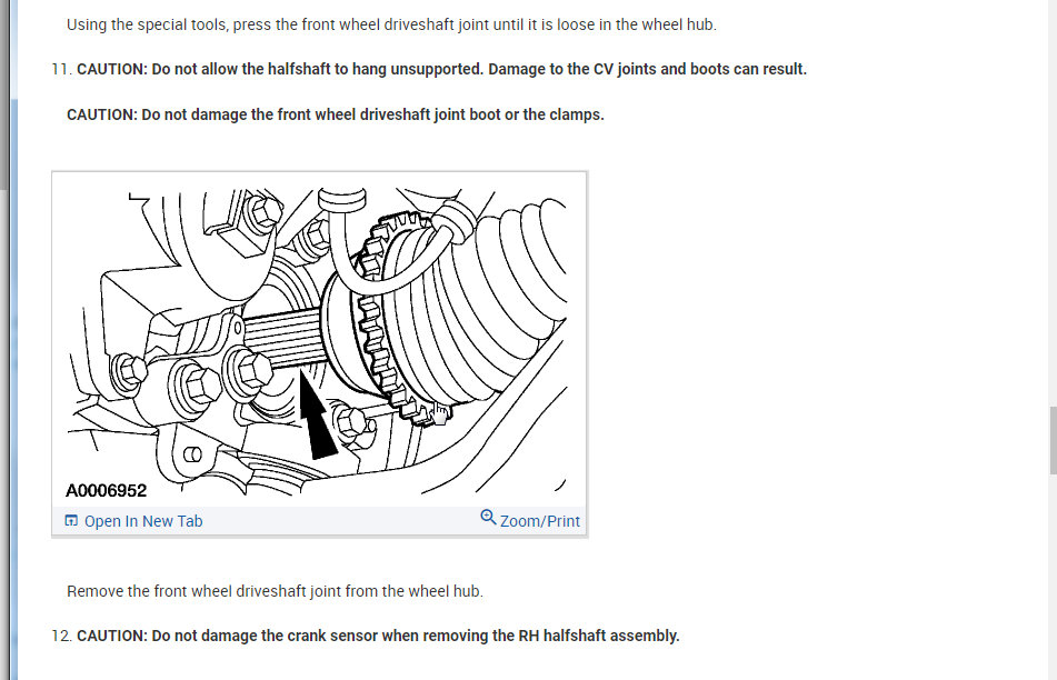

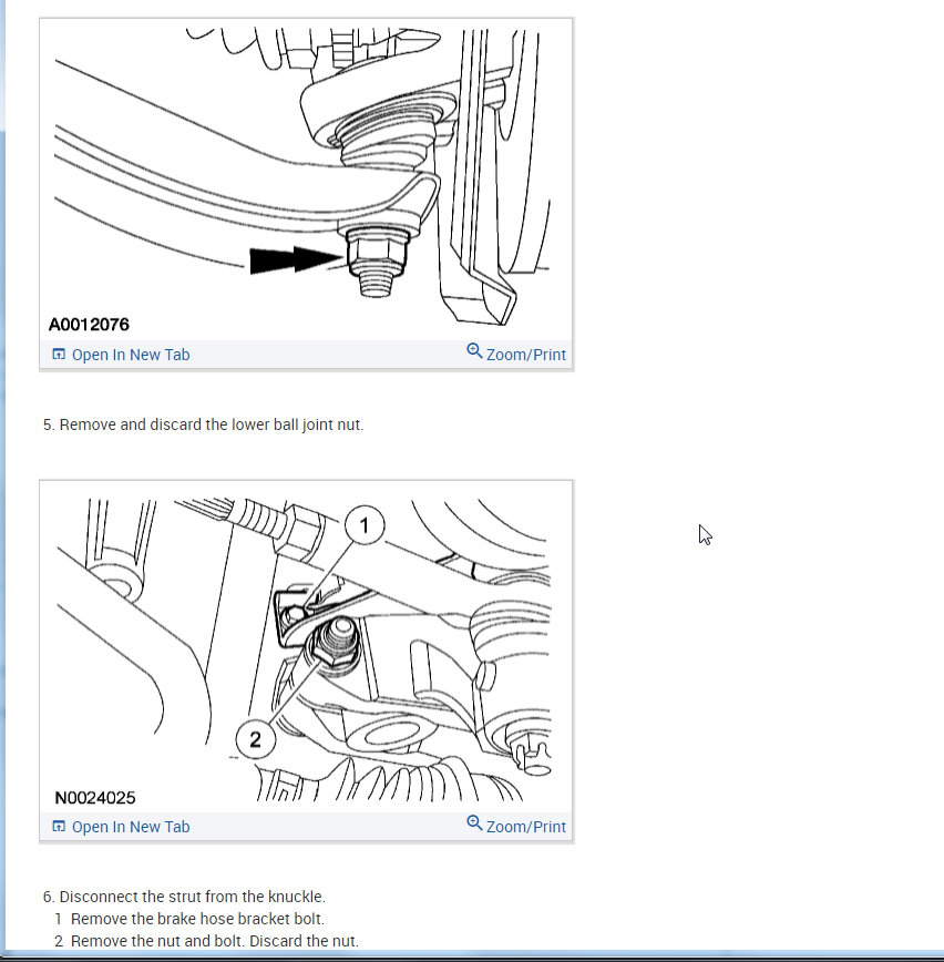

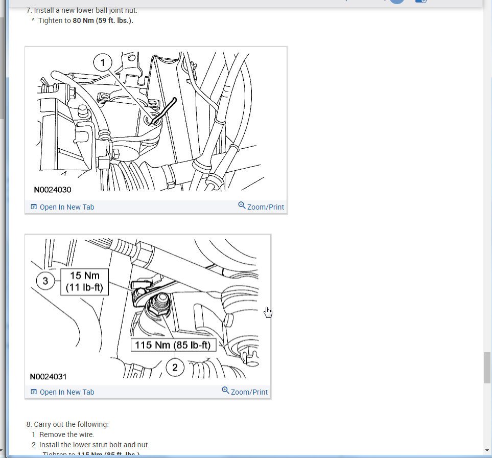

Here are some guides on how to replace the axle:
https://www.2carpros.com/articles/replace-cv-axle
https://www.youtube.com/watch?v=XeqT-_fwVQg

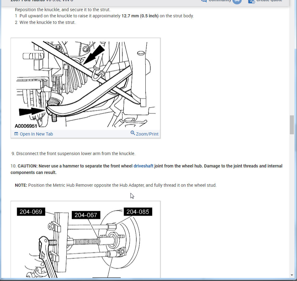

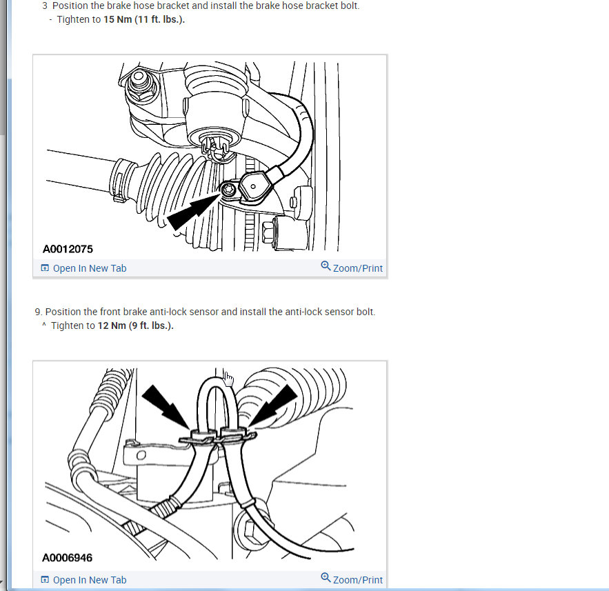

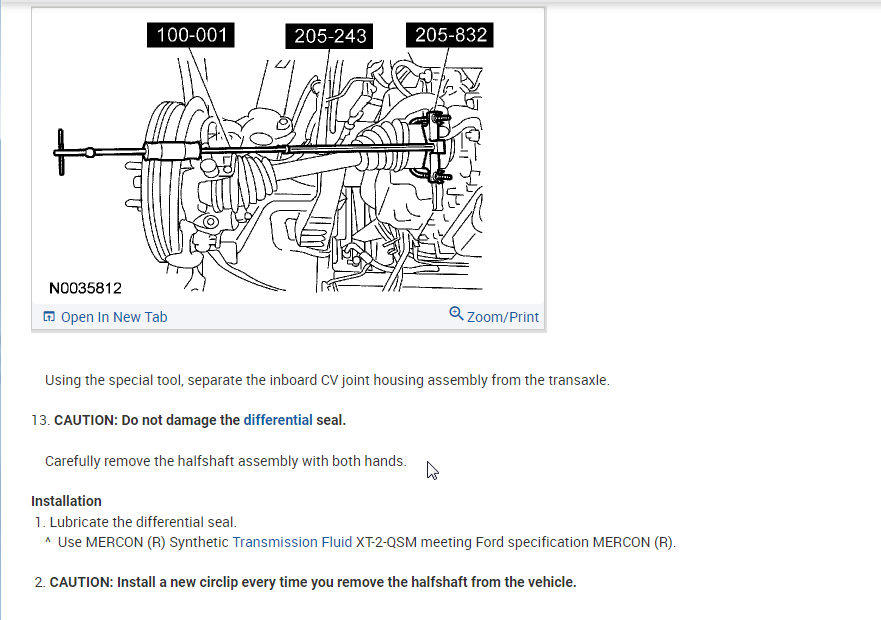

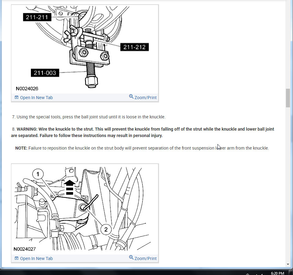

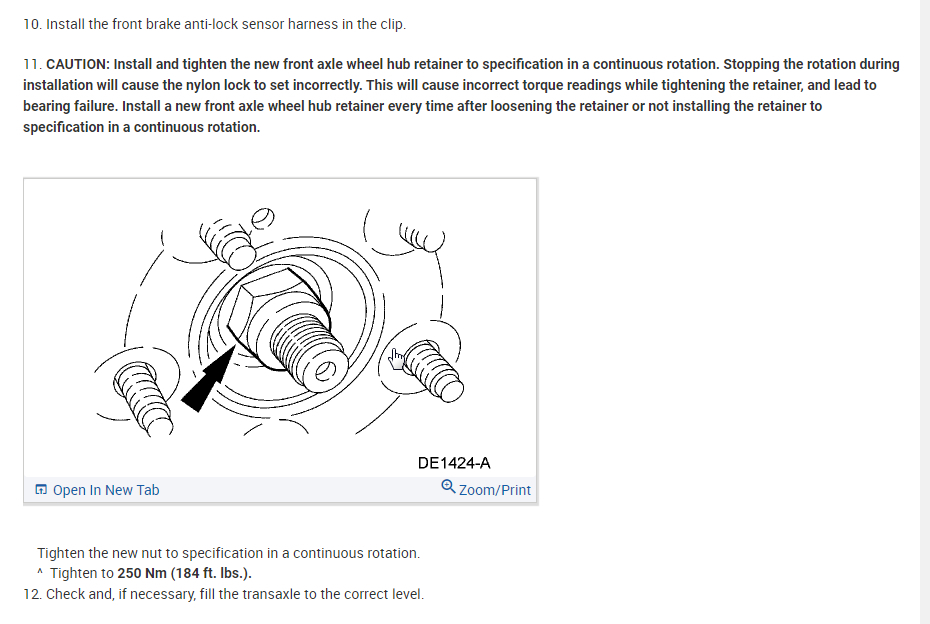

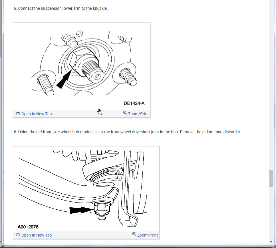

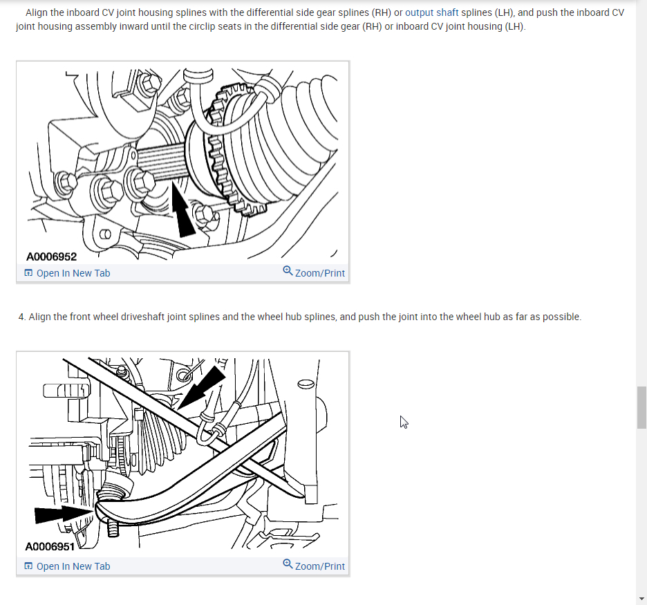

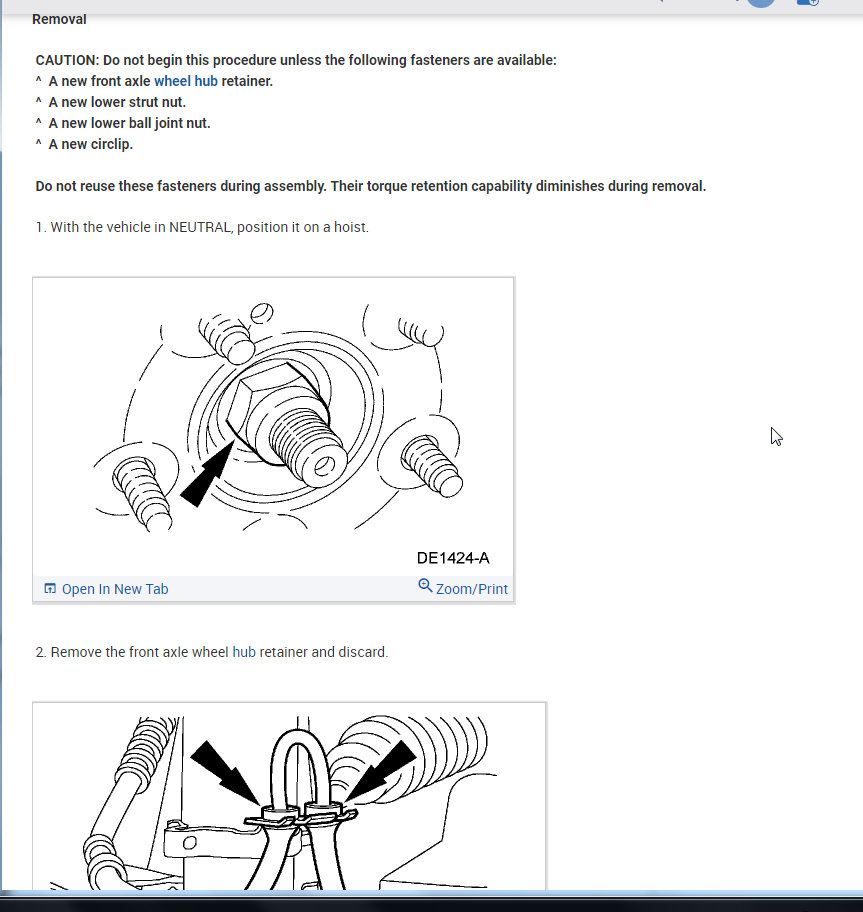

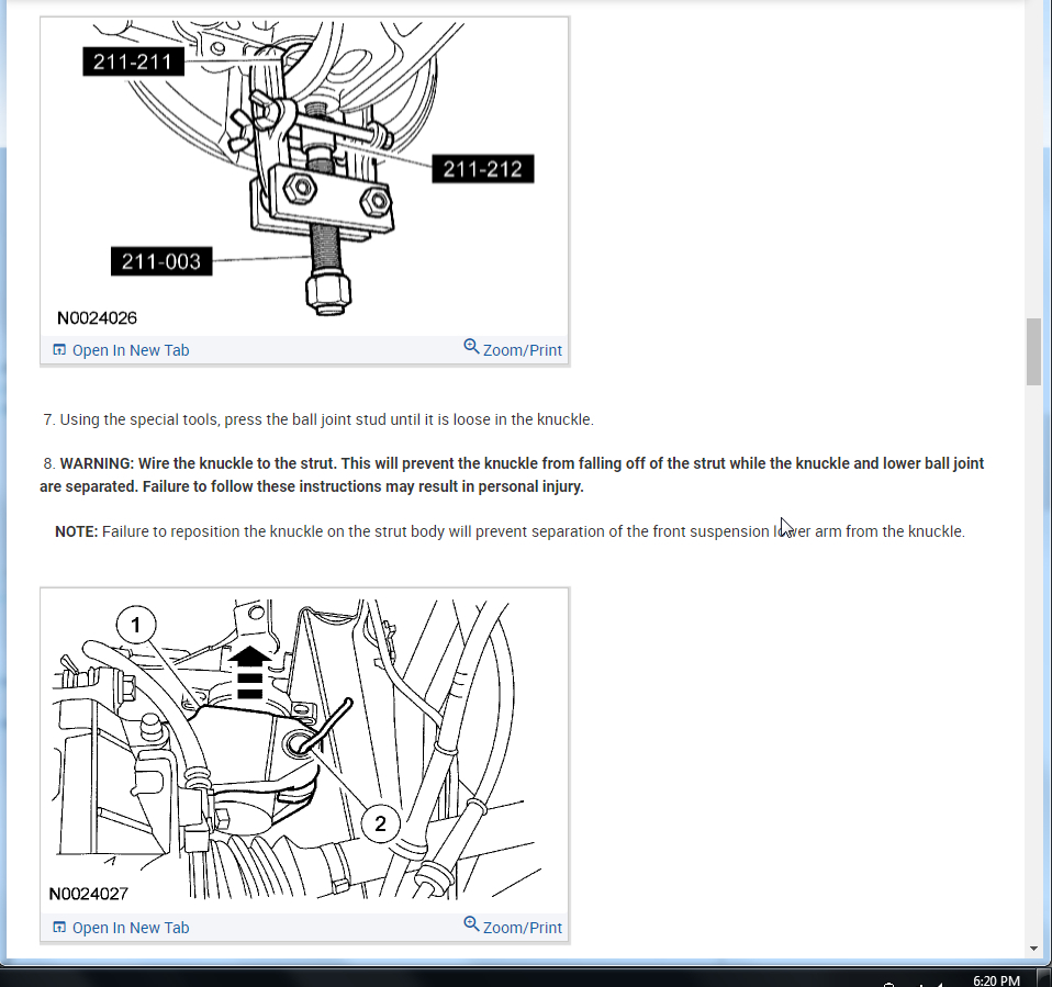

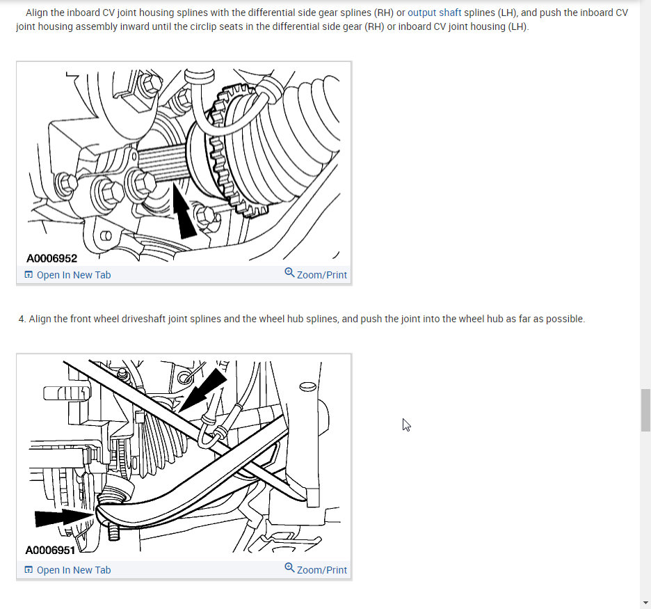

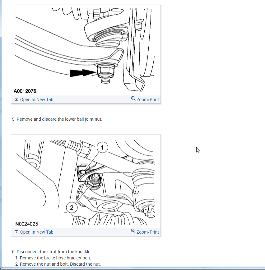

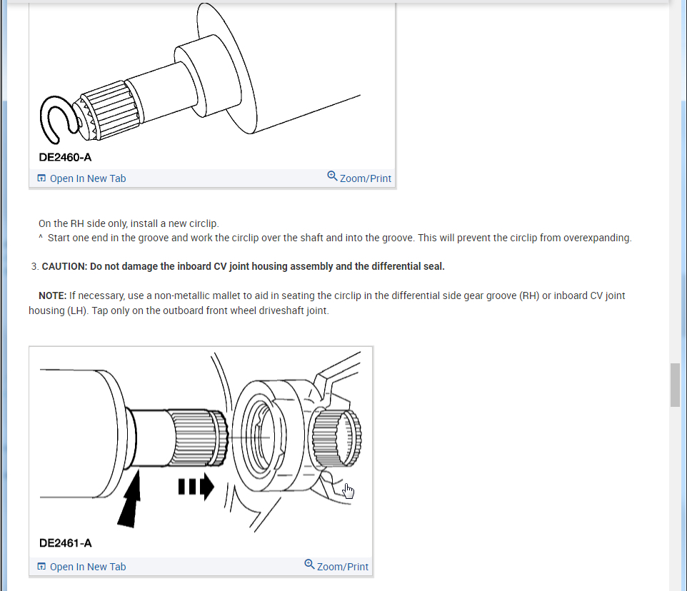

Below is the process from the manual on how to replace the halfshaft. Please let us know what questions you have and we can go from there. Thanks
