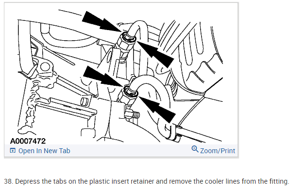

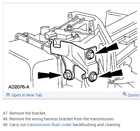

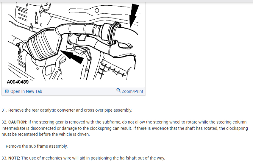

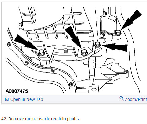

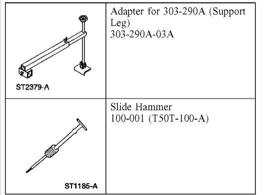

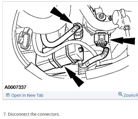

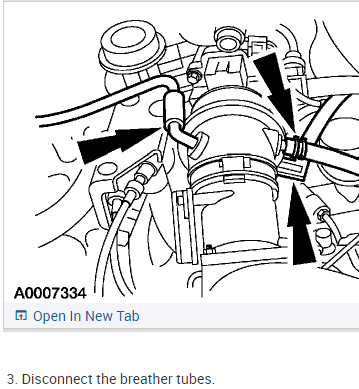

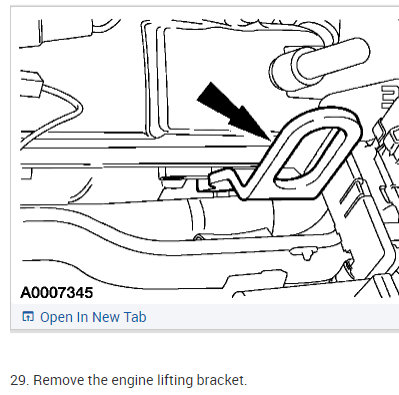

i am trying to remove my transmission and need some help can I get instructions please?
Feb 15, 2010 at 9:09 PM
DANNY L
  • 5,648 POSTS

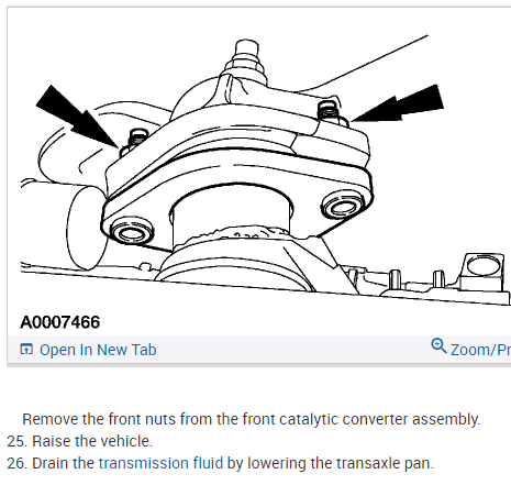

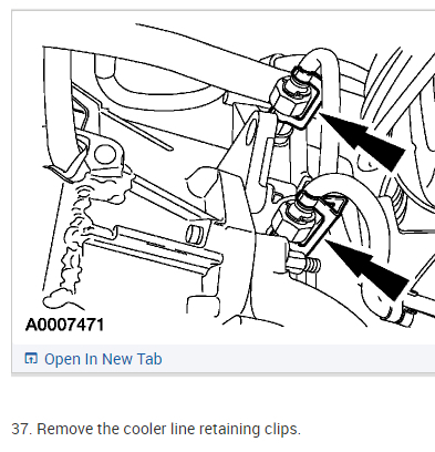

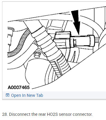

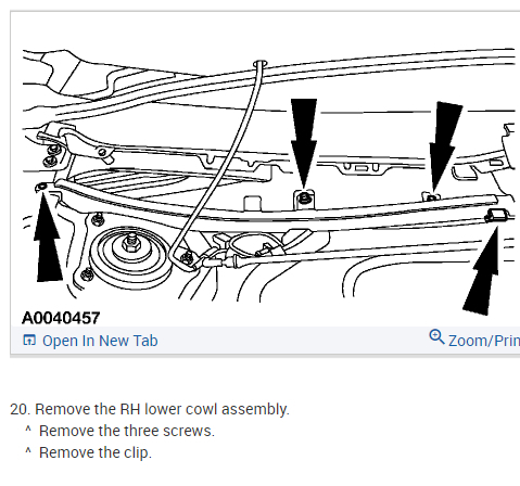

Hello, I'm Danny.

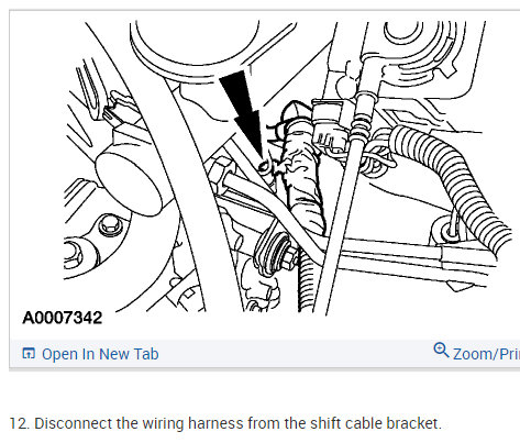

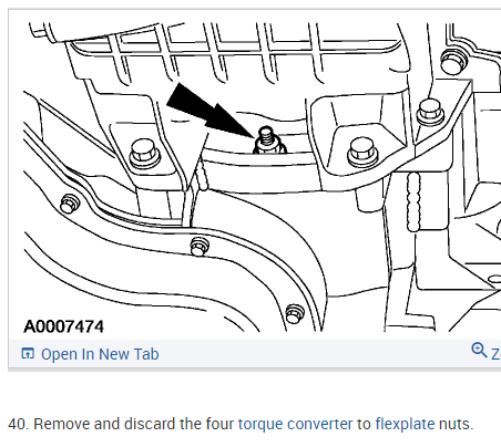

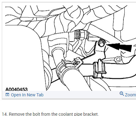

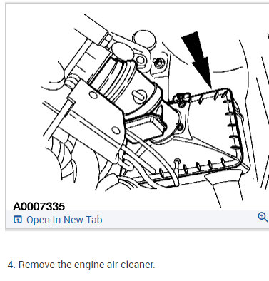

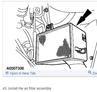

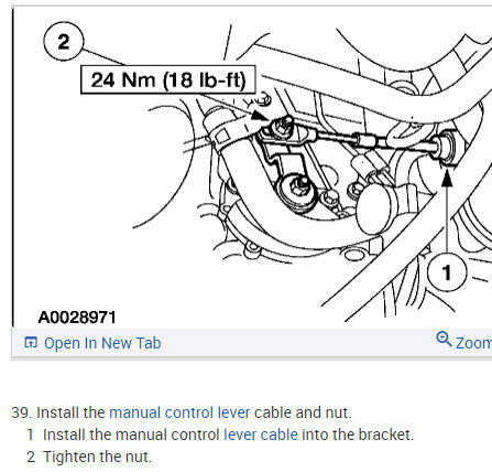

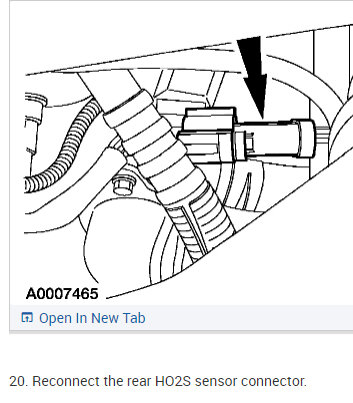

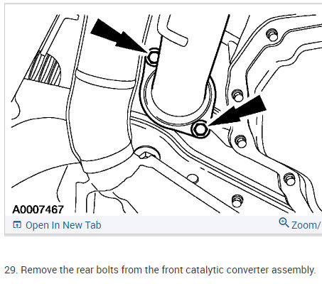

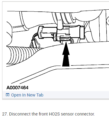

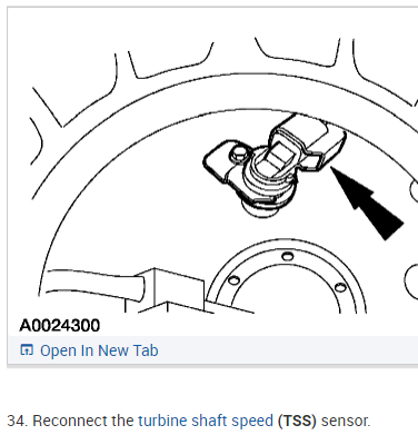

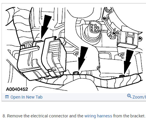

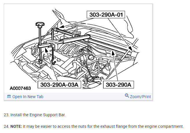

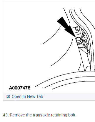

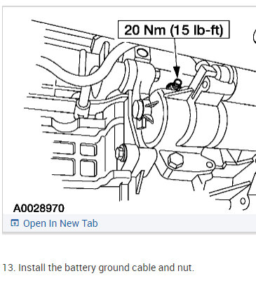

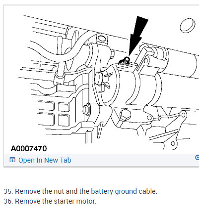

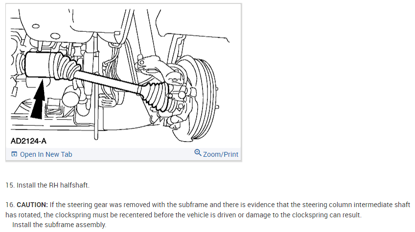

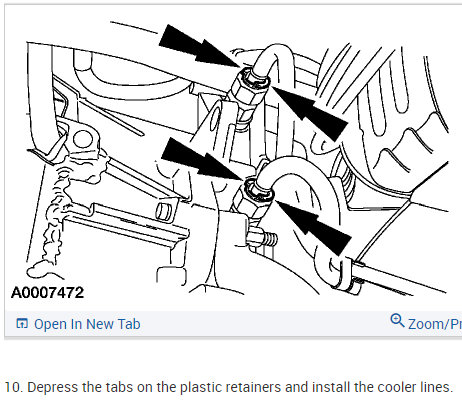

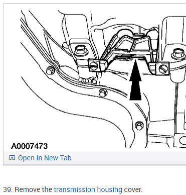

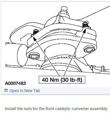

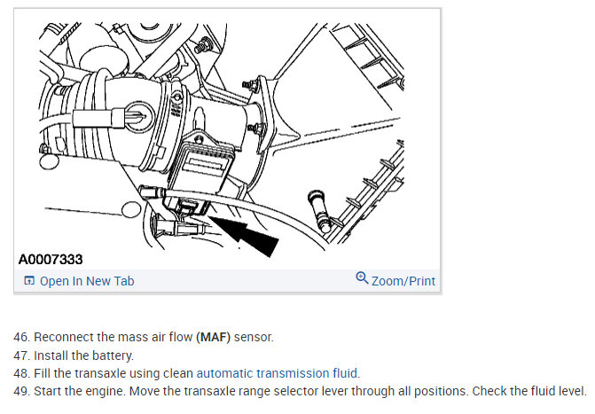

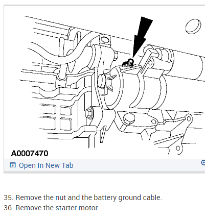

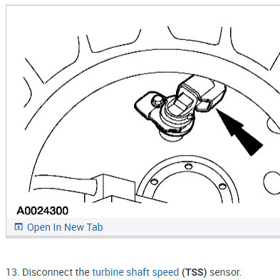

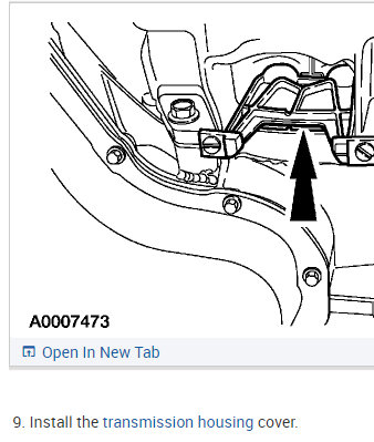

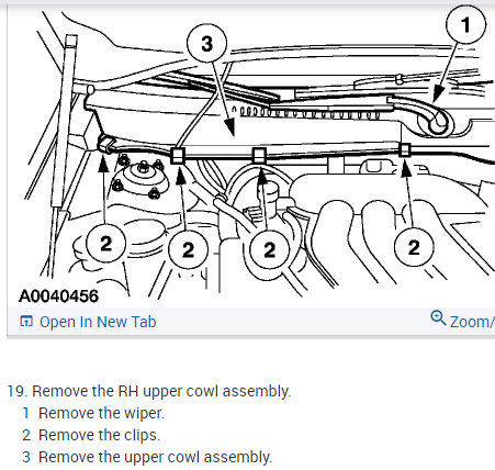

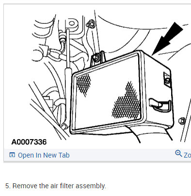

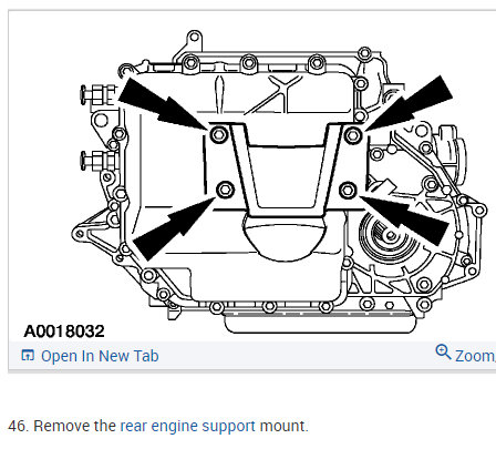

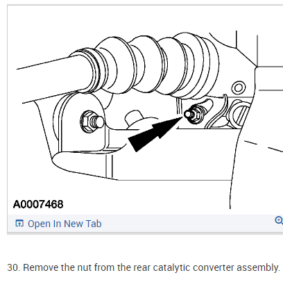

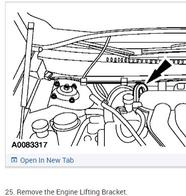

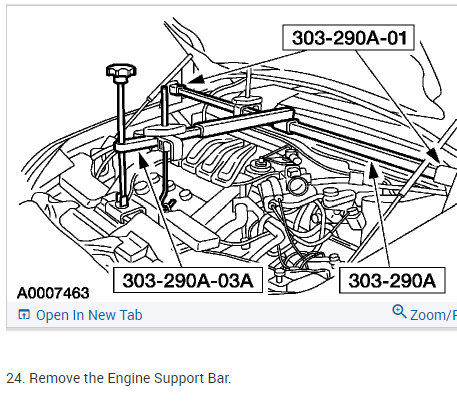

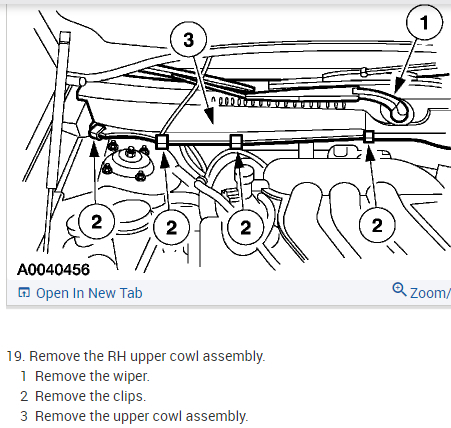

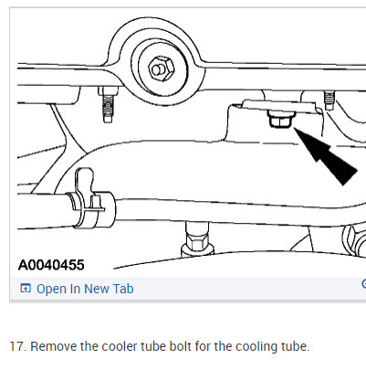

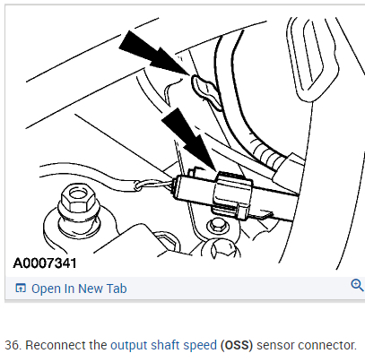

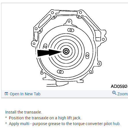

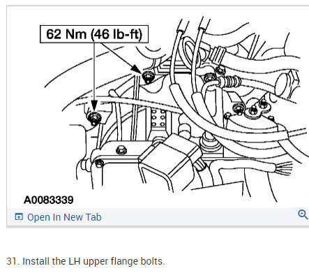

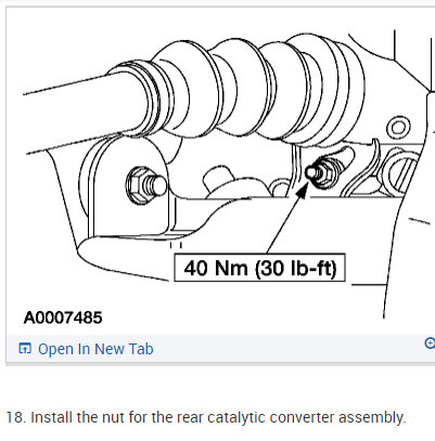

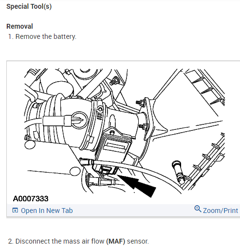

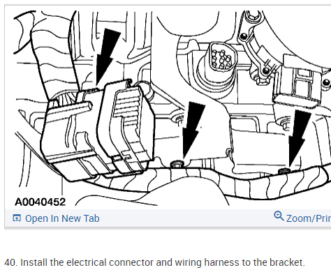

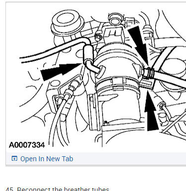

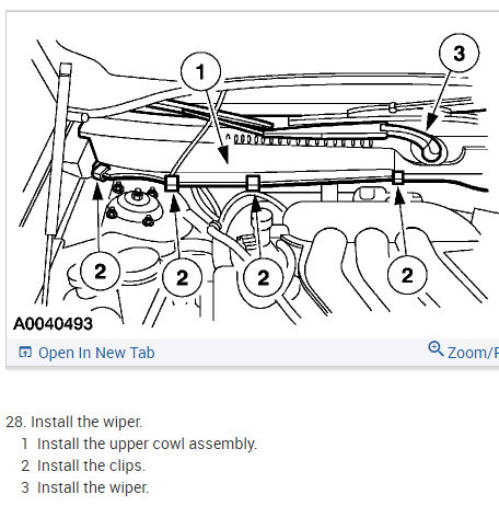

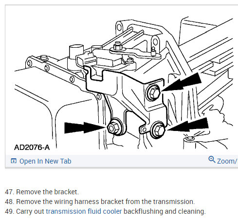

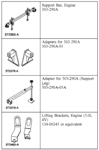

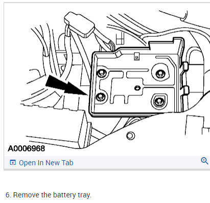

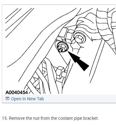

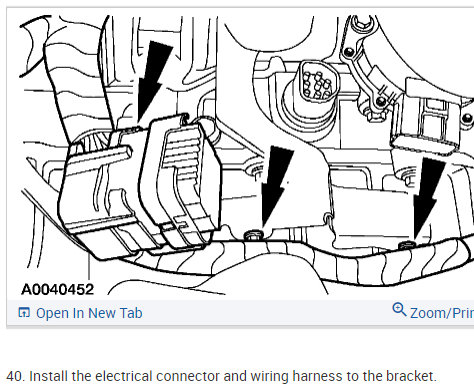

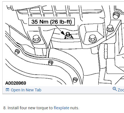

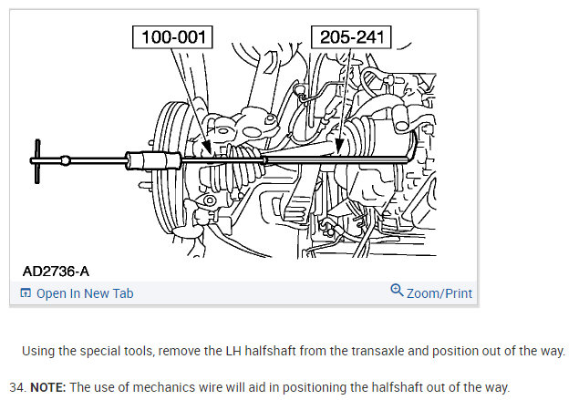

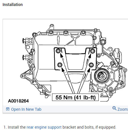

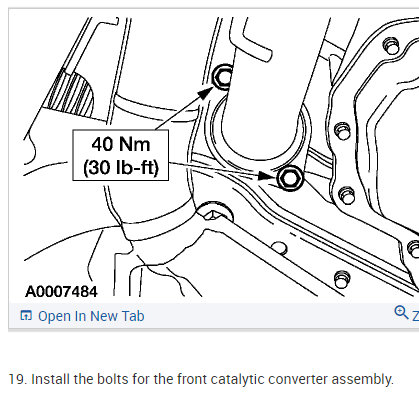

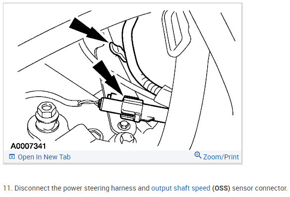

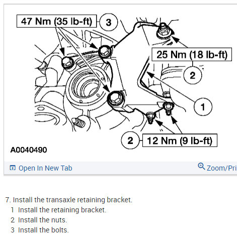

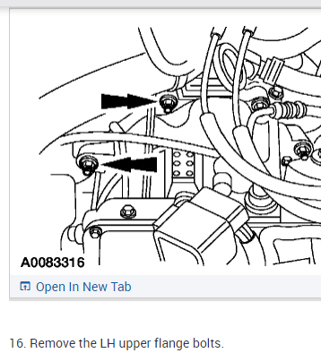

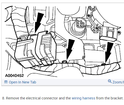

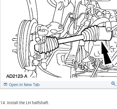

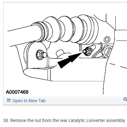

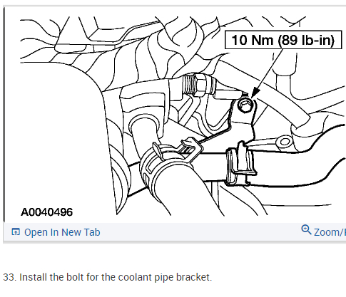

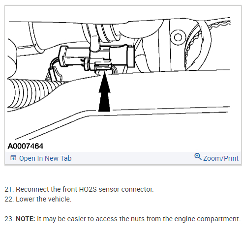

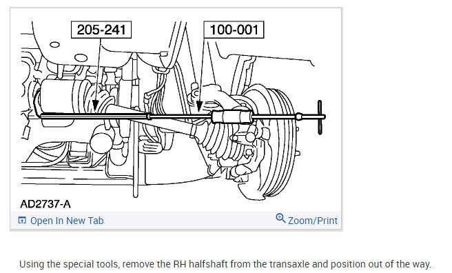

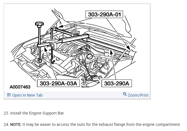

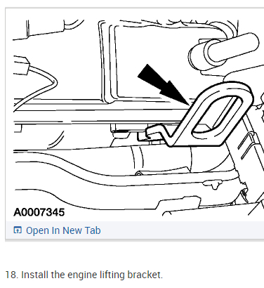

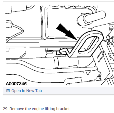

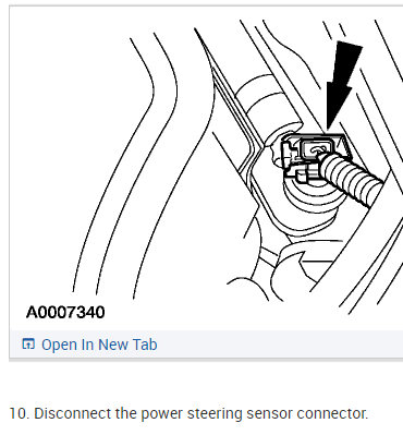

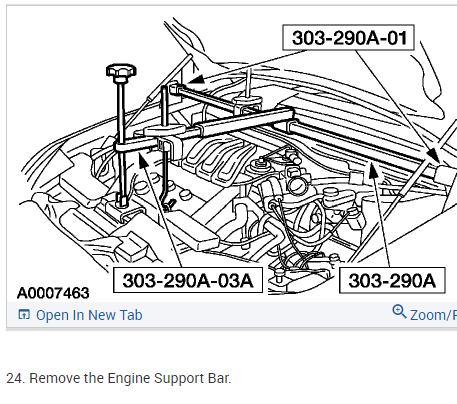

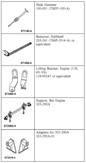

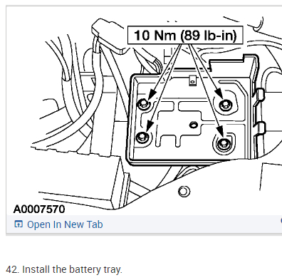

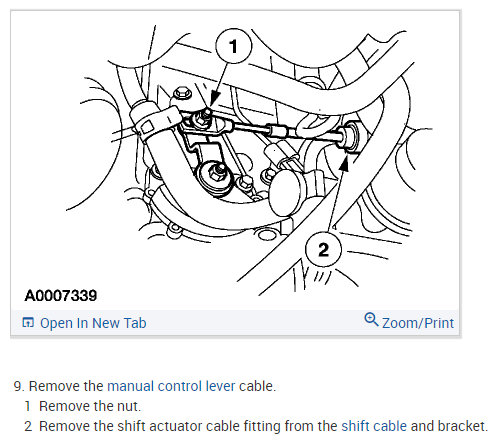

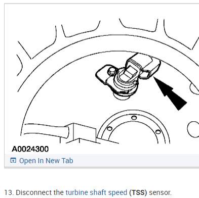

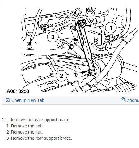

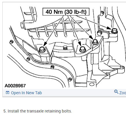

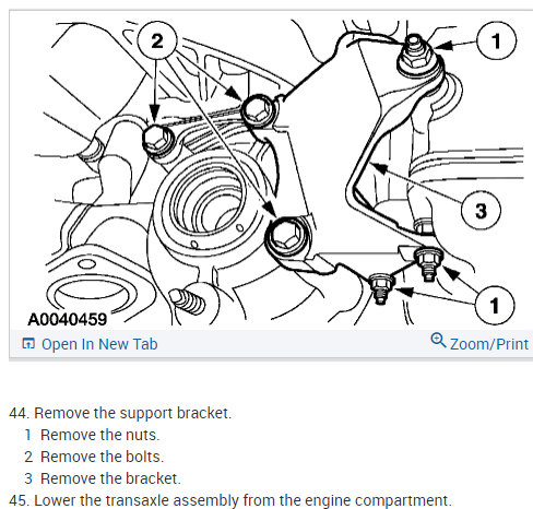

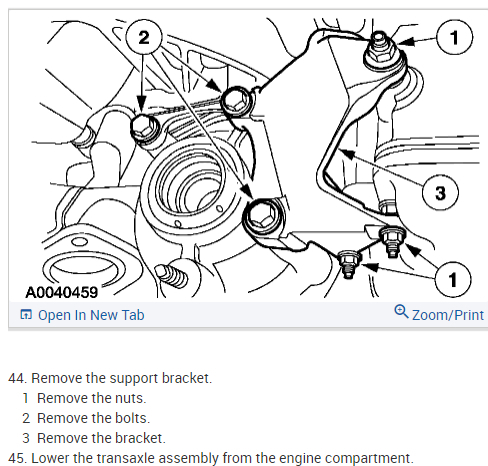

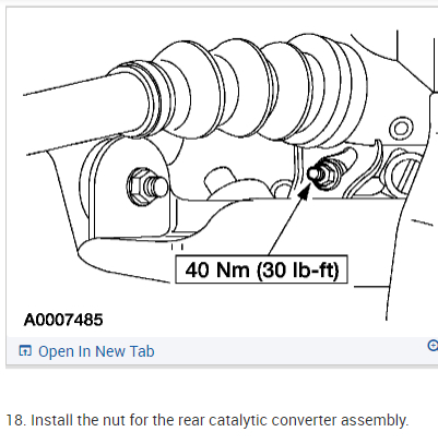

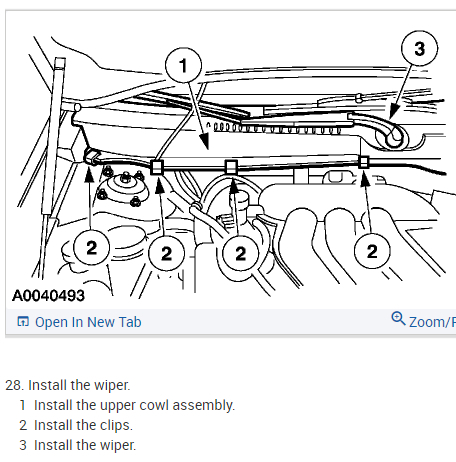

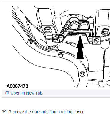

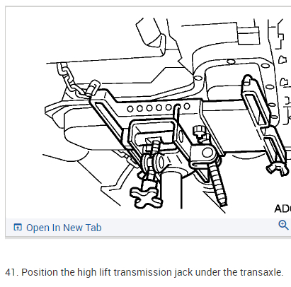

Here is the information you requested. I will have to send you 2 posts due to the sheer number of picture steps. This is page 1. Here is a tutorial for you to view showing how to remove a manual transmission which is similar.
https://www.2carpros.com/articles/transmission-replacement-removal-manual
I've attached picture steps below showing how to remove the automatic transaxle on your car. Hope this helps and thanks for using 2CarPros.
Apr 14, 2021 at 4:11 AM
DANNY L
  • 5,648 POSTS

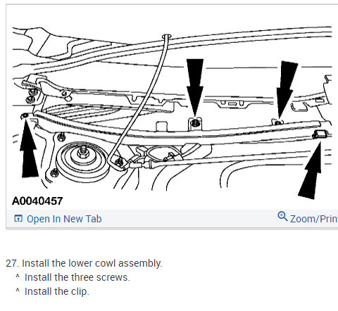

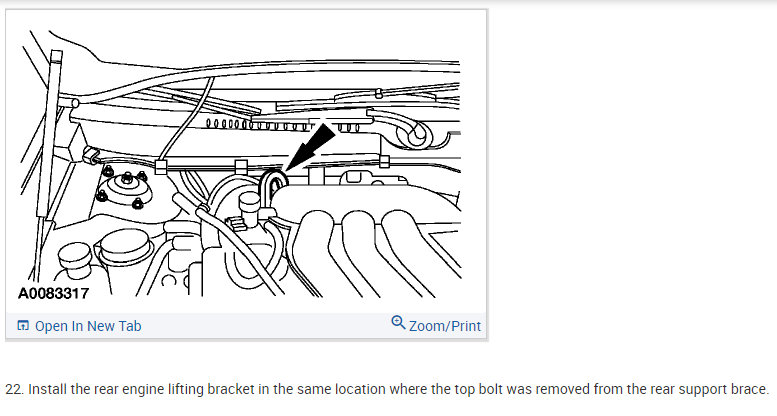

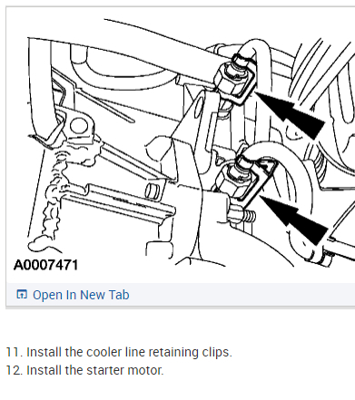

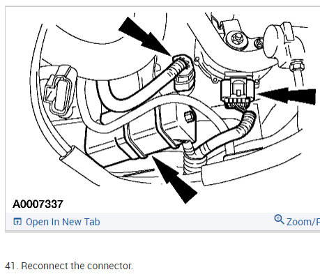

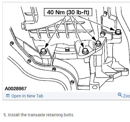

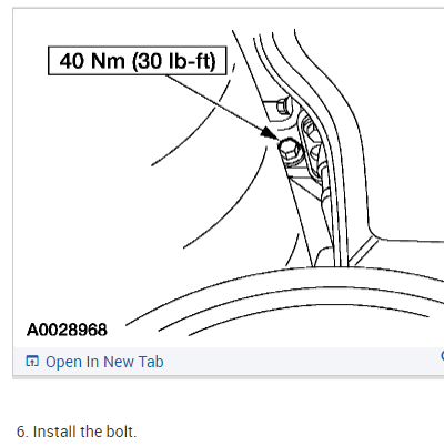

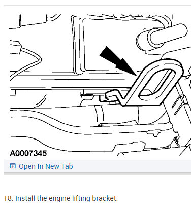

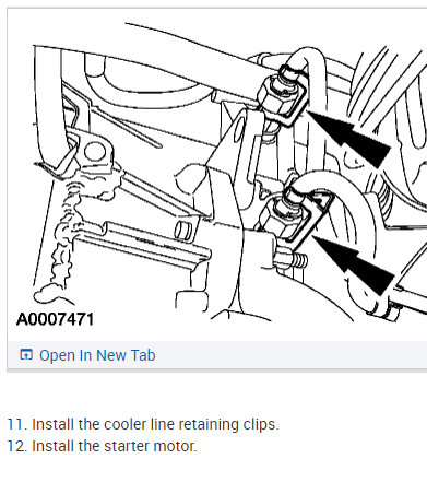

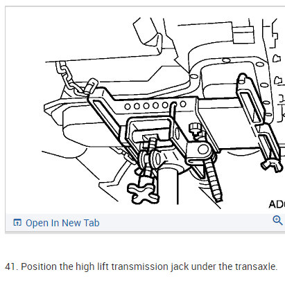

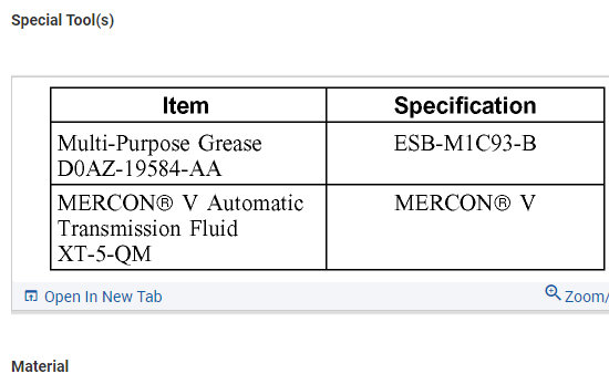

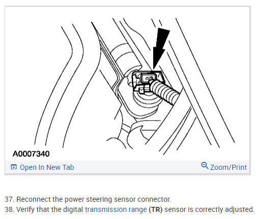

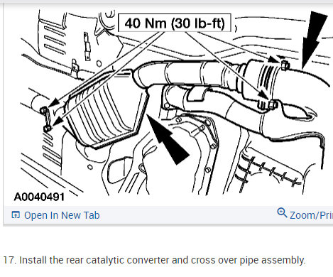

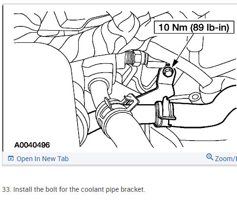

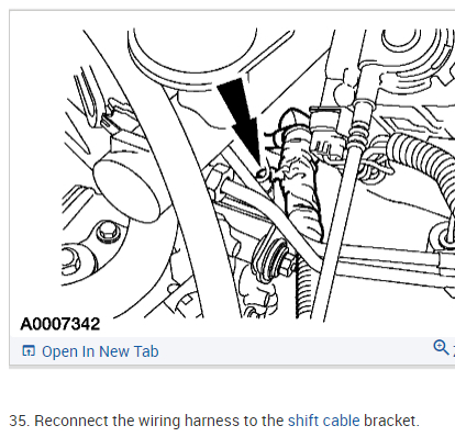

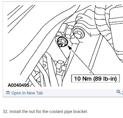

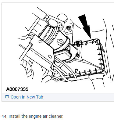

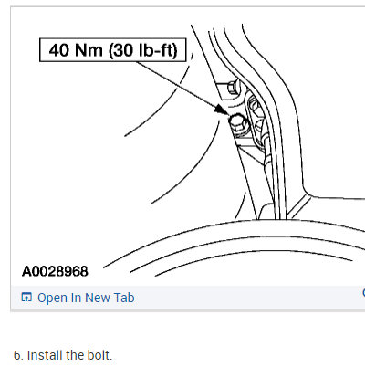

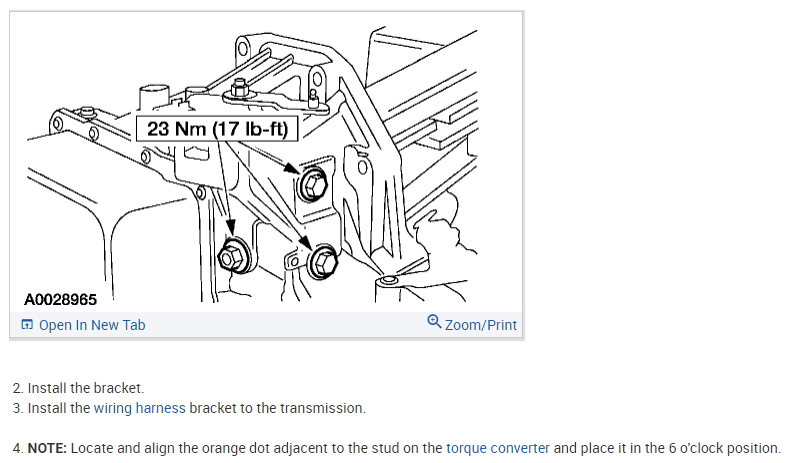

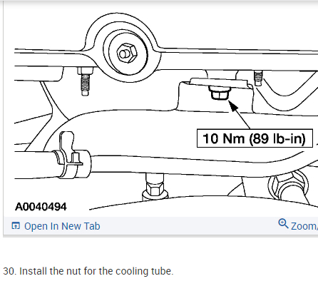

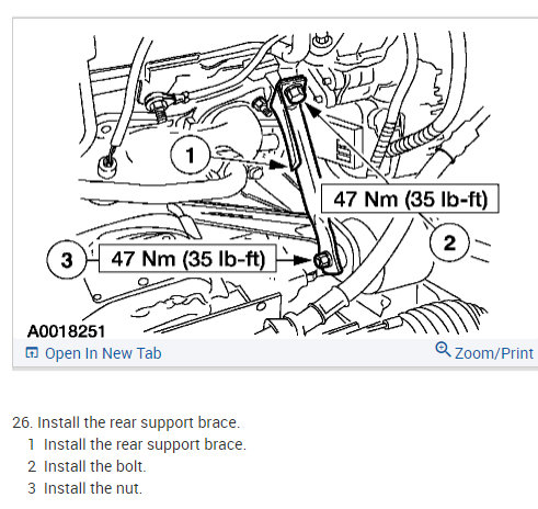

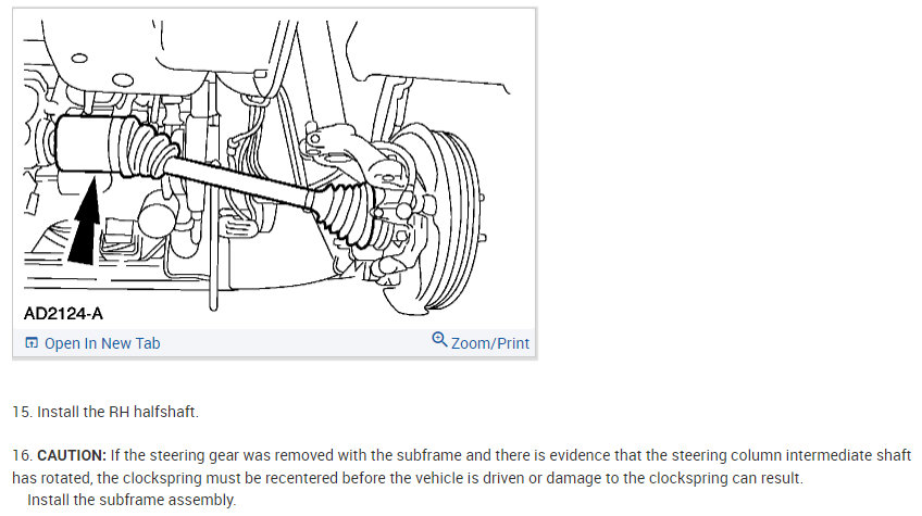

Hello, I'm Danny.

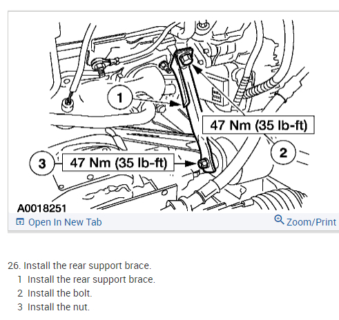

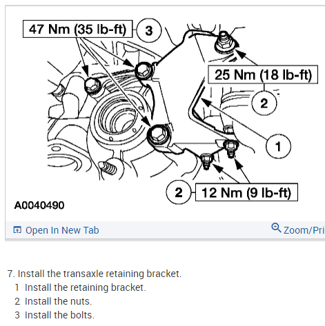

Here is the information you requested. I will have to send you 2 posts due to the sheer number of picture steps. This is page 2. I've attached picture steps below showing how to install the automatic transaxle on your car. Hope this helps and thanks again for using 2CarPros.
