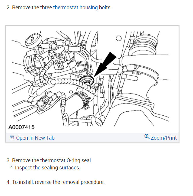

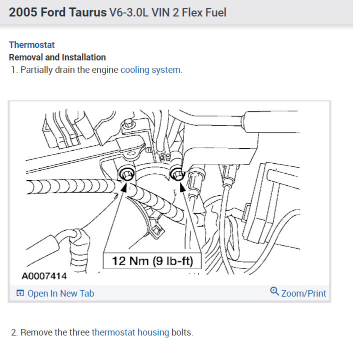

Drain the coolant until the level of the coolant is below the level of the thermostat.
Raise the vehicle and support it with jackstands.
Disconnect the lower radiator hose from the water inlet connection.
Unfasten the two water inlet connection retaining bolts and remove the water inlet connection.
Remove the O-ring seal and thermostat from the water inlet connection. Inspect the O-ring for damage and replace as necessary.
To install:
Clean the water inlet connection mating surfaces.
Install the O-ring, thermostat and the water inlet connection. Refer to the accompanying illustration If you can-t remember how the O-ring and thermostat are positioned.
Install the water inlet connection assembly retainers and tighten them to 71-106 inch lbs. (8-12 Nm).
Connect the lower radiator hose to the water inlet connection.
Fill the engine with coolant, start the engine and check for leaks.
Stop the engine and top off the coolant recovery reservoir as necessary.
