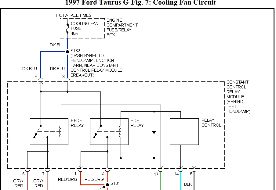

WRENCHTECH
  • 20,761 POSTS
This car has a 2 speed fan system and the 2 speeds are controlled by separate relays so chances are slim that a relay is the problem however they are both powered by the same fuse. The location is shown in the diagram. If you do find the fuse blown, it could be an indication of an overload problem from the fan motor itself.
https://www.2carpros.com/forum/automotive_pictures/561653_Relays_99_Taurus_1.jpg

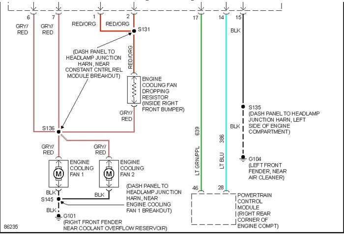

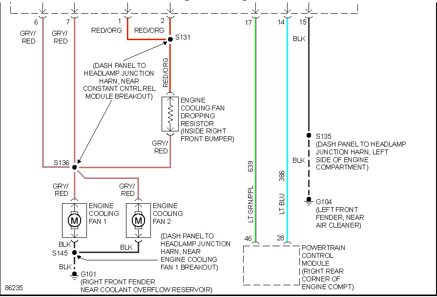

Any applicable trouble codes? I'll post the wiring diagram for fan.
Aug 24, 2020 at 10:50 AM (Merged)
JDL
  • 16,098 POSTS
taurus fan one.
