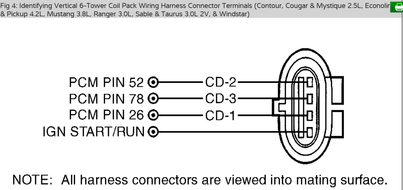

My next plan was to put a multimeter to the wires from the PCM connector (pin 78,connector c175 for ignition coil c) to pin 2 on the coil pack plug C1065. Not sure if I am interpreting the schematic correctly. I assumed I should get direct continuity between:
Using a fluke multimeter---
C175 pin 26 to c1065 pin 3
C175 pin 52 to c1065 pin 1
C175 pin 78 to c1065 pin 2
Not sure if I even have the right schematic because I get:
C175 pins 78 and 52, Continuity to pin 4 (hot wire)
C175 pin 26 "sketchy?" continuity to pin 4?
I am at a loss. Please help

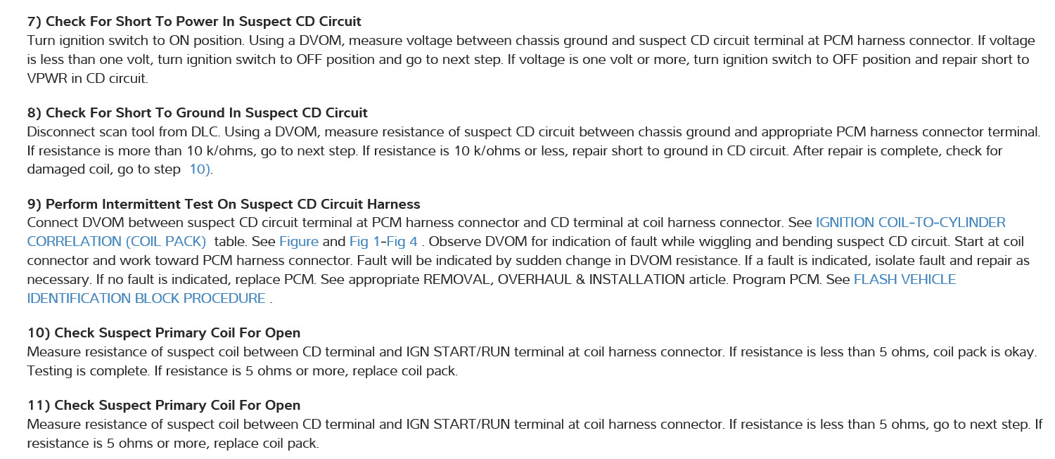

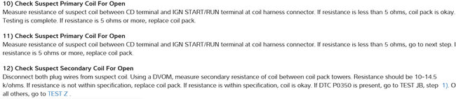

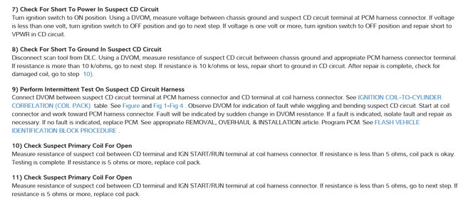

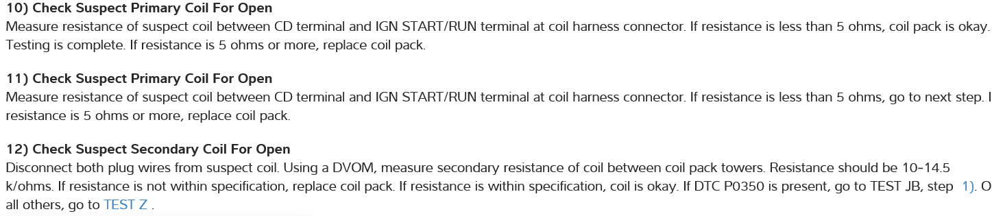

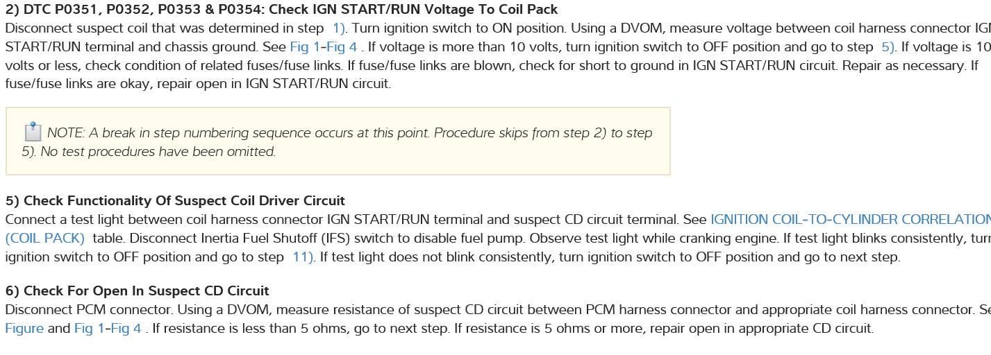

see pictures for how to check this, it is PCM pin 78 on your car. it may be a bad PCM which if replaced will have to have security programmed to your car or it wont start or run. a mechanic at a garage can do it not an auto parts scanner.
