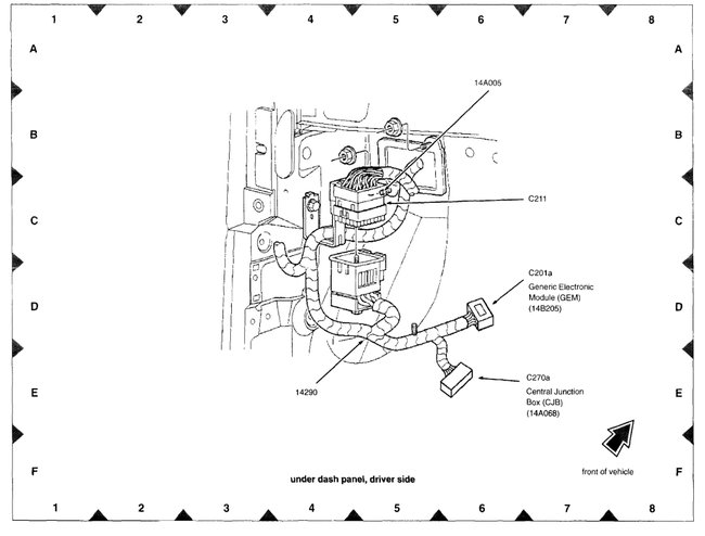

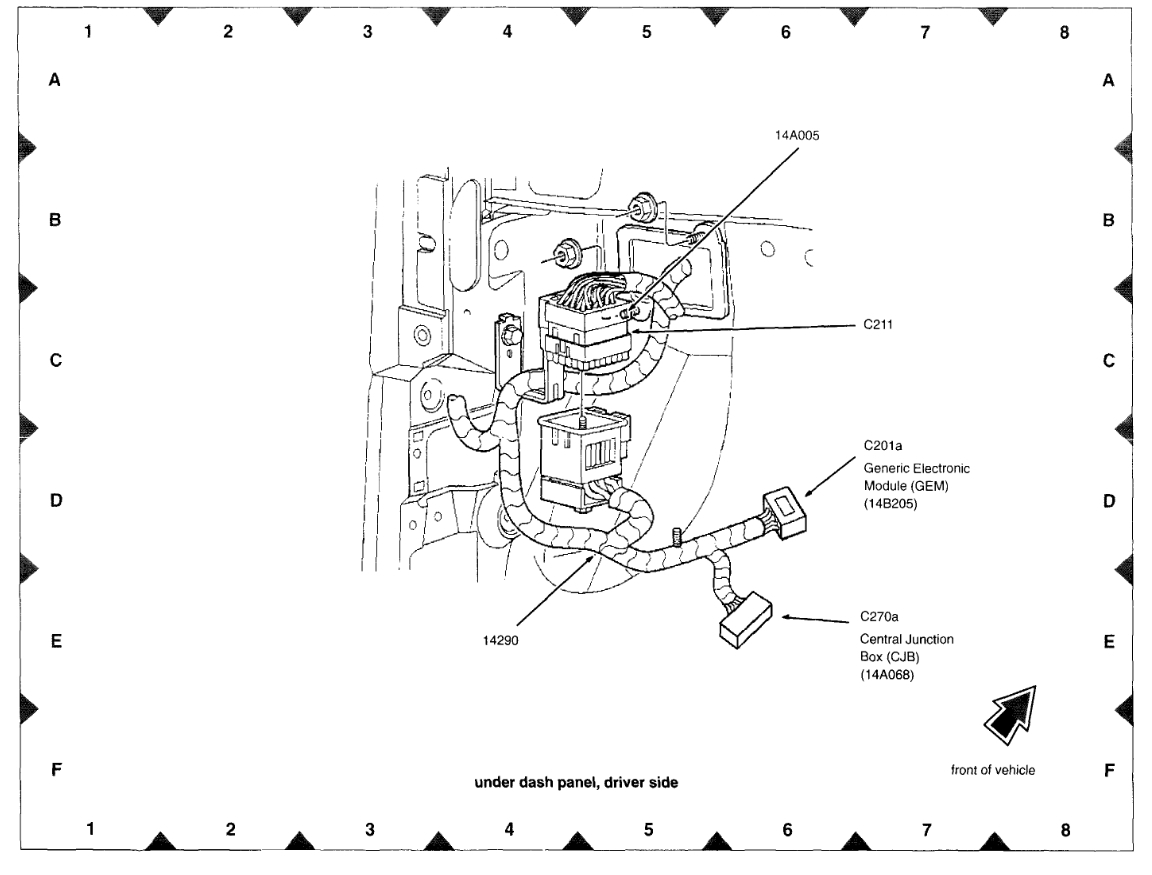

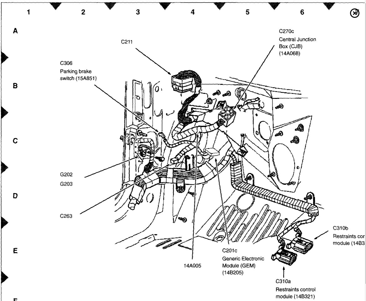

This all what this car have for modules and its locations
Generic Electronic Module (GEM) Under left side of dash.
Powertrain Control Module (PCM) Right rear corner of engine compartment, mounted in firewall.
Here is a diagram so you can see what I am taking about
