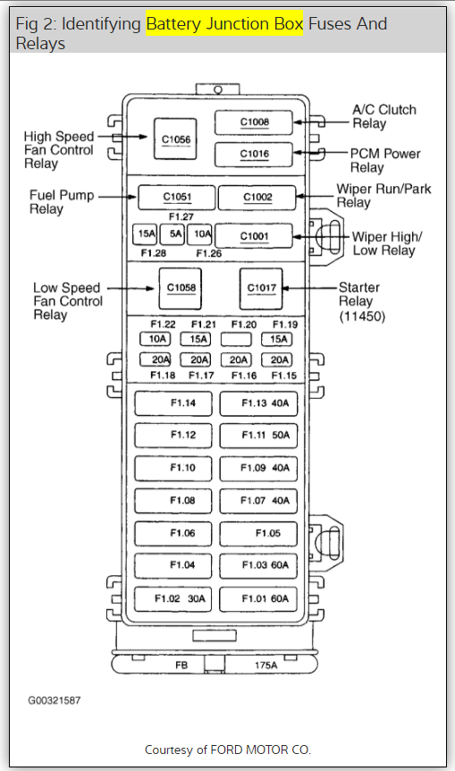

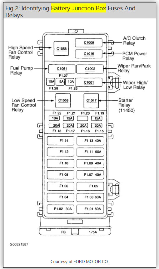

The relay is in the diagrams below

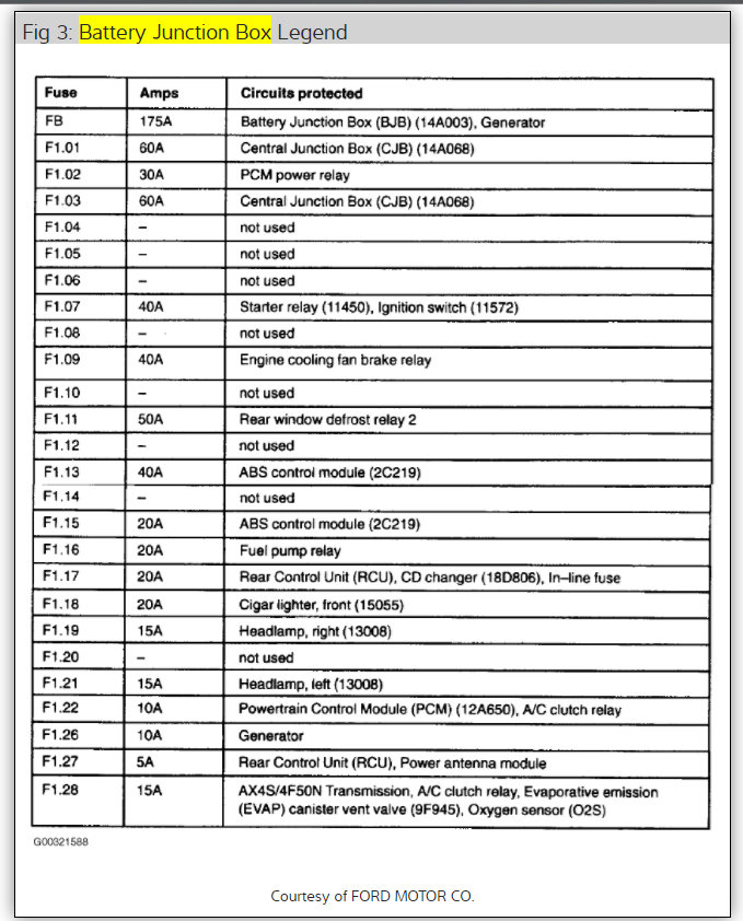

DWZG4
Electrical problem
2001 Ford Taurus 6 cyl Two Wheel Drive Automatic
Which relay/fuse controls the gas pump?
May 20, 2020 at 12:58 PM (Merged)
ZACKMAN
  • 4,202 POSTS
Inertia Fuel Shut Off switch will be either in cargo area behind right rear wheel well or on left "B" pillar (depending on model and engine). If tripped, switch has to be manually re-set.
Battery junction box behind radiator
Fuse #116 20A
Fuse #102 30A
Fuel Pump relay
USMC121786
Electrical problem
2001 Ford Taurus 6 cyl Front Wheel Drive Automatic
is there a way for me to find out if my fuel pump relay needs to be replaced without taken it to the local auto shop? my car doesn't want to start. it has a new battery, the starter is good as-well. the car cranks but doesn't turn over. when i place the key in the on position i do not hear the fuel pump turn on. i was told it may just be the relay, and once thats ruled out more than likely it would be my fuel pump
MHPAUTOS
  • 31,937 POSTS
Hi there,
First check the fuel pump fuse in the fuse box and the relay is in the battery junction box under the bonnet next to the battery, if these are ok, i would be suspecting a pump failure.
mark (mhpautos)
