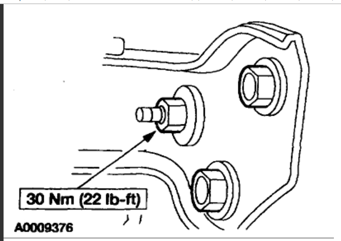

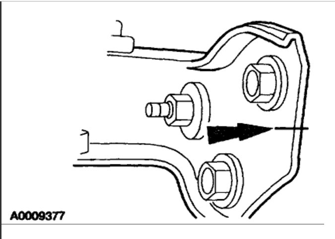

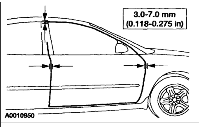

Use a wrench and unbolt the door from the car body. This job is much easier if you have someone who can hold up on the door while you loosen the hinges. Most hinges have three or four bolts, and most doors have two hinges. Keep track of these bolts. They should all be alike, but if there are differences, mark where each bolt should be returned when putting the new door in place. Once the bolts are all out, remove the door and install new. Be sure to align the door properly once bolted back on.

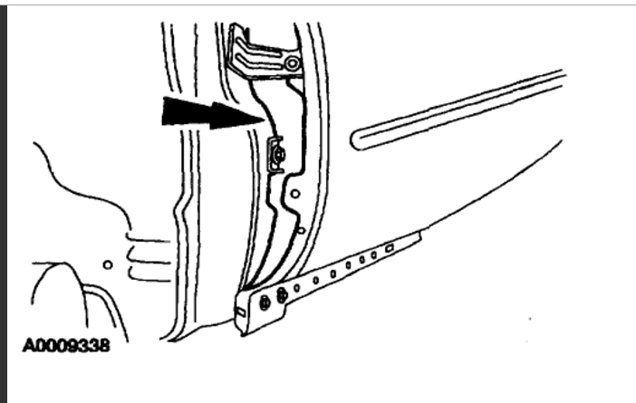

Here are some diagrams (below) that will help you get the job done.
