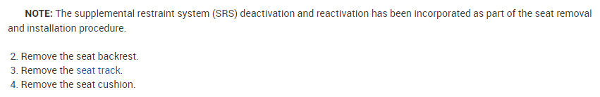

I would like to know how to replace the front seat?

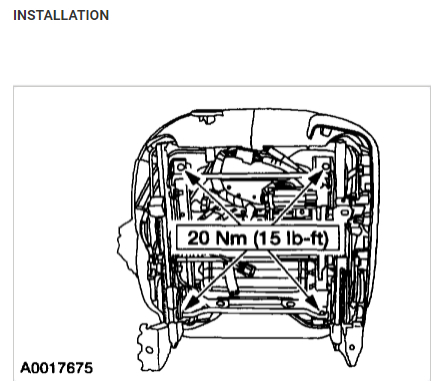

Hello, I'm Danny.

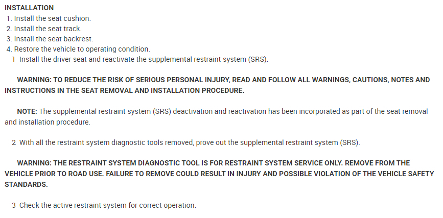

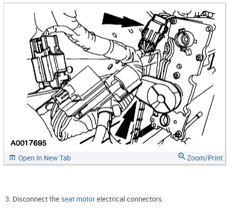

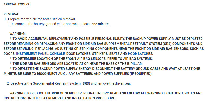

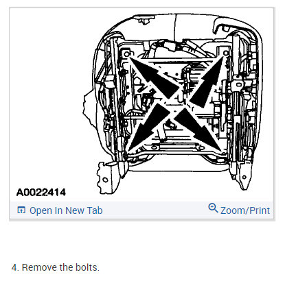

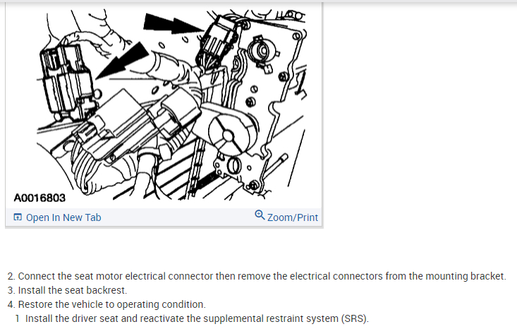

Here is the information you requested. I've attached picture steps below on how to remove and replace the front power seat on your Taurus. Hope this helps and thanks for using 2CarPros.
