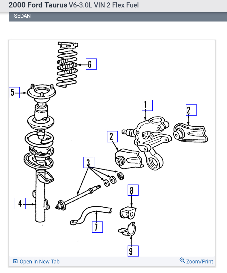

Not too much else you can do it the way the car is designed. Here is a diagrams of the rear suspension. The only thing I can think of is maybe someone makes a helper spring or air strut for it.
