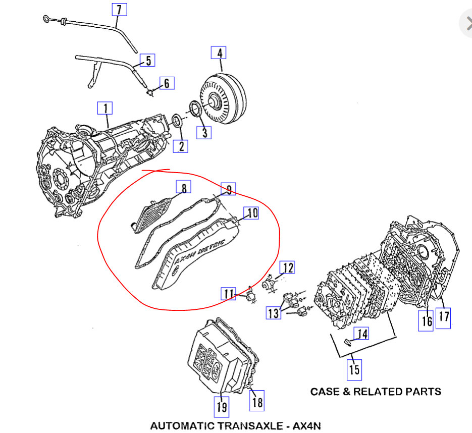

If you can see the leak is from the pan, then you will have to change the transmission pan gasket. Leaking gasket is a very common issue with engine or transmission.
Before removing the pan you will have to drain all the transmission fluid out.
It's also a good idea to change the transmission filter while you are at it.
Also be sure to clean off any residue of the old gasket before installing the new gasket.
Here is a transmission service video for your reference:
https://youtu.be/OSRkzuX20o8
Those pan bolt should be torqued at:
Transaxle Pan to Case (Lower Reservoir) 80 - 106 in.lb
