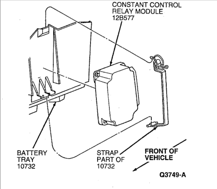

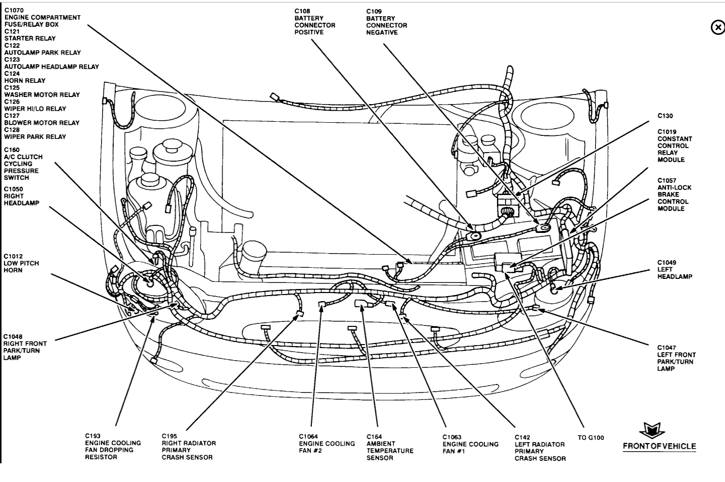

The fuel pump relay is incorporated in the constant control relay module located next to the battery. I would recommend spending the extra money and purchasing it from the dealer instead of the local auto parts store as I learned the hard way.
HEre are some guides to help you test it.
and
Here is its location (below)

Hi mr.smith_5, Welcome to 2carpros and TY for the donation Dunno what liter engine but am using a 3.0 liter-the fuel pump relay is integrated with the constant control relay module-see below for location
https://www.2carpros.com/forum/automotive_pictures/12900_ccrm_1.gif
Disconnect battery ground cable, then remove radiator sight shield. Disconnect electrical connector, then remove module from radiator support. Reverse procedure to install.

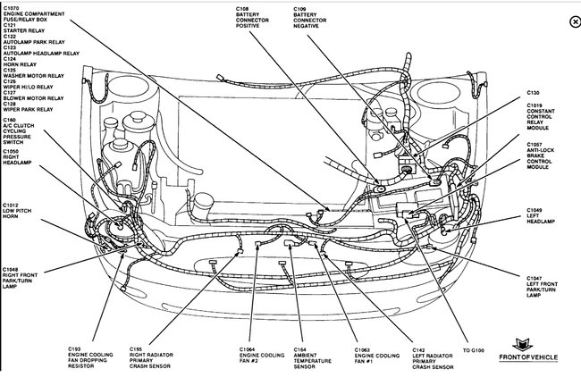

https://www.2carpros.com/forum/automotive_pictures/12900_fprf_2.jpg
The Fuel Pump Relay is part of the Integrated Control Relay Module, is located at the front of the engine compartment, on the upper radiator support. https://www.2carpros.com/kpages/auto_repair_manuals_alldata.htm
