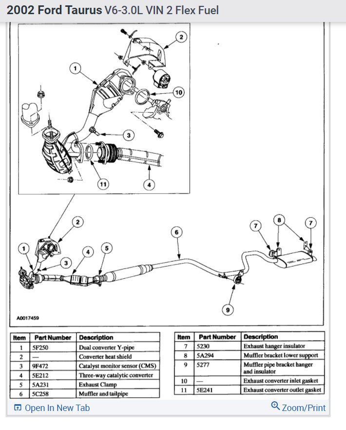

My car keeps not wanting to go into first gear. It gets to 20 mph and instead of shifting from there it likes to sit and idle, I push the pedal all the way down and it eventually jerks and goes into gear. I took it to a friend of mine and he ran a scan on it and it said that it was the catalytic converter. That was all that the scan said, but he wasn't sure if that was the real problem.
