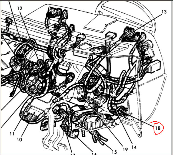

No, the right turn signal does not work at all - its completely dead compared to the left one that wont STOP flashing (I had to remove the left bulb in front & back - I should also mention that the left indicator on the inside of the car continues to flash!).
And the answer to your next question is yes, the bulbs flash front & rear on the left side (obviously not now since I have removed both front & rear bulbs on the left side).
You mentioned a broken turn signal switch - I should also let you know that we just replaced that not even 3 weeks prior to this incident w/ the signals..it was the "Combination Switch" to be exact, & it wasnt because the turn signals werent working, it was because the windshield wipers had stopped working.
I was wondering if its possible that we could have damaged that new switch somehow when we were trying to install the radio & ended up blowing those 3 fuses because the turn signals worked just fine right before we blew those fuses..do you think we could've damaged the entire switch?..

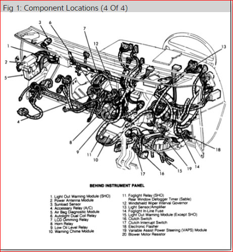

Someone also said something to me about the "flasher" or the "turn signal relay"..but I have no idea where those things are even located in the car much less what they are...
