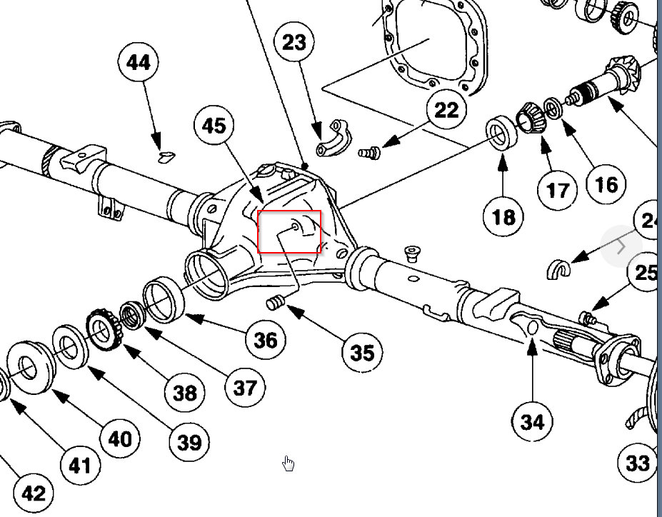

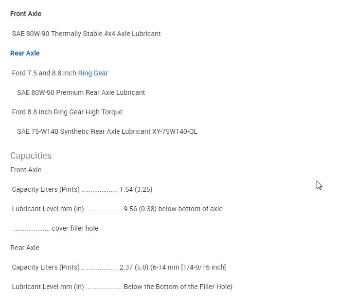

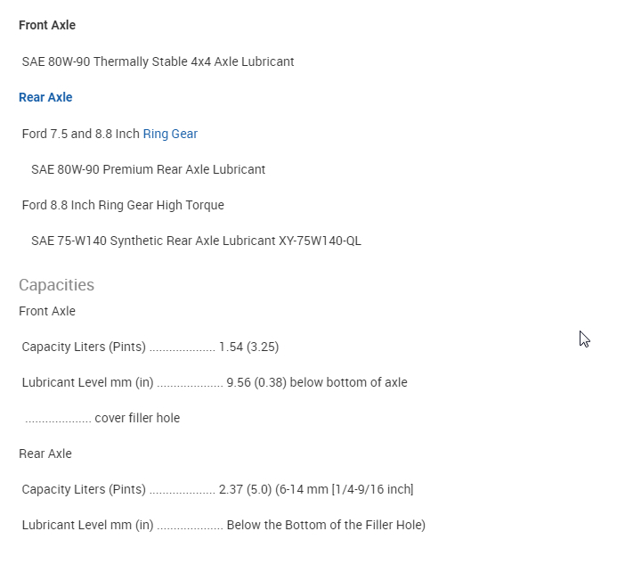

Rear differential leak. I know to use gear grease and a grease gun, but I'm not quite sure where to put it. I'm hoping someone could explain it to me and a picture would be even better. Thanks
