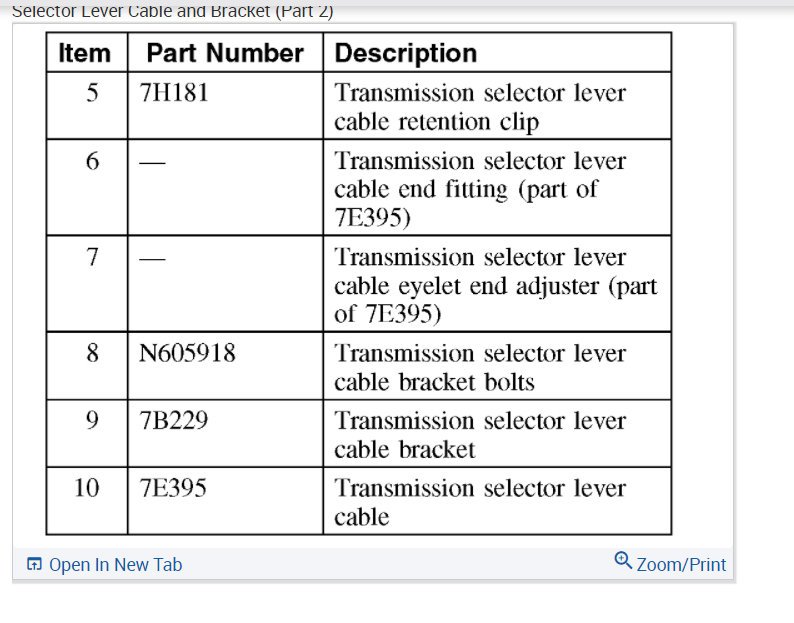

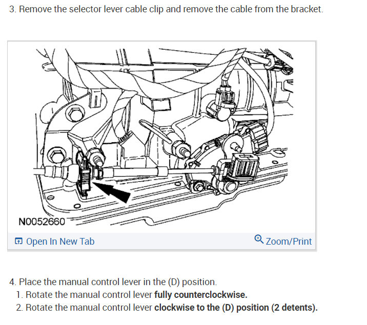

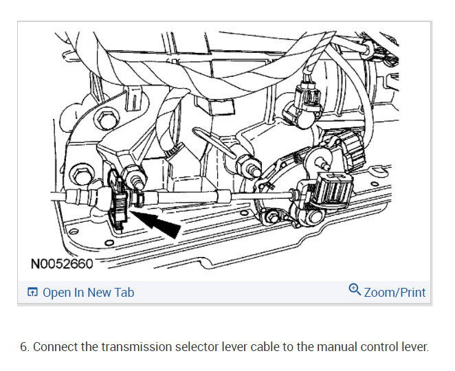

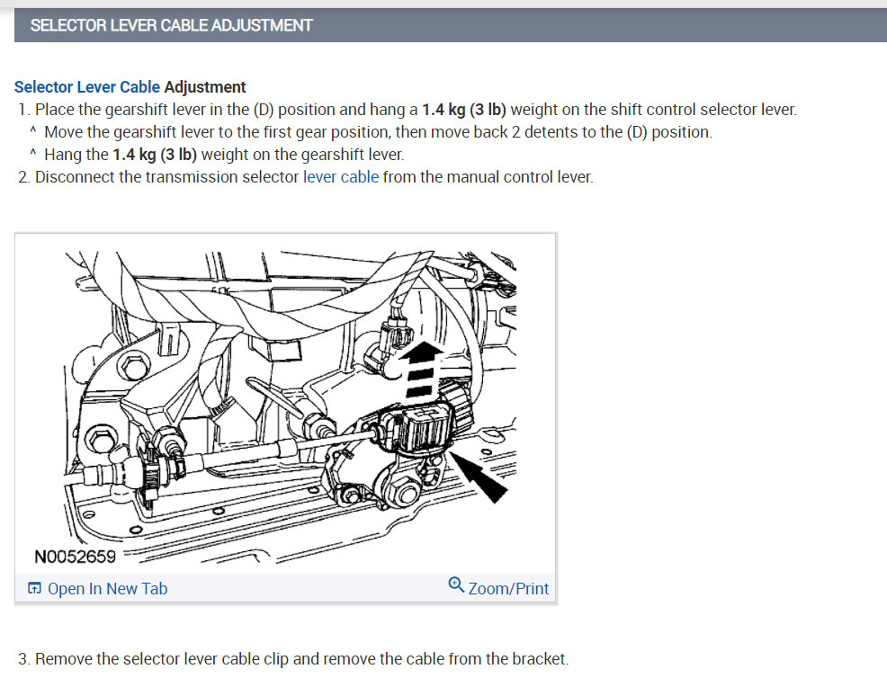

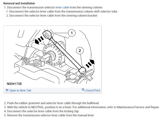

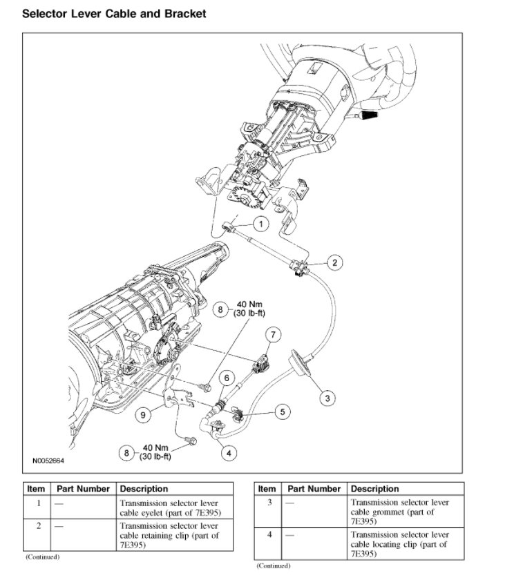

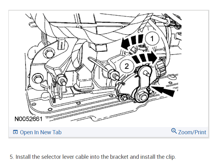

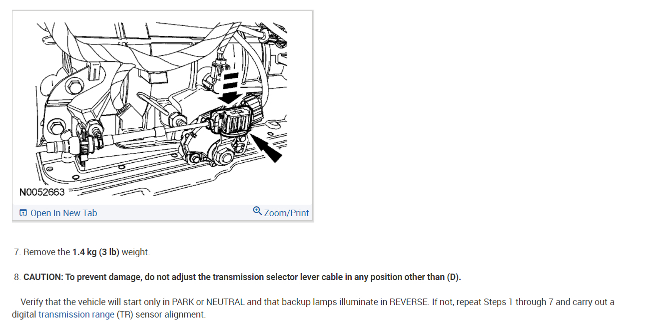

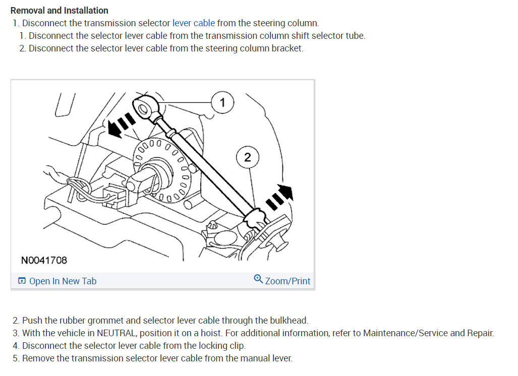

Here is a guide to help you step by step with instructions in the diagrams below to show you how to replace the shifter cable. Check out the diagrams (below). Let us know what happens and please upload pictures or videos of the problem.
