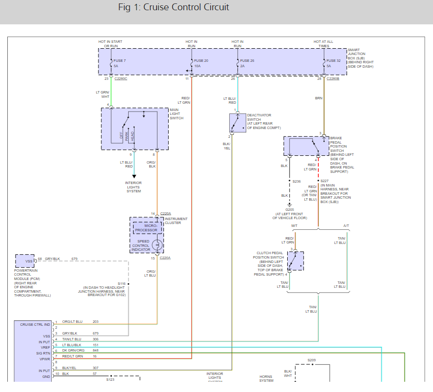

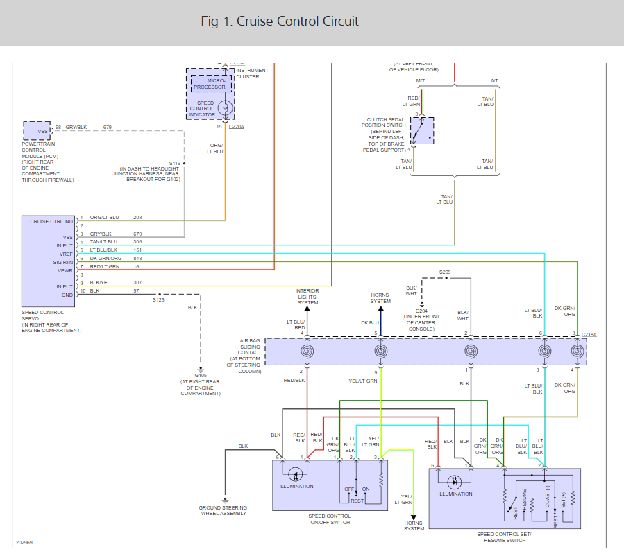

Are the brake lights working? Also, does the cruise control indicator light flash or come on when trying to set speed? Nine times of of ten if the fuses are good and the brake lights are working the problem is in the clock spring of the steering wheel which controls the cruise via the steering wheel. Here is a guide to show you what you are in for when doing the job.
https://www.2carpros.com/articles/steering-wheel-clock-spring-removal
Here is a guide to help you confirm the failure and the cruise control wiring diagrams below so you can see how the system works.
Check out the diagrams (Below). Please let us know what you find.

Yes the brake lights work and no the cruise control indicator light does not light up on the instrument panel when I try to set it.

Yep that is an indication the clock spring has gone bad.

I checked the corresponding cables and everything appears to be working just fine. So I got the clock spring and replaced it (had to remove the steering wheel) cost me $78.00 all fixed!
