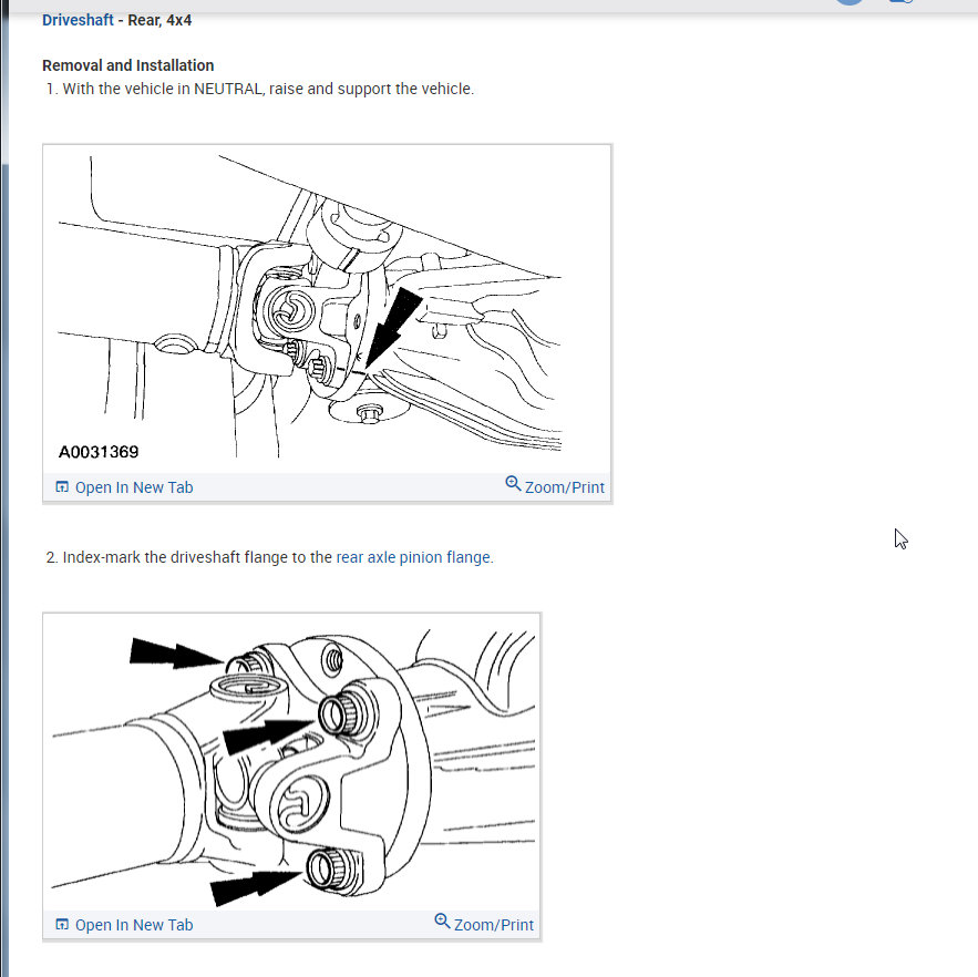

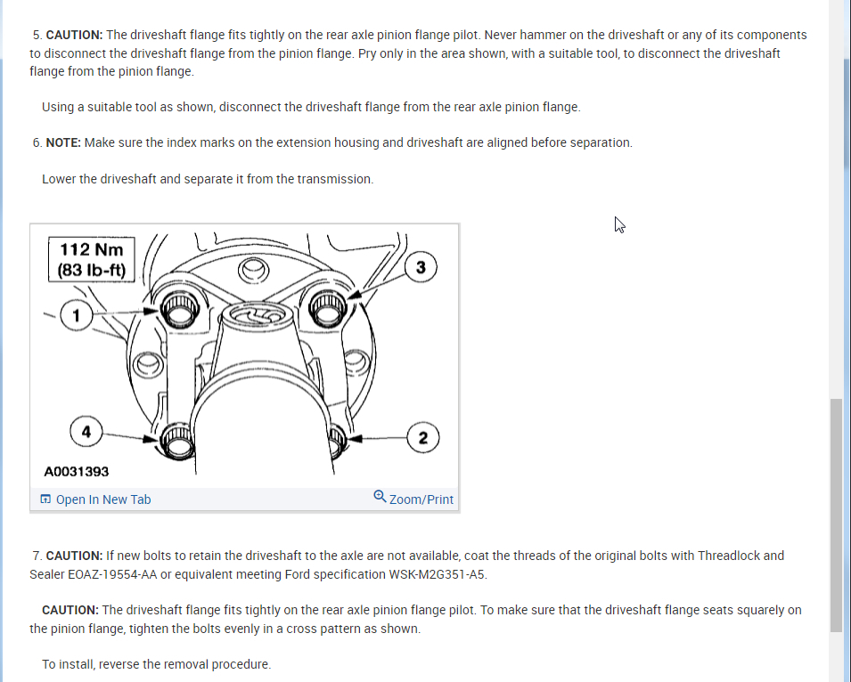

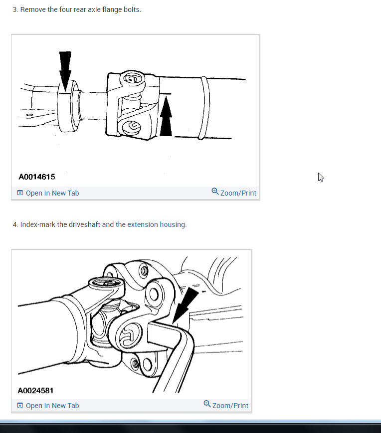

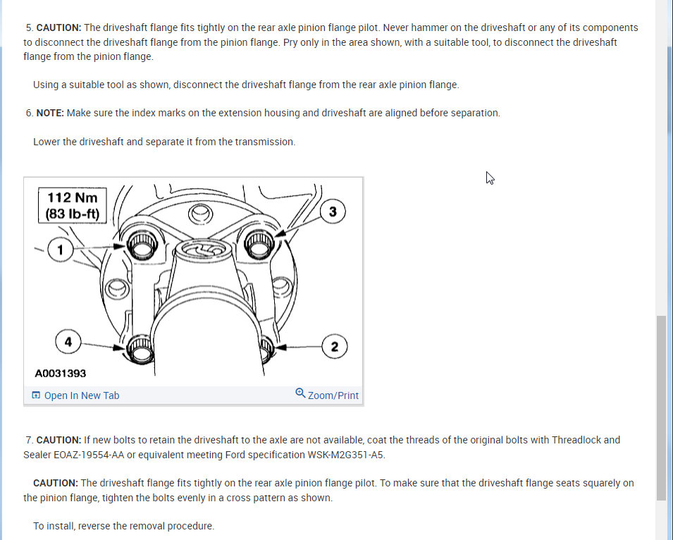

Below is the process from the manual on how to replace it. Please run through this material and let us know if there are questions. Thanks
