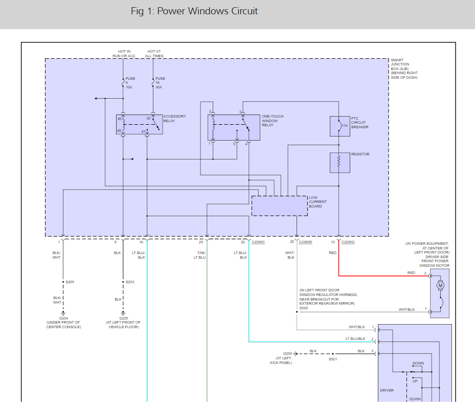

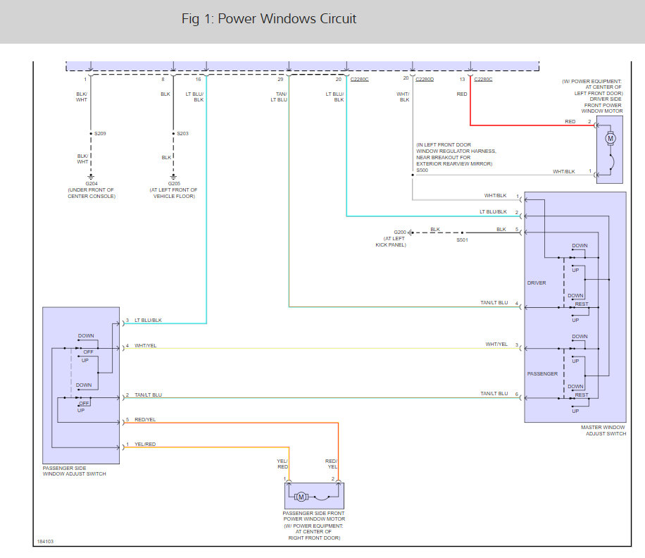

you will have to remove door trim and watershield to inspect motor and windings etc. for cause of the fault ?
