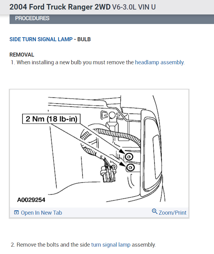

I need to replace the drivers front side marker light bulb, how to you do this?

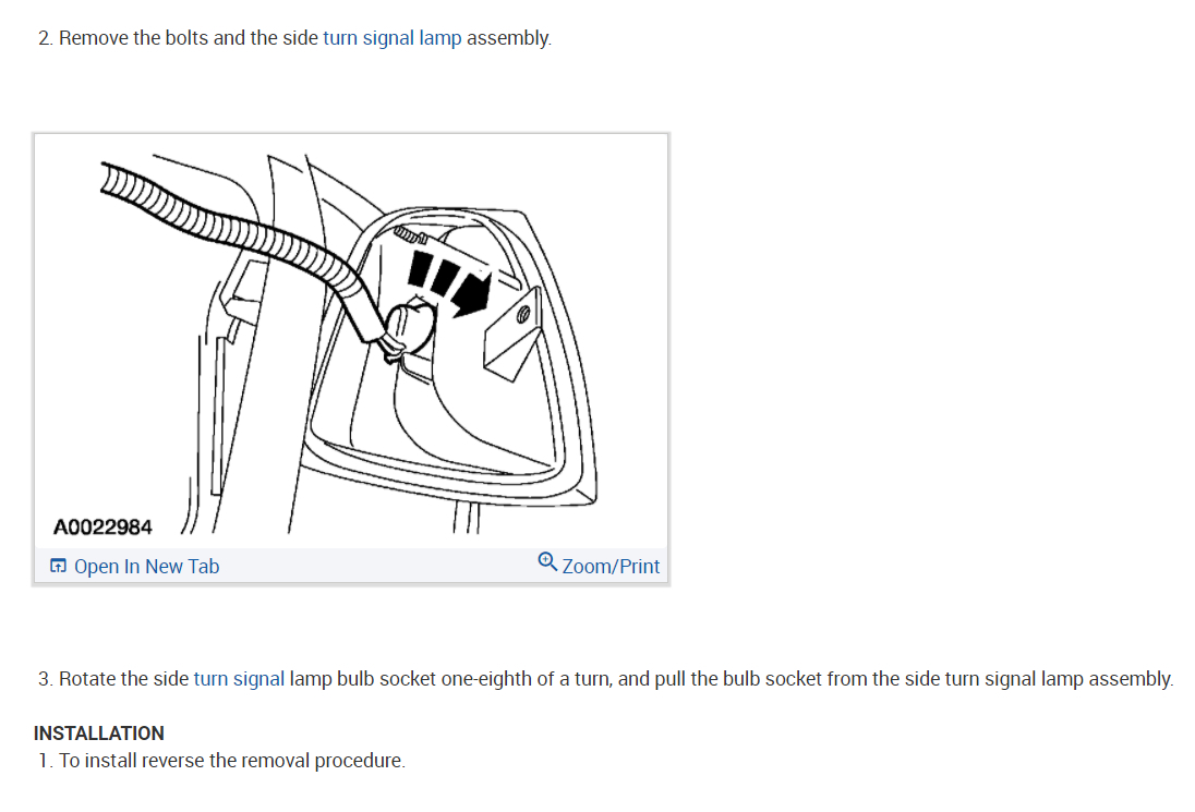

Looks like the headlight has to come out first. There are 2 pins on top of the light housing that you remove and pull the h-light assembly out. This will give you access to the 2 screws that hold the side lamp in. here is the instructions in the diagrams below. Check out the diagrams (Below). Please let us know if you need anything else to get the problem fixed.
