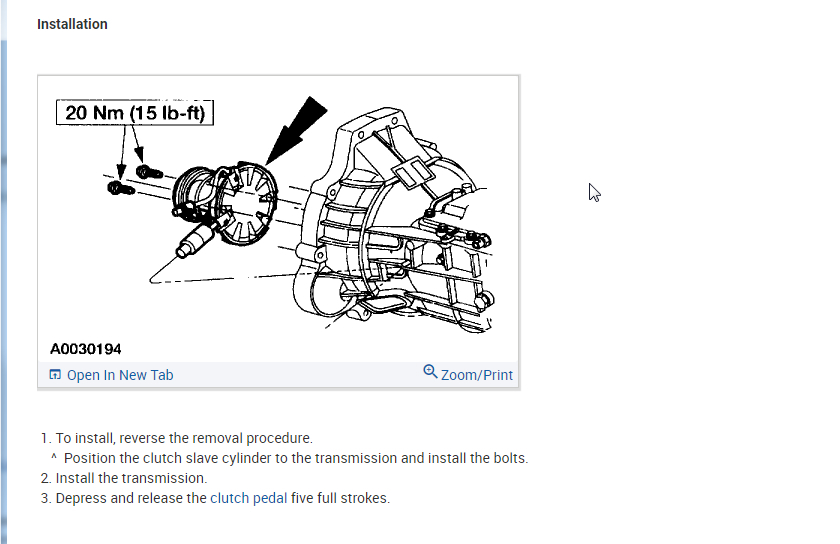

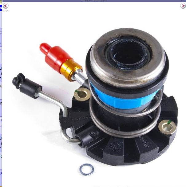

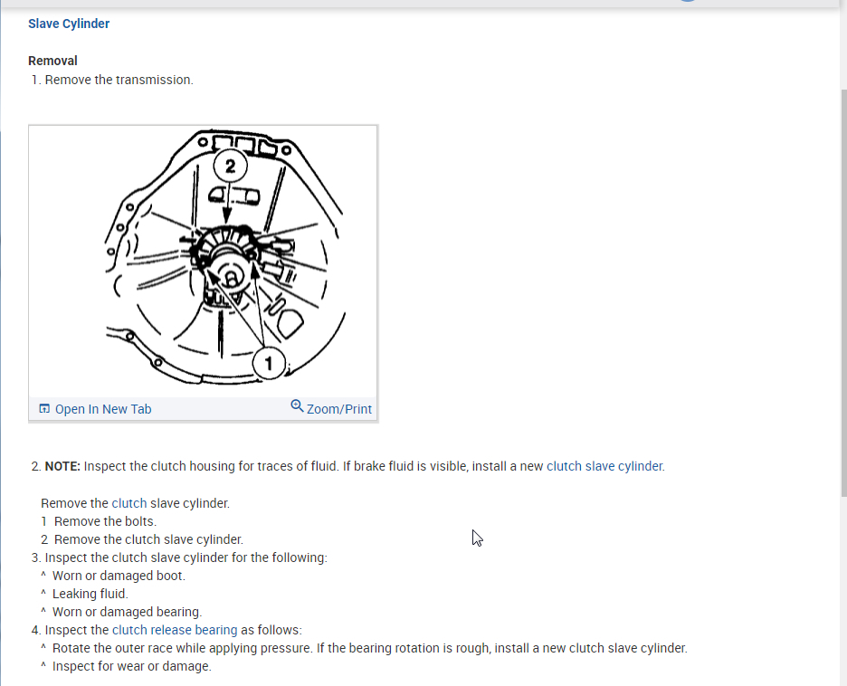

Below is the process on replacing the slave cylinder that talks about this as well.
