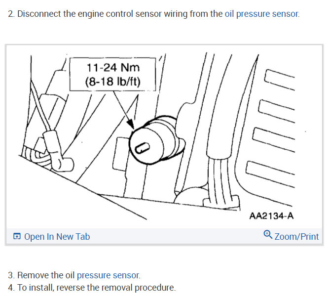

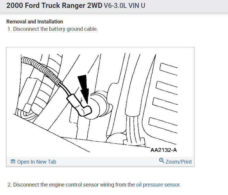

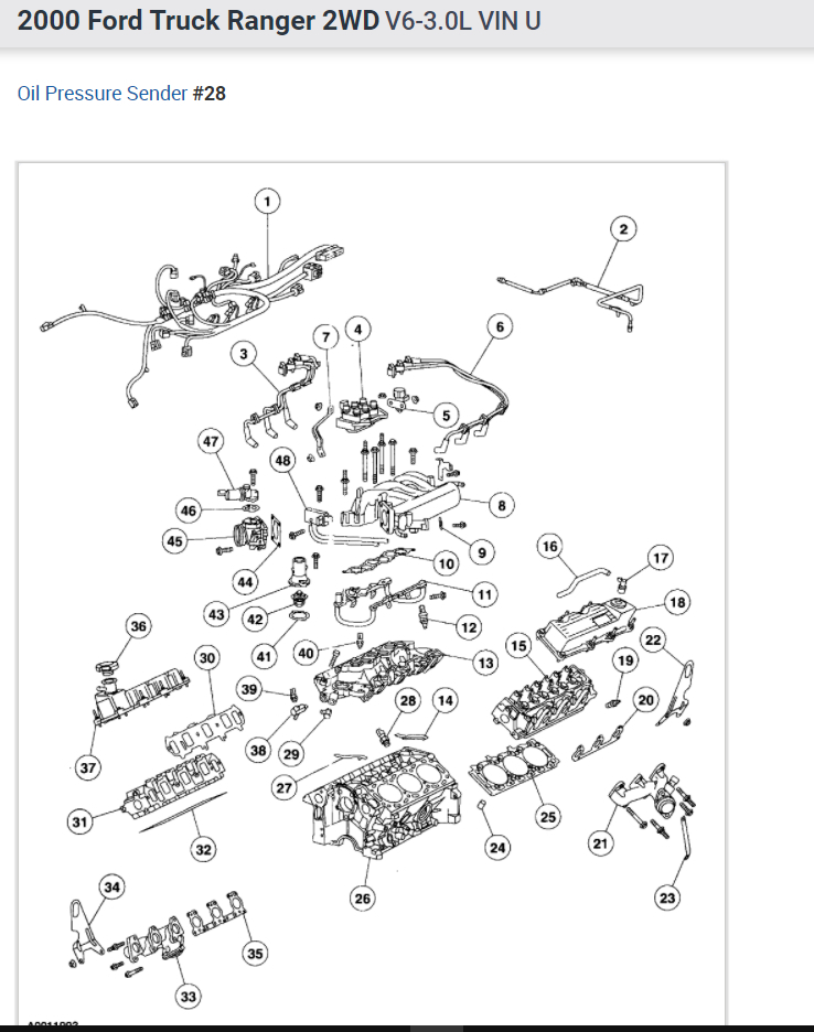

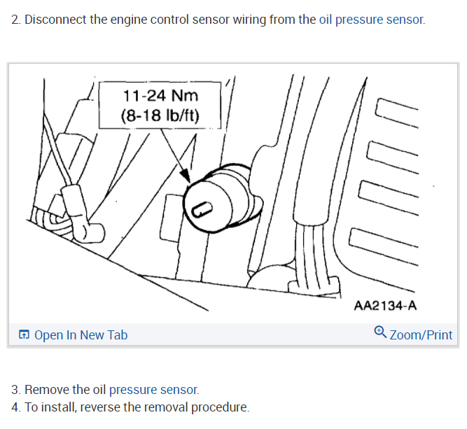

This guide can help as well, and I have included the oil sending unit so you can check the connection or replace the sensor.
https://www.2carpros.com/articles/high-or-low-engine-oil-pressure
Check out the diagrams (Below). Please let us know what happens. Hope this helps and thanks for using 2CarPros.
