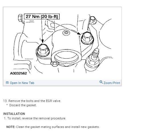

How do I replace the EGR valve on my 2.3L DOHC engine?
Dec 5, 2008 at 8:08 PM
CERTIFIED EXPERT
53,854 POSTS

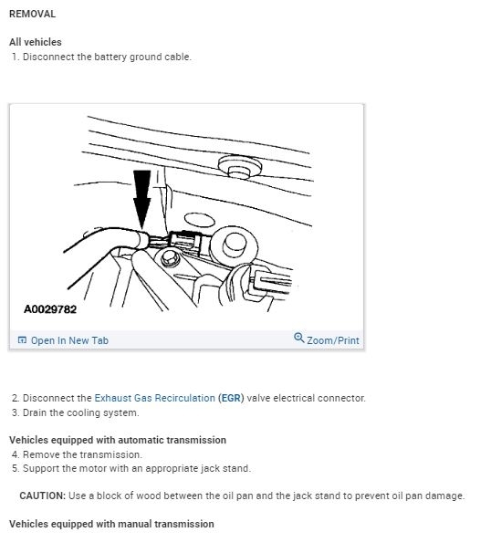

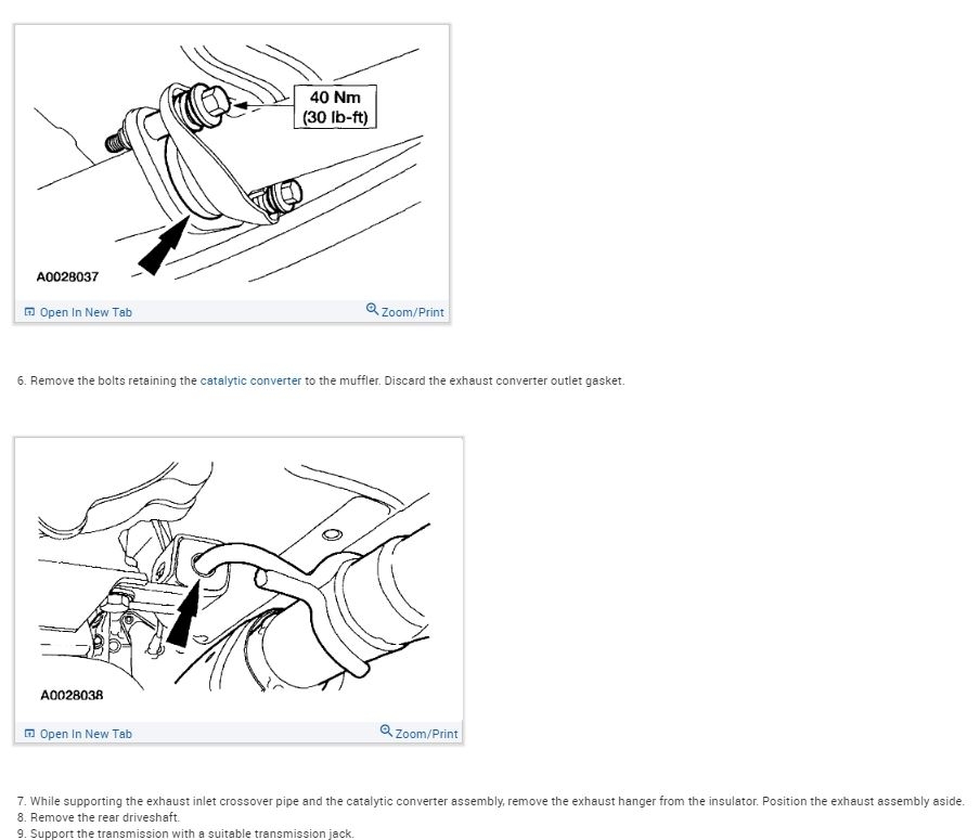

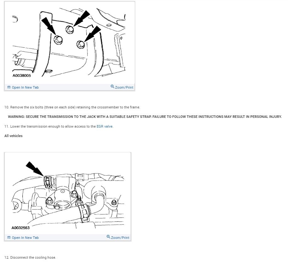

The manuals do not give the exact location, but from what I see it appears to be bolted to the back of the cylinder head.
See the attachments below for instructions on removal and replacement.
Let us know if you need anything else.
