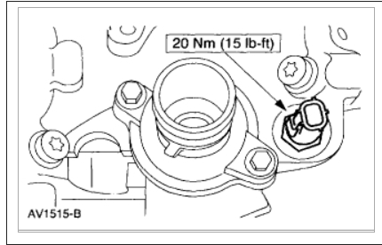

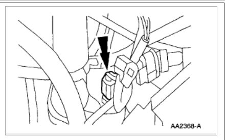

Yes, it sounds like the engine coolant temperature sensor has gone out. Here is a guide to help you see what you are in for when doing the job:
https://www.2carpros.com/articles/coolant-temperature-sensor-cts-replacement
Here is the location for your car next to the thermostat housing.
Check out the diagrams (below).
