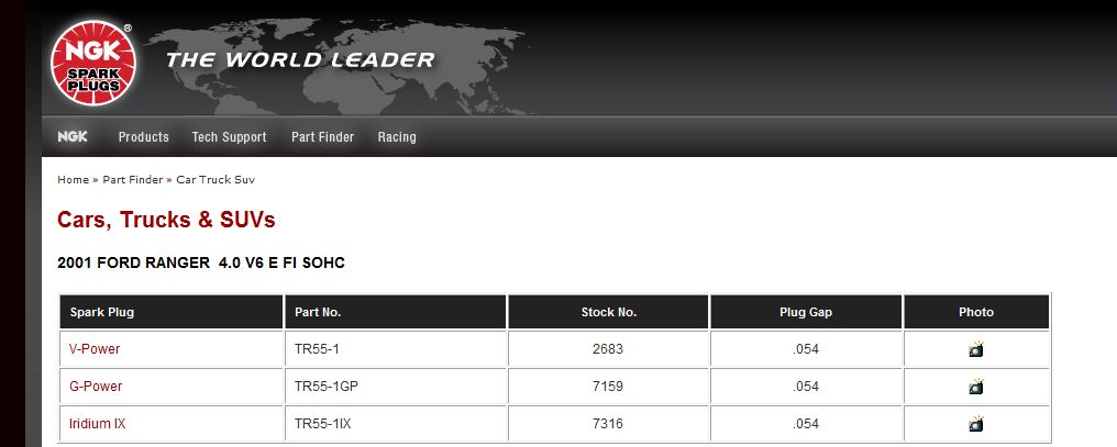

I bought some plugs for my truck and it turned out they were too long when I screwed them in it bent the tips of the plugs and I have read about the ohv and sohc use same plugs but that they don't like eachother so what plugs from napa. Will fit my truck I would like to stay with the brand autolight or ngk thanks
Jan 2, 2019 at 7:54 PM (Merged)
MHPAUTOS
  • 31,937 POSTS
See pic for application chart.
