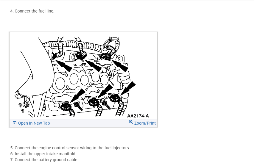

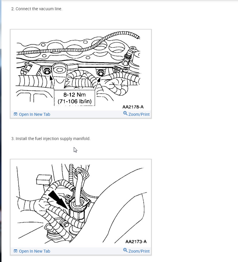

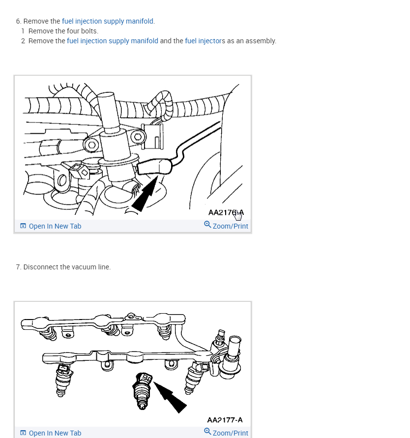

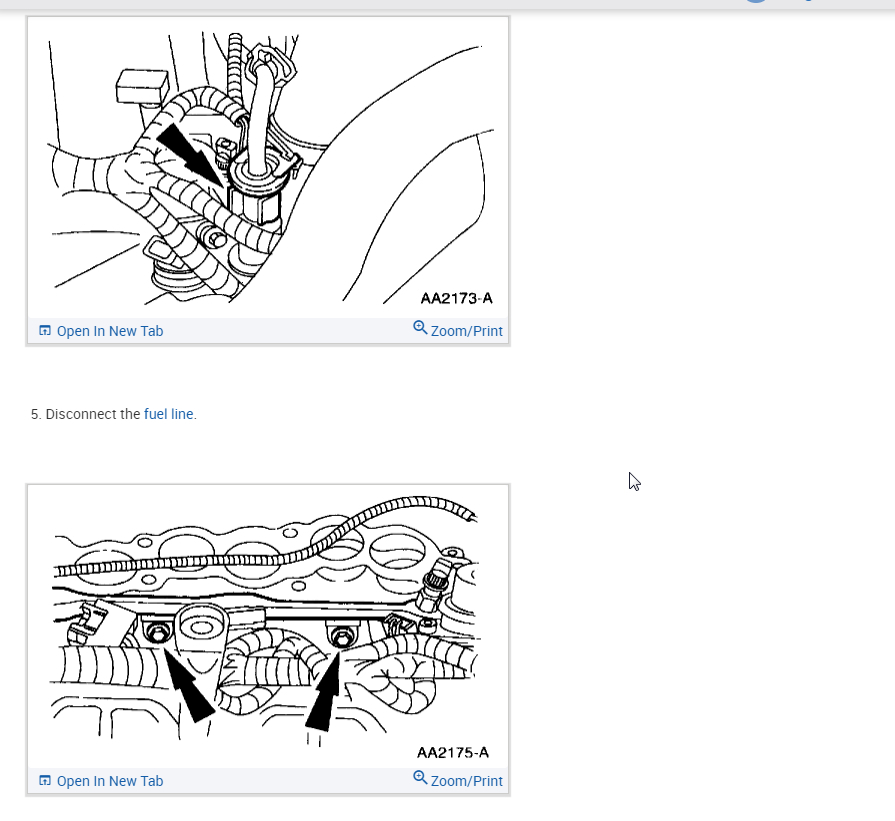

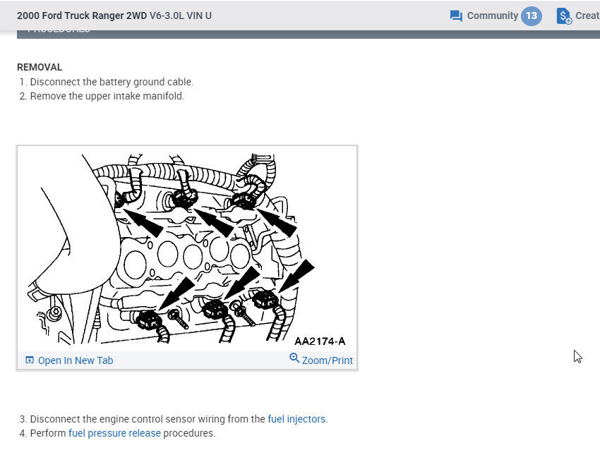

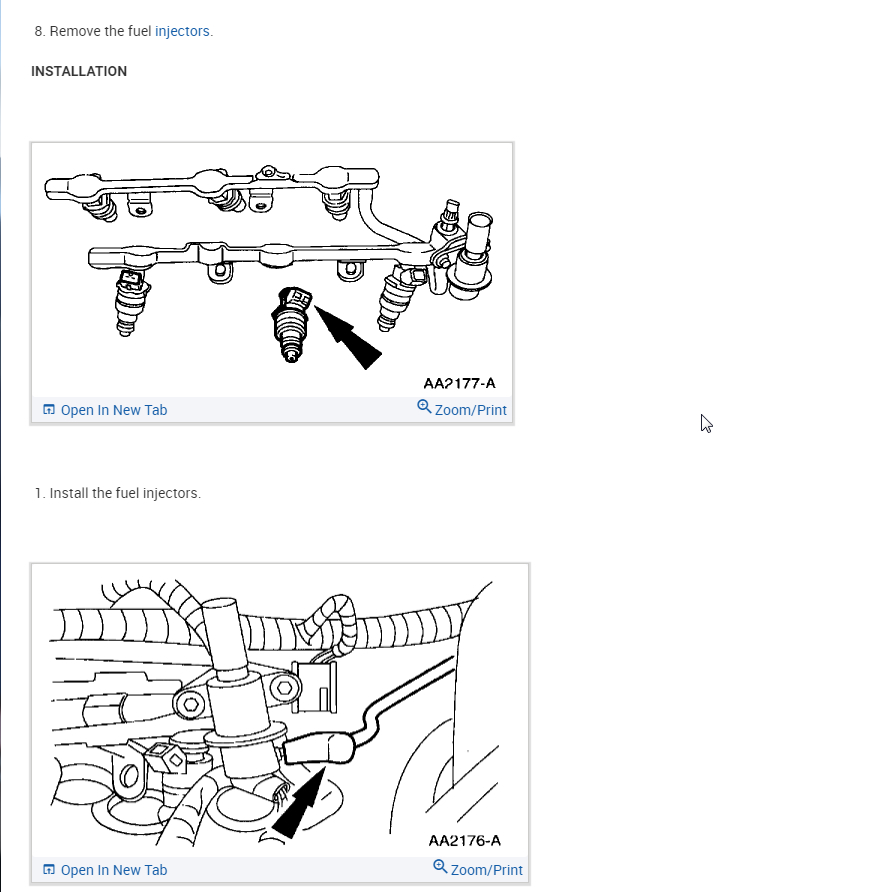

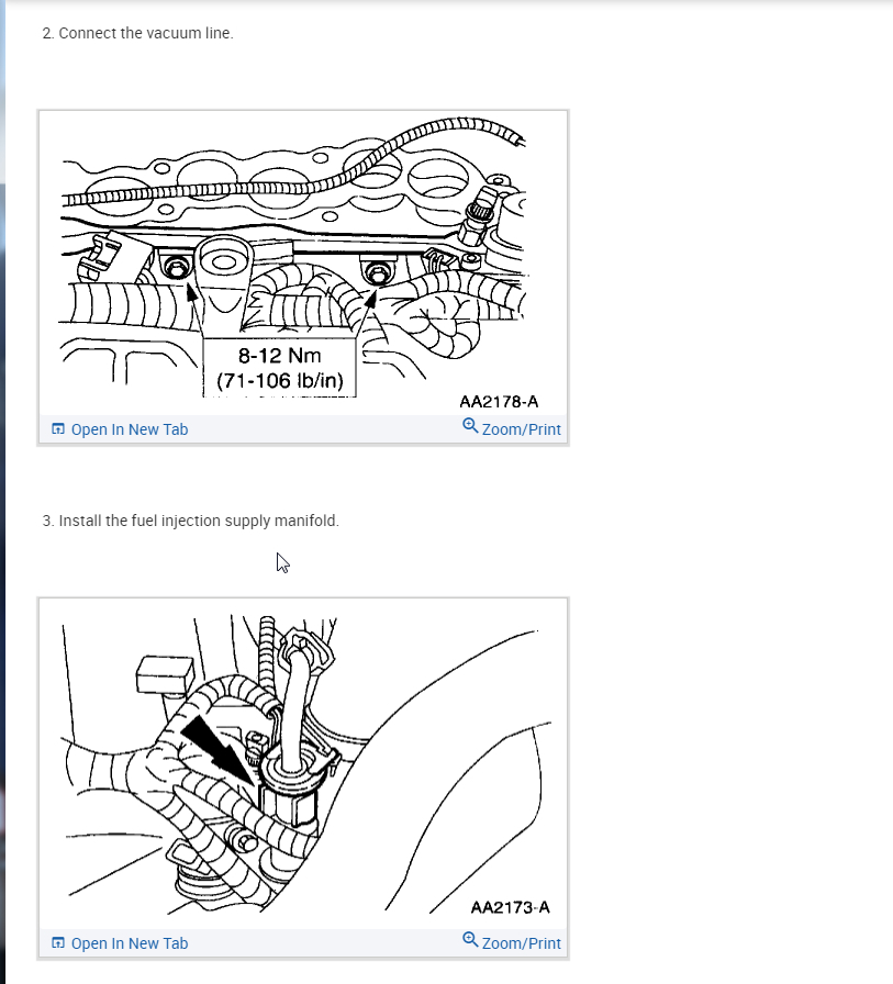

You can replace one injector at a time. That school of thought comes from people who only want to take apart the vehicle one time. So if there is something wrong with one just replace them all while you are there because they suspect the others are going to fail as well. However, I do not subscribe to this because if it is not broken I leave it alone. These injectors deliver the same fuel so unless the fuel is contaminated which caused the failure, I would only replace what is broken.
Here is the process for replacing the injectors.
Please reach out if there are issues. Thanks
