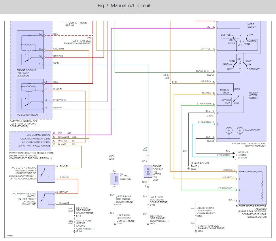

Thanks for replying ... there is no power at the plug to the compressor .... However, if I directly connect the compressor from the battery the clutch engages.
Checked all the fuses and none (that I could locate) are blown.
This obviously indicates that a switch or relay is bad ... any suggestons on where to start?
Jun 30, 2010 at 5:42 PM

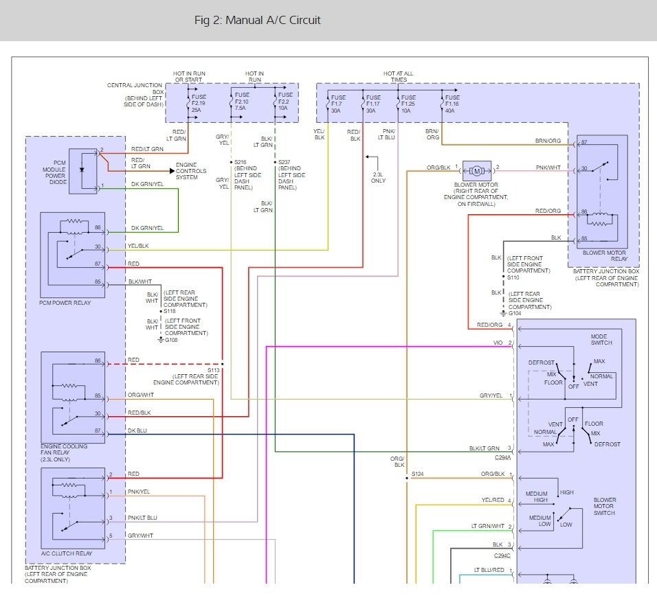

The compressor will not engage if the system is low. Here is a guide to show you how to check that.
https://www.2carpros.com/articles/air-conditioner-how-to-add-freon
Next there is a compressor relay that may have gone out
Here are some wiring diagrams (BELOW) so you can check the system to see why its not getting power.
You might have a compressor clutch coil that is bad and it needs replacing.
https://www.2carpros.com/articles/replace-air-conditioner-compressor
