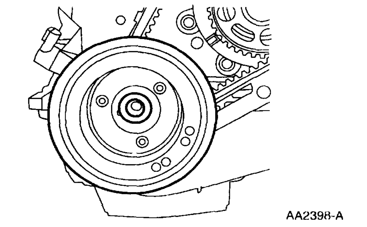

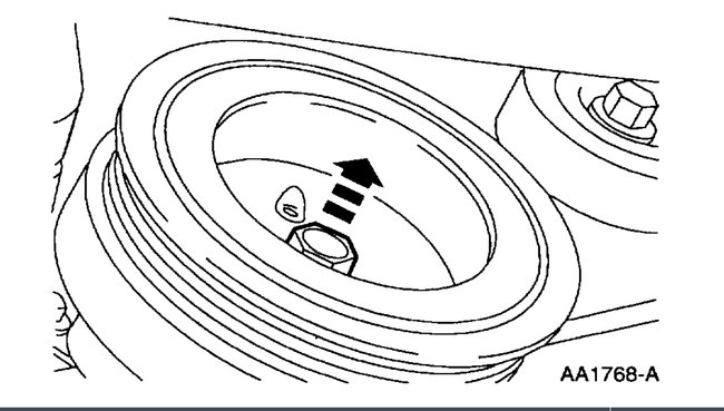

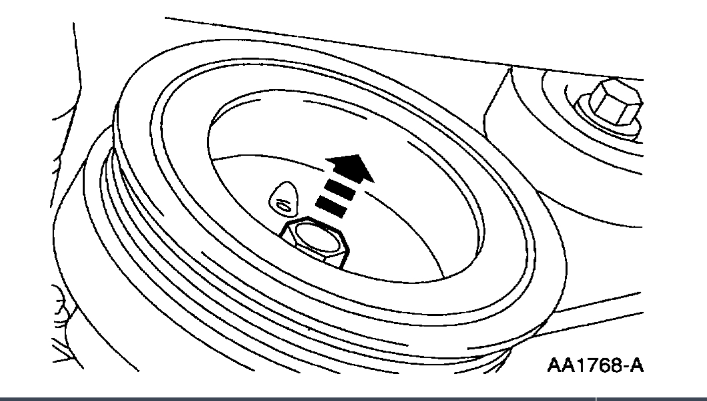

3. Remove the crankshaft pulley.
Remove the bolt.

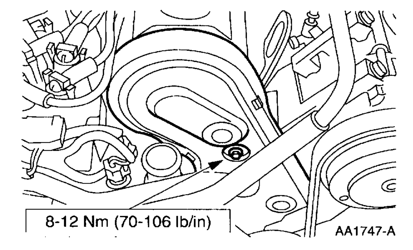

4. Remove the outer timing belt cover.

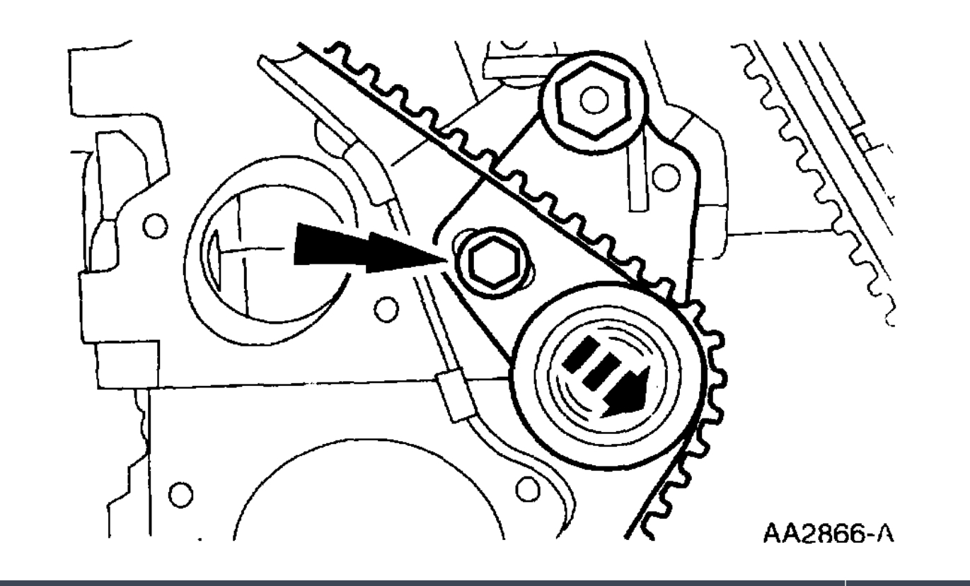

6. CAUTION: If you attempt to remove the belt without loosening both timing belt tensioner adjusting bolt and spring pivot bolt, damage to Camshaft Belt Tensioner Tool could occur when attempting to relieve belt tension.

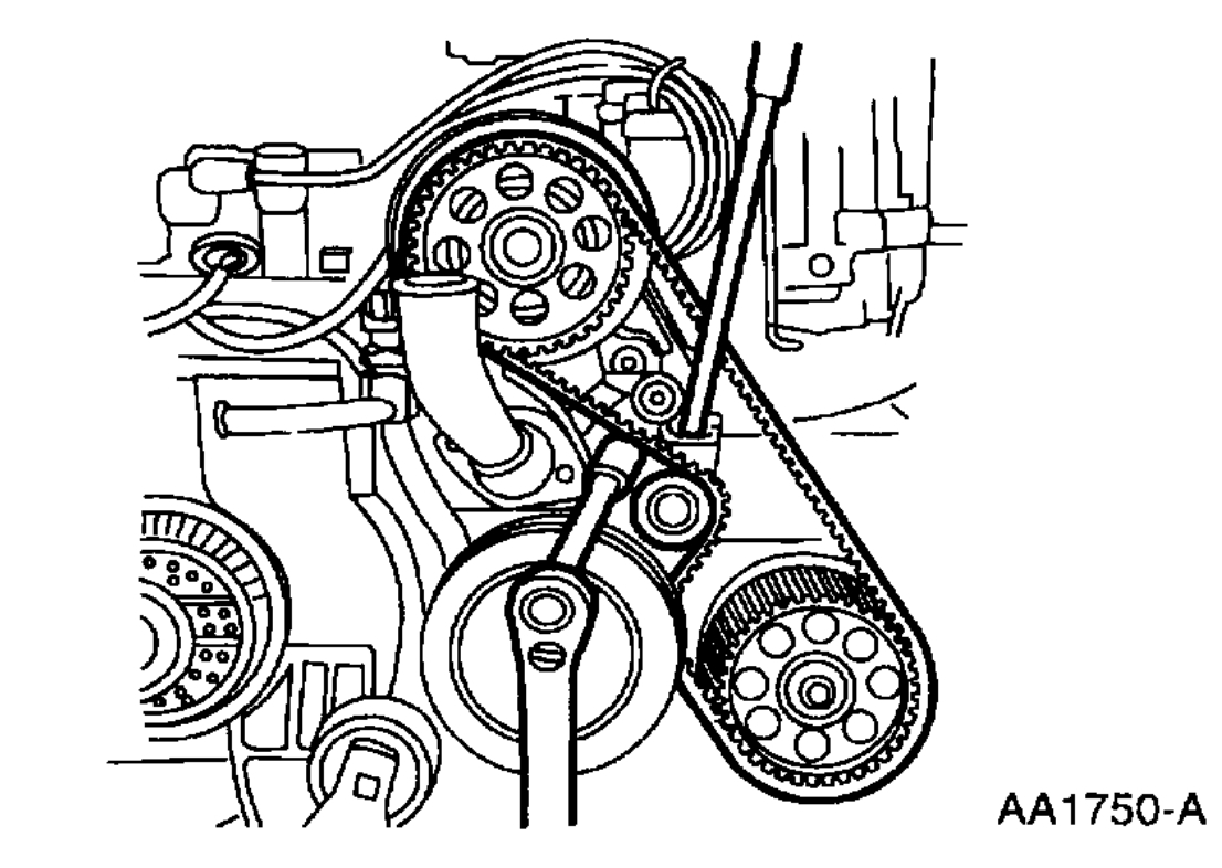

7. Loosen the timing belt spring pivot bolt. Do not remove.
8. Loosen the adjusting bolt slowly and release spring tension.
9. Rotate tensioner with adjusting tool, against spring pressure, clockwise to the farthest position.
10. Hold in this position and tighten adjusting bolt to hold tensioner away from the belt.
11. Remove the timing chain/belt.

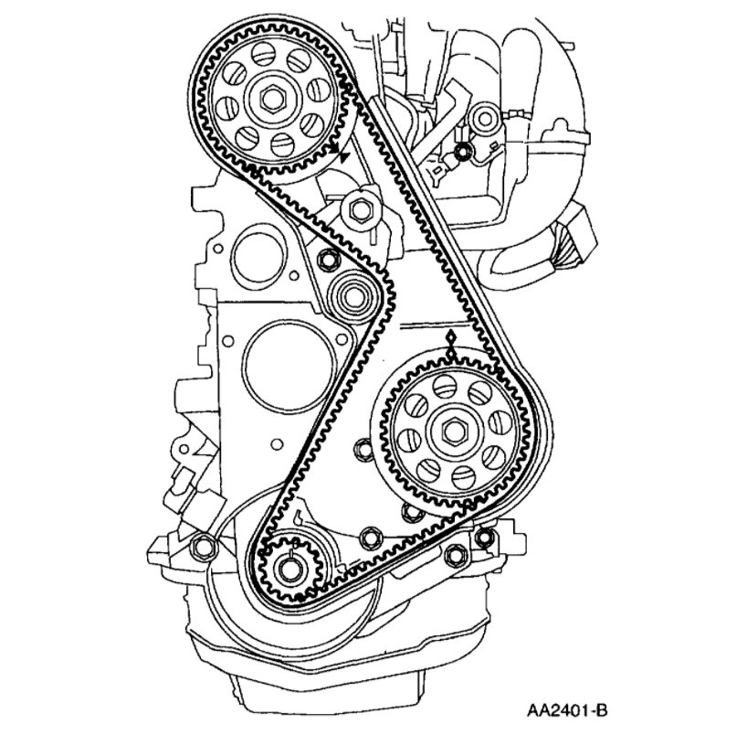

1. Make sure the crankshaft is at TDC on piston No. 1, with the crankshaft keyway pointing straight up and the circle on crankshaft sprocket aligned with notch in engine front cover.
2. Align the timing marks.
Align the crankshaft sprocket mark to the front cover notch.
Align the oil pump sprocket diamond to the engine front cover diamond.
Align the camshaft sprocket triangle to the engine front cover triangle.
3. Install the timing chain/belt over the crankshaft sprocket, proceeding counterclockwise over the oil pump sprocket and over the camshaft sprocket.
4. Loosen the bolt allowing the tensioner pulley to press against the timing chain/belt.
5. Note: The timing belt tensioner must not be tightened or belt tension will not be distributed over the entire belt.
Rotate the crankshaft two revolutions clockwise. Bring crank slowly to number one position firing position (keyway on crank facing up). The dot on the crankshaft gear is aligned with the notch on the front cover.

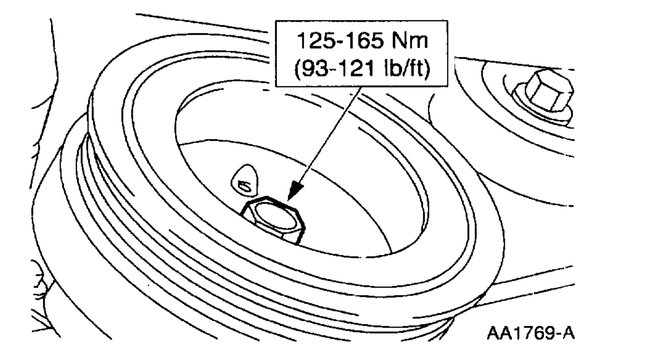

8. Install the crankshaft pulley.
9. Tighten the bolt.
10. Install the outer timing belt cover.
Tighten the bolt.

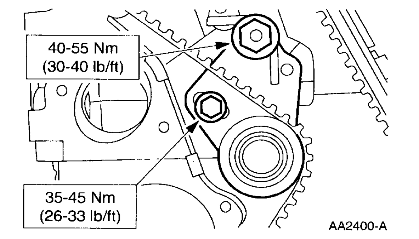

Hi Joshwissehr, Thank you for the donation. To adjust the tension of the belt, the spring for the tensioner is sufficient. However you need to turn the the engine to compression stroke to get the correct tension. After installation and everything tightened, turn the crankshaft clockwise at least one revolution to let the belt settle. Slowly turn the crankshaft until compression is felt. Loosen the tensioner and retighten when the spring tension moves the bearing.
https://www.2carpros.com/forum/automotive_pictures/192750_TimingBelt99RangerFig01_1.jpg

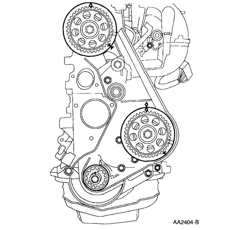

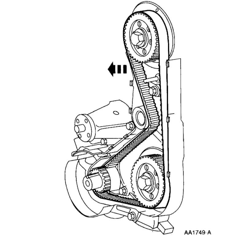

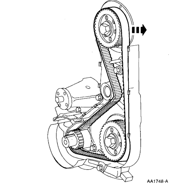

Timing belt removal: Disconnect battery ground cable. Remove exhaust side spark plugs. Remove fan shroud bolts and fan shroud, and position aside. Loosen, but do not remove, water pump pulley bolts. Remove accessory drive serpentine belt. Remove fan and clutch assembly retaining screws. Remove fan and clutch assembly. Remove fan shroud. Remove water pump pulley. On models with A/C, discharge A/C system using approved refrigerant recovery/recycling equipment. Remove A/C compressor from mounting bracket. Remove A/C compressor mounting bracket with power steering pump attached, and position aside. Remove timing belt outer cover retaining bolt. Release seven cover interlocking tabs. Remove timing belt cover. Rotate crankshaft in normal direction of rotation so that No. 1 cylinder is at TDC of compression stroke. Align camshaft, crankshaft and oil pump timing marks. See Fig. 1 crankshaft key-way should be pointing straight up, and circle on crankshaft sprocket must align with notch in engine front cover. Holding timing belt tension-er with camshaft belt tension adjuster (T74P-6254-A) or equivalent, loosen adjusting bolt and pivot bolt. Slowly release spring tension. Pry tension-er away from timing belt, and tighten bolt to hold tension-er in place. Remove timing belt.
https://www.2carpros.com/forum/automotive_pictures/266999_150_2.jpg
Installation: Ensure crankshaft is set at TDC and camshaft sprocket timing mark and oil pump sprocket timing mark are aligned with inner cover timing marks. Install timing belt on crankshaft sprocket, oil pump sprocket and then the camshaft sprocket. Loosen timing belt tension-er bolt. Allow tension-er to adjust itself against timing belt. Do not tighten belt tension-er. Slowly rotate crankshaft clockwise 2 complete turns clockwise (as viewed from front of engine) so No. 1 cylinder is at TDC of compression stroke. Recheck timing alignment marks. If timing marks are not aligned, re-position timing belt. Repeat timing belt tensioning procedure. Tighten timing belt tension-er adjusting and pivot bolts to specification. See TORQUE SPECIFICATIONS: Install crankshaft pulley. Tighten center bolt to specification. Install timing belt cover. Install exhaust side spark plugs. Install A/C compressor mounting bracket to engine. Install A/C compressor to mounting bracket. To complete installation, reverse removal procedure. Recharge A/C system, if necessary.
https://www.2carpros.com/forum/automotive_pictures/266999_1502_2.jpg

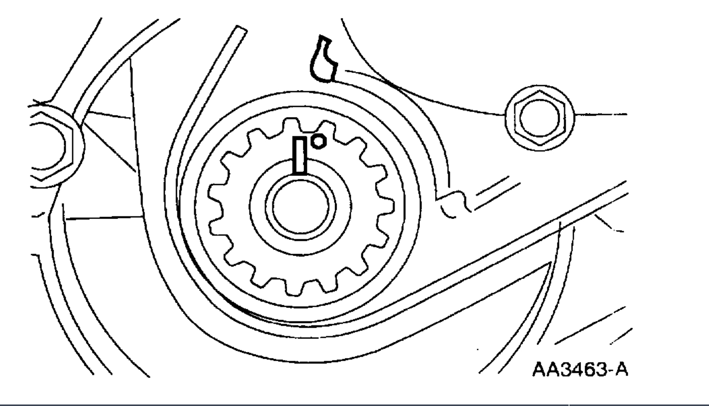

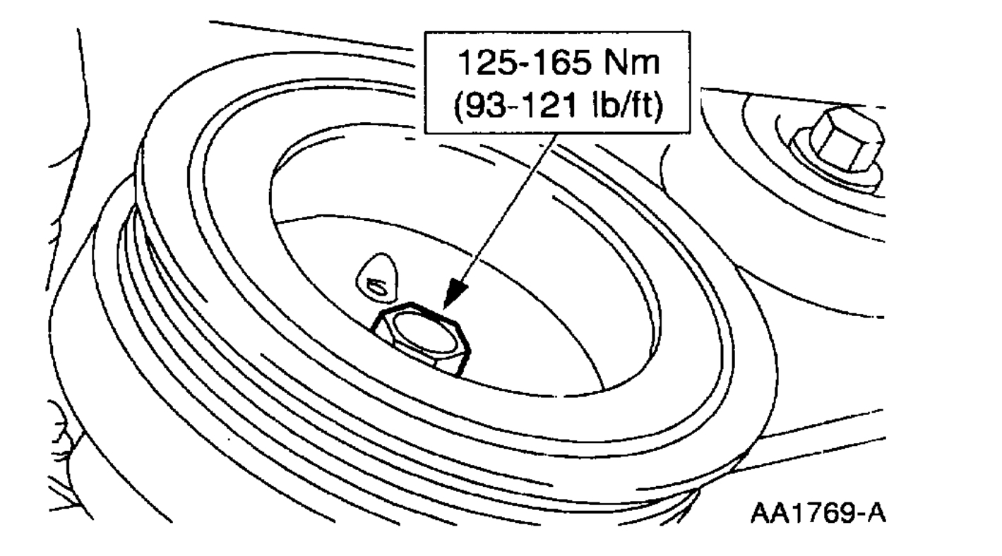

DAVE H
  • 13,384 POSTS
You have the timing slightly out still put a thin screwdriver into number one plug hole rotate crankshaft clockwise so that the piston is on the rocking point between up and down. it needs to be right at the top point at the end of the up stroke before it starts to go down again. here is a better picture of the timing marks. I hope this helps. let me know.
https://www.2carpros.com/forum/automotive_pictures/266999_ranger2_1.jpg
https://www.2carpros.com/forum/automotive_pictures/266999_ranger3_1.png
