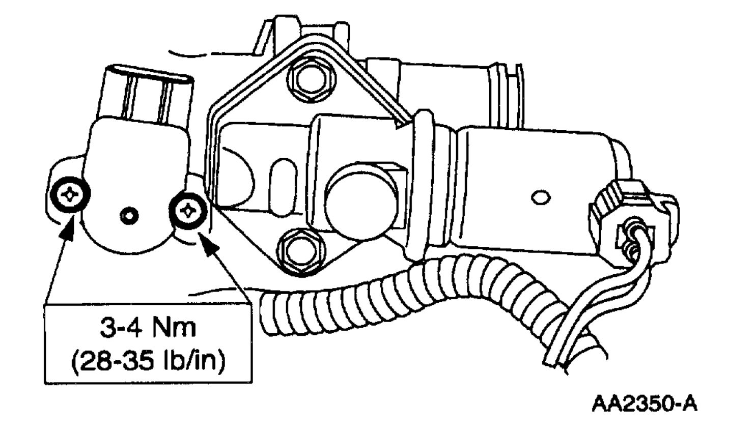

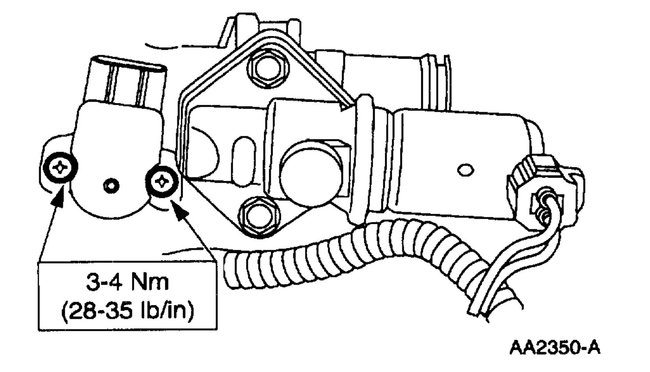

Location top right side of engine on the throttle body

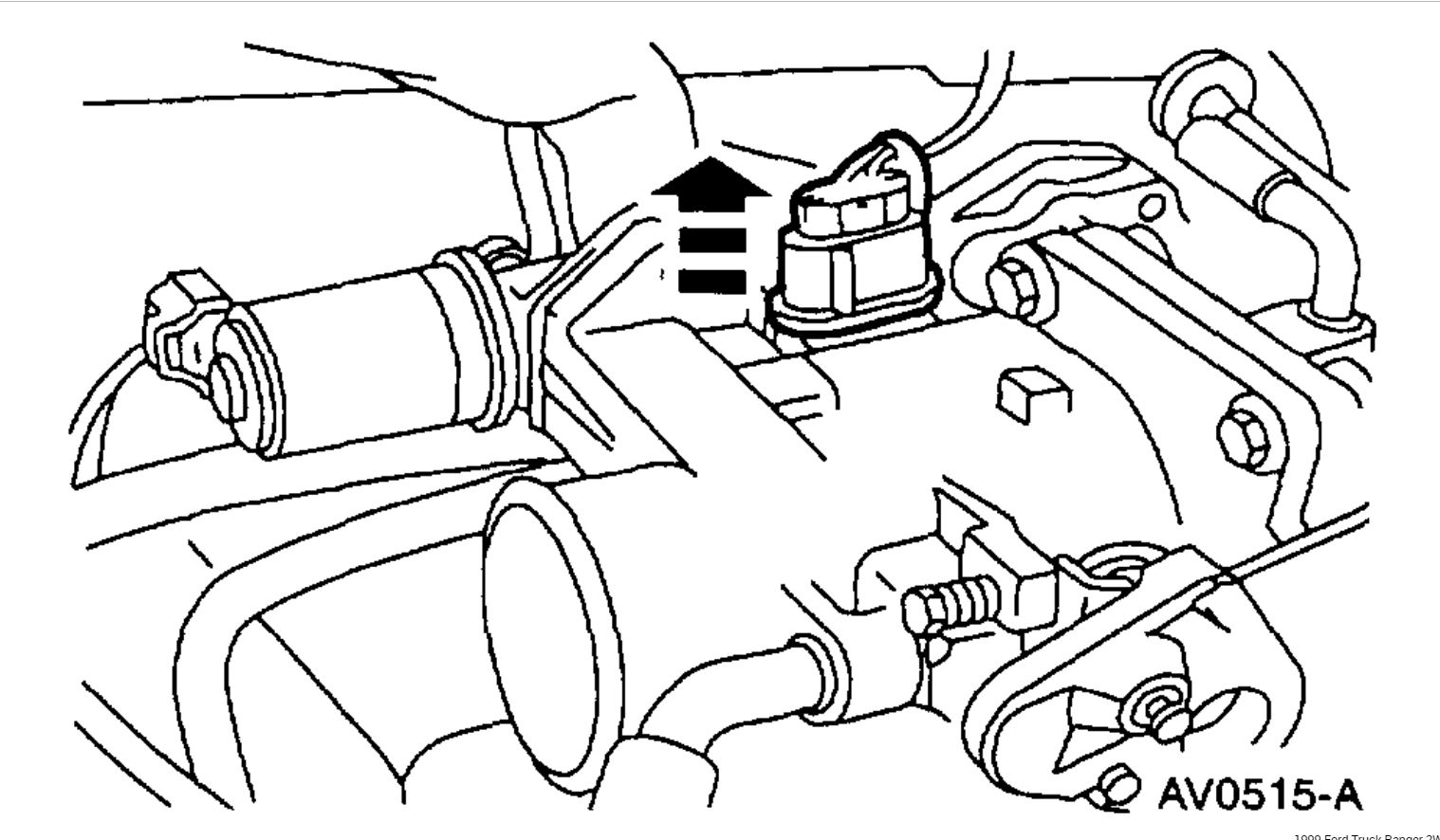

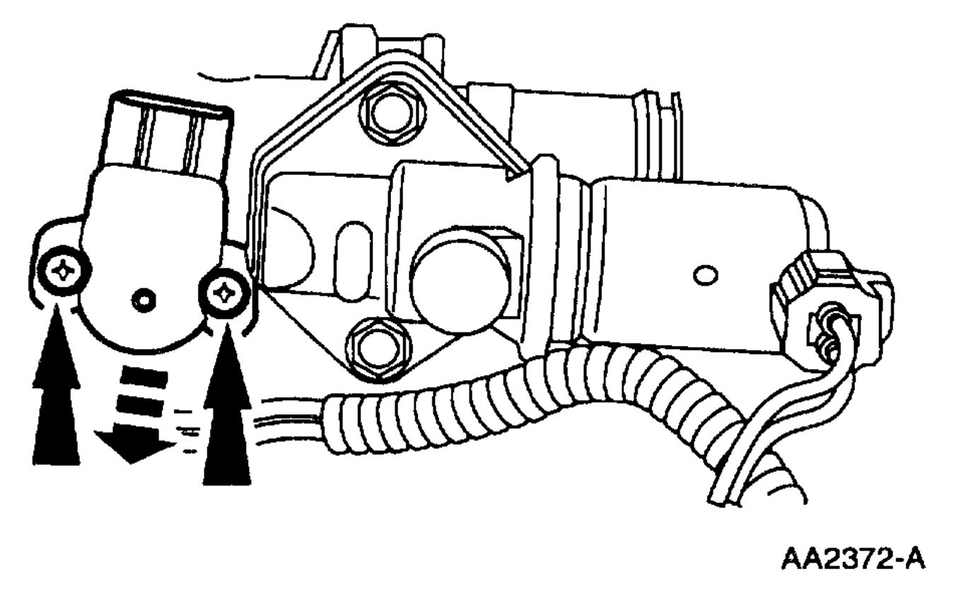

REMOVAL
1. Disconnect the battery ground cable.
2. Disconnect the Throttle Position (TP) sensor connector.
3. Remove the throttle position sensor.
^ Remove the screws.
^ Remove the throttle position sensor.

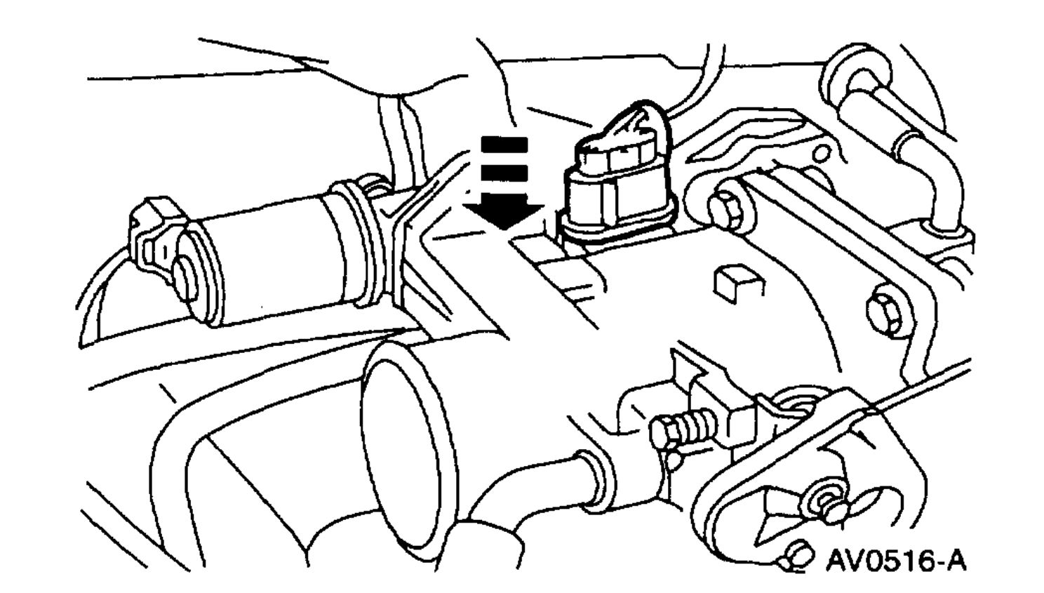

INSTALLATION
1. Follow the removal procedure in reverse order.

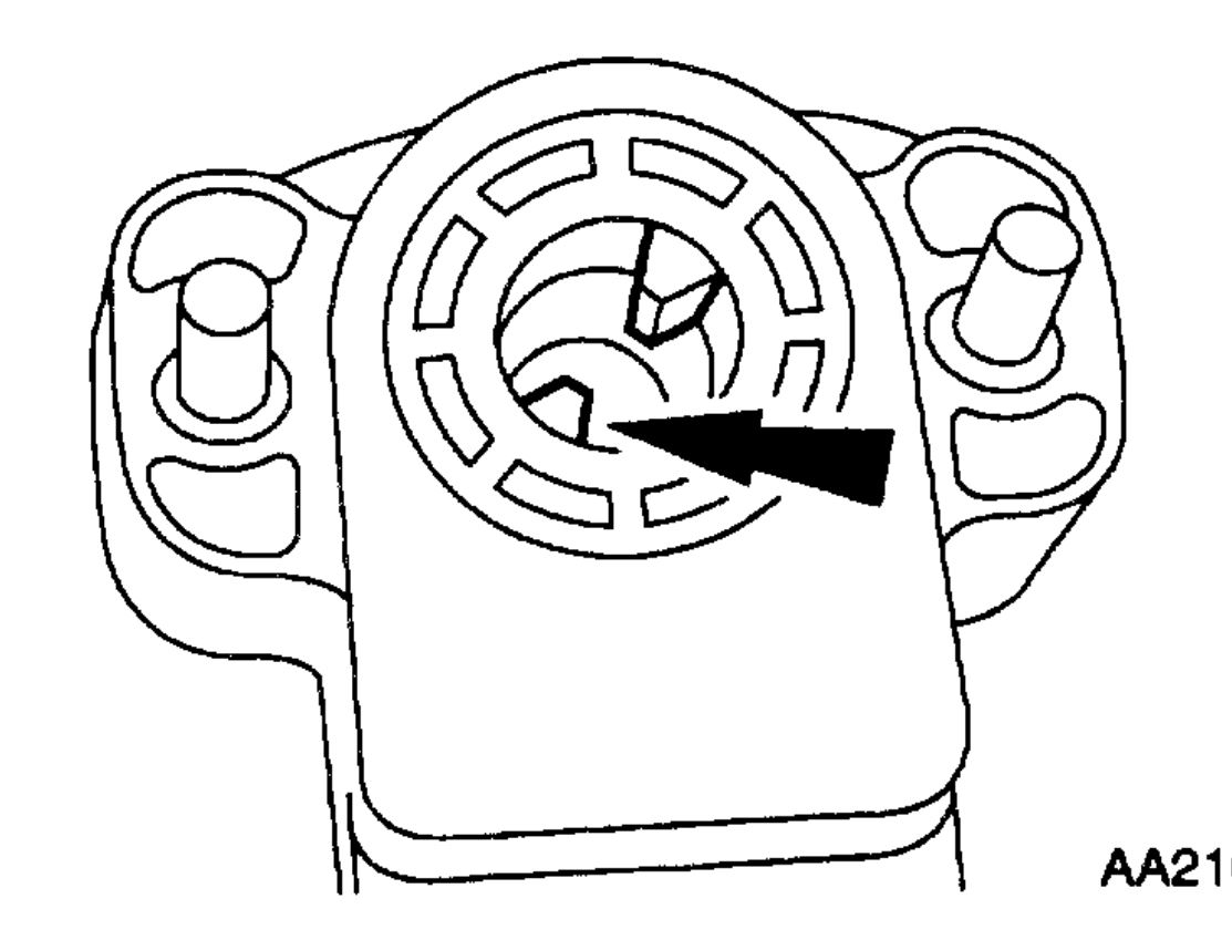

2. Install the throttle position sensor by sliding the rotary tangs into position over the throttle shaft blade, then rotate the throttle position sensor.
NOTE: Failure to install the throttle position sensor in this manner may result in excessive idle speeds.
See diagrams below
