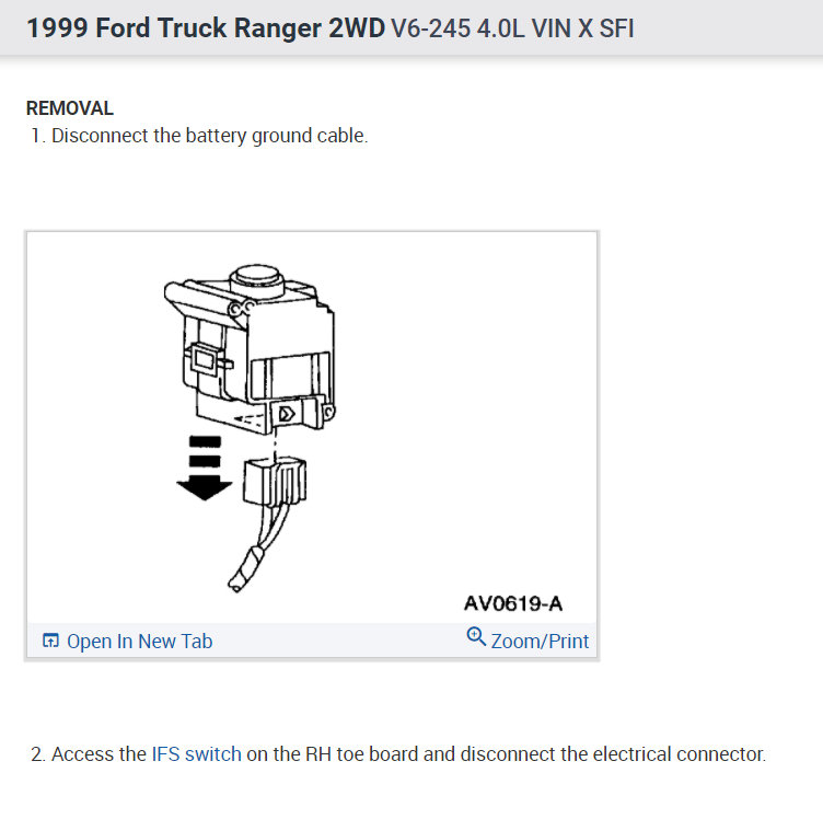

When you turn key to run-do you hear the fuel pump come on, If not check fuse no.18 20amp in the power distribution box and test the fuel pump relay and PCM power relay and aslo test the inertia switch.
