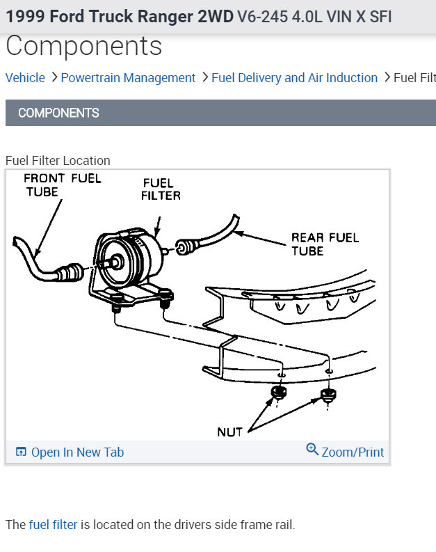

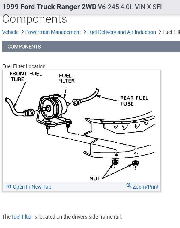

Fuel line where fuel filter connects under a 1999 Ford Ranger is boogered up, wont seat around fuel filter, sprays fuel out. Can you get a new connection kit. I was told not use rubber hose with clamps, because pressure is to great. Any suggestions.

Auto parts stores make a spring seat kit to replace the damaged clip in the housing. Use a pick to remove the old one and then just install the new one. CHeck out the diagrams below.

If it has the metal spring clips. Get some lube and soak the hell out of it. Move the line going into the fuel filter in and out until it moves freely. You need a special too to undo the lines. Go to an autozone and rent it. push the tool into the srping clip and pull the line out of the fuel filter. If it is that style, which i think it is. If it has never been changed then it will fight you for a little while.

Shoot a little oil in the "crack", around the spring, push hard as you twist the tool back and forth
I have found that the more travel you can get while twisting, the ezier it is

Clean all dirt and/or grease from the fuel filter fittings. "Quick Connect'' fittings are used on models equipped with a pressurized fuel system. These fittings must be disconnected using the proper procedure or the fittings may be damaged. The fuel filter uses a "hairpin'' clip retainer. Spread the two hairpin clip legs about 1 / 8 in. (3mm) each to disengage it from the fitting, then pull the clip outward. Use finger pressure only; do not use any tools. Push the quick connect fittings onto the filter ends. Ford recommends that the retaining clips be replaced whenever removed. The fuel tubes used on these fuel systems are manufactured in 5 / 16 in. and 3 / 8 in. diameters. Each fuel tube takes a different size hairpin clip, so keep this in mind when purchasing new clips. A click will be heard when the hairpin clip snaps into its proper position. Pull on the lines with moderate pressure to ensure proper connection. Start the engine and check for fuel leaks. If the inertia switch (reset switch) was disconnected to relieve the fuel system pressure, cycle the ignition switch from the OFF to ON position several times to re-charge the fuel system before attempting to start the engine.

Well, you could relieve the pressure from your fuel rail. There is a black capped valve (looks similar to tire valve) make sure the key is off, than press in till pressure is relieved. You will get fuel all over your engine... Me, I would just grab a pan and slowly pull the line from the filter. It will only spray for a second or two... as long as the key is off.

There's an easy way to do it:
turn your car on and unplug the fuel pump relay...
your car will keep running for a few seconds then will die. Try to start it a few more times (with the relay still removed) to make sure you get rid of any pressure left, and you're good to go.
After you're done replacing the filter, and with the relay back on there, turn your key to 'on' a few times to rebuild pressure.
