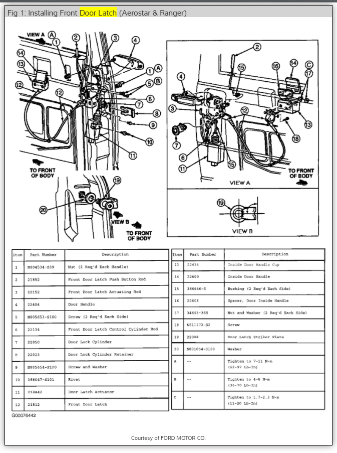

What happens is the switch in the drivers door latch goes out then the system thinks the car is getting stolen.
Here is a guide to replace the latch and fix the problem. (below)

Testing from the book if needed:
TEST C - DISARMING ANTI-THEFT
Arm system. Warning indicator should be on. Press UNLOCK button on remote transmitter. Observe doors. If system disarmed and warning indicator went out, go to next step. If doors did not unlock, repair remote entry power door lock circuit. If system did not disarm, go to TEST E. If doors unlocked, but system did not disarm, call telephone number on RAP for assistance.
Arm system. Warning indicator should be on. Unlock driver's door with key. Repeat procedure for passenger's door and liftgate. If system disarmed and warning indicator went out, and vehicle is not equipped with driver's door keypad, system is okay. If system disarmed and warning indicator went out, and vehicle is equipped with driver's door keypad, go to next step. If doors did not unlock, repair door locks. If system did not disarm, go to step 5).
Arm system. Warning indicator should be on. Attempt to unlock doors with keypad. If doors unlocked and system disarmed, go to next step. If doors did not unlock, repair remote entry door lock circuit. If doors unlocked, but system did not disarm, call telephone number on RAP for assistance.
Enter RAP, PID/DATA. Select IGN_RAP. Turn ignition off. NGS tester communication may lost be after a few seconds. IGN_RAP state OFF should be displayed. Turn ignition on. IGN_RAP state RUN/AC should be displayed. If displays are as specified, disarm circuit is okay. If displays are not as specified, repair defective ignition switch circuitry, or replace defective ignition switch. See Fig. 1.
Enter RAP, PID/DATA. Select DR_DARM. DR_DARM NOT ACT should be displayed. Unlock each door and liftgate with key. DR_DARM ACTIVE should be displayed. If NGS tester displays both states, call telephone number on RAP for assistance. If both states are not displayed, inspect all switches and associated wiring for shorts or opens. Repair as necessary, then retest system.
