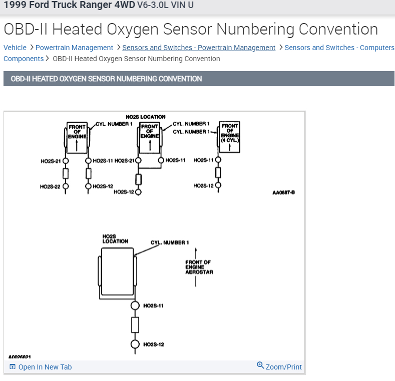

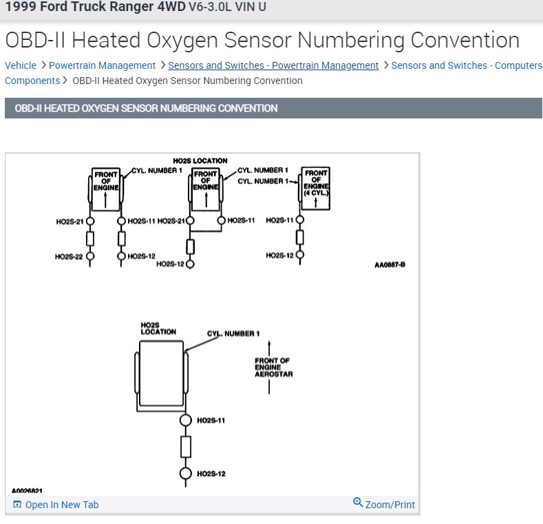

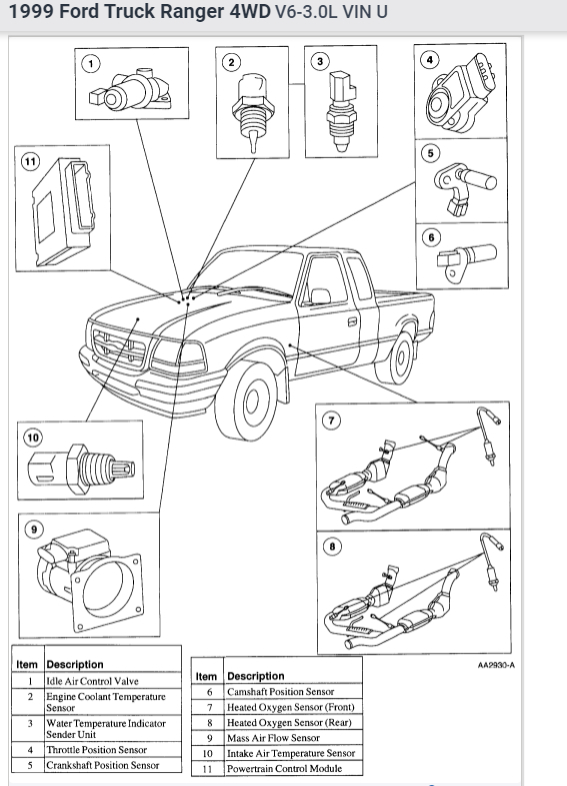

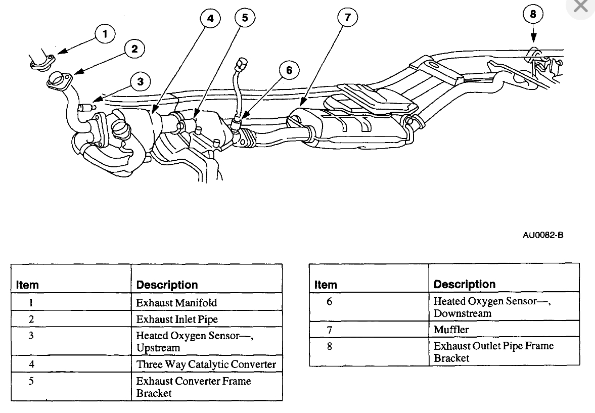

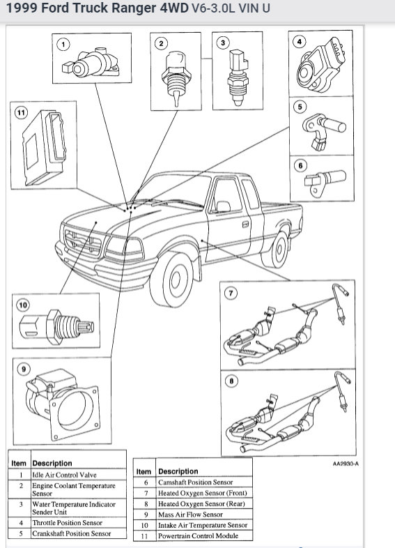

The oxygen sensors are located in the exhaust system.
There are one of each on both sides exhaust manifold. Then one of each on the exhaust pipe after the catalytic converter.

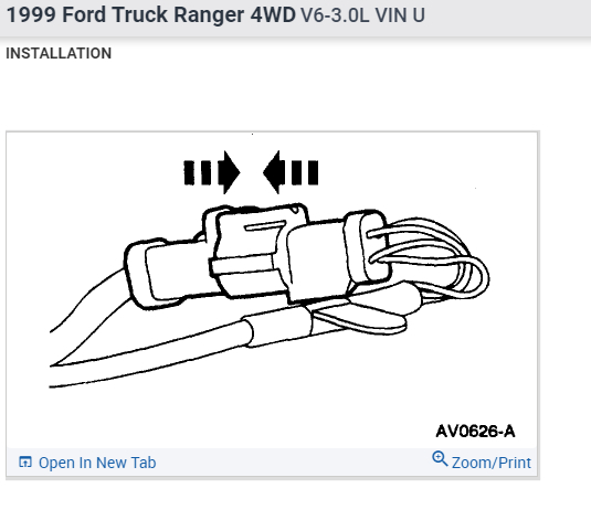

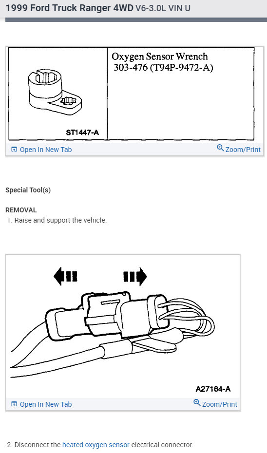

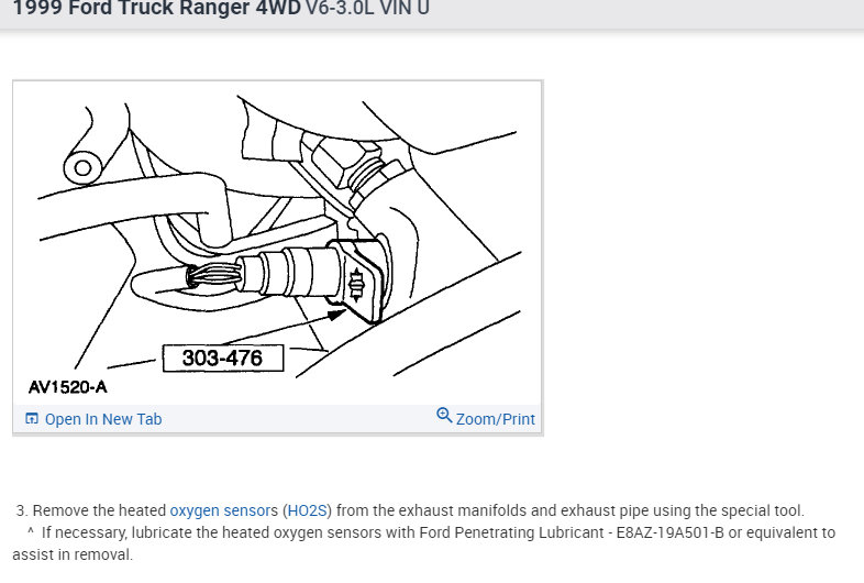

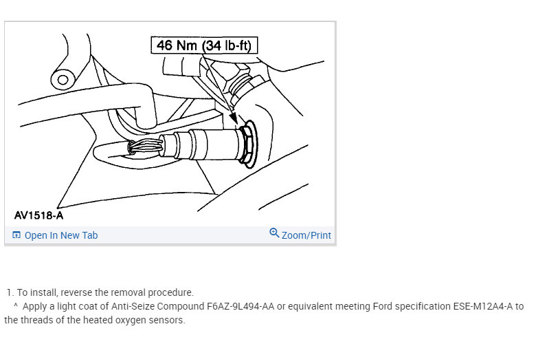

Also, some articles that covers the oxygen sensor replacement procedures:
https://www.2carpros.com/articles/how-an-oxygen-sensor-works
https://www.2carpros.com/articles/how-to-replace-an-oxygen-sensor
