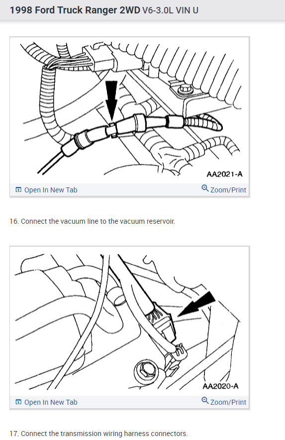

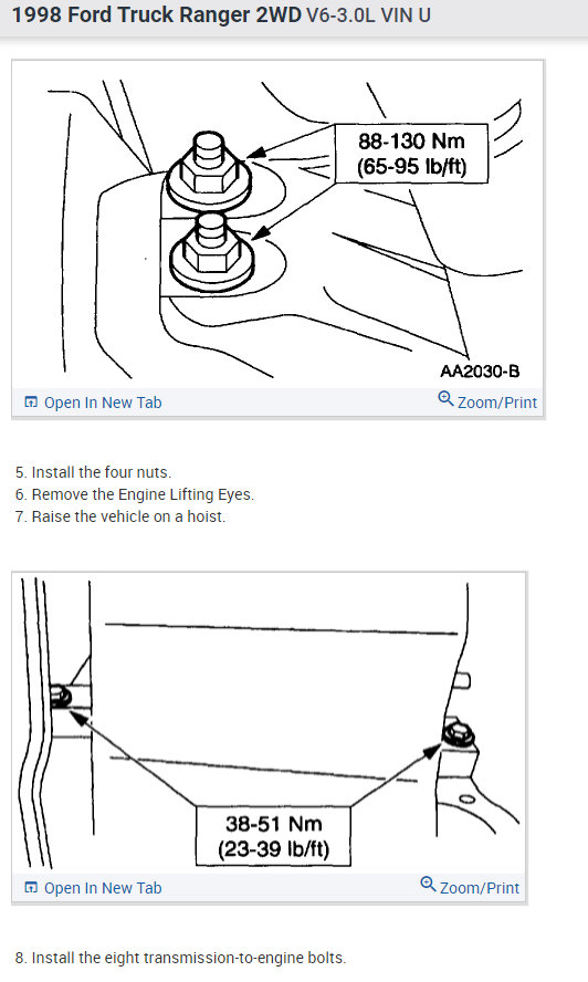

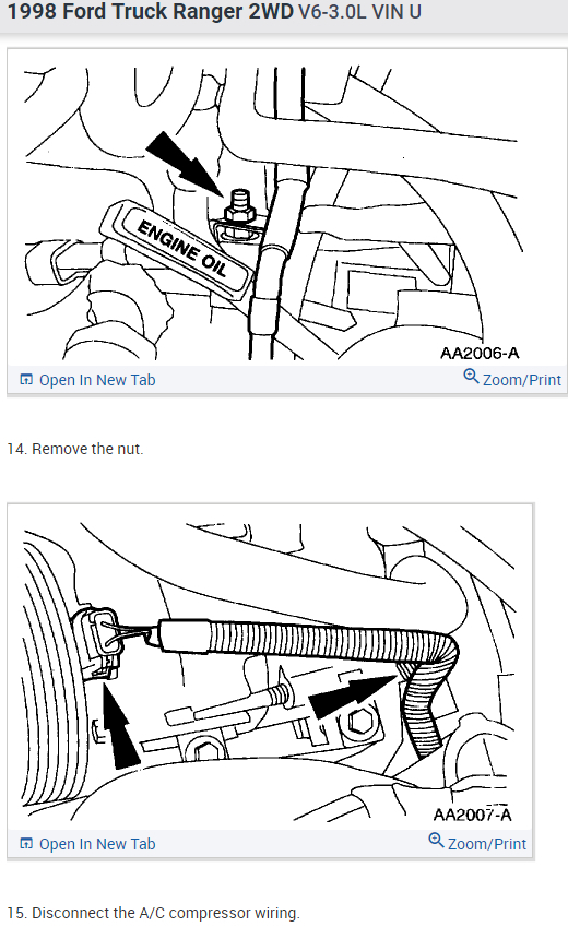

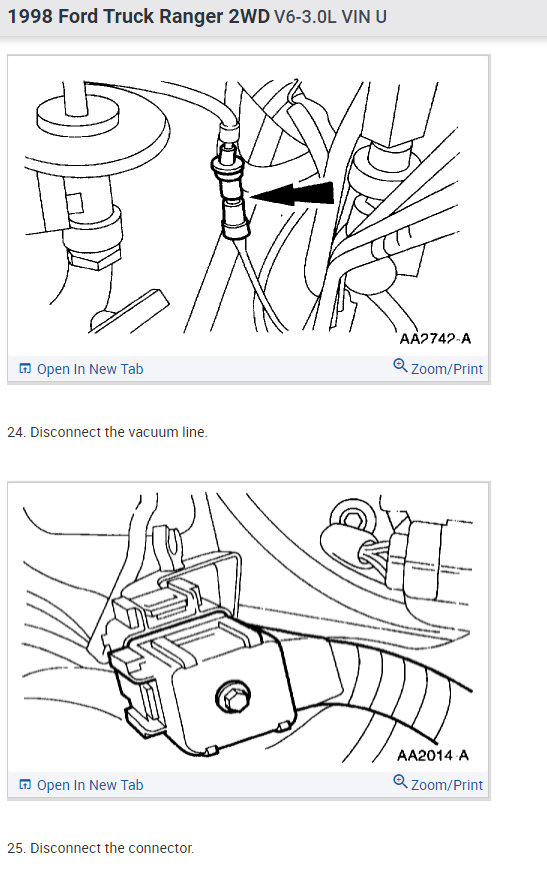

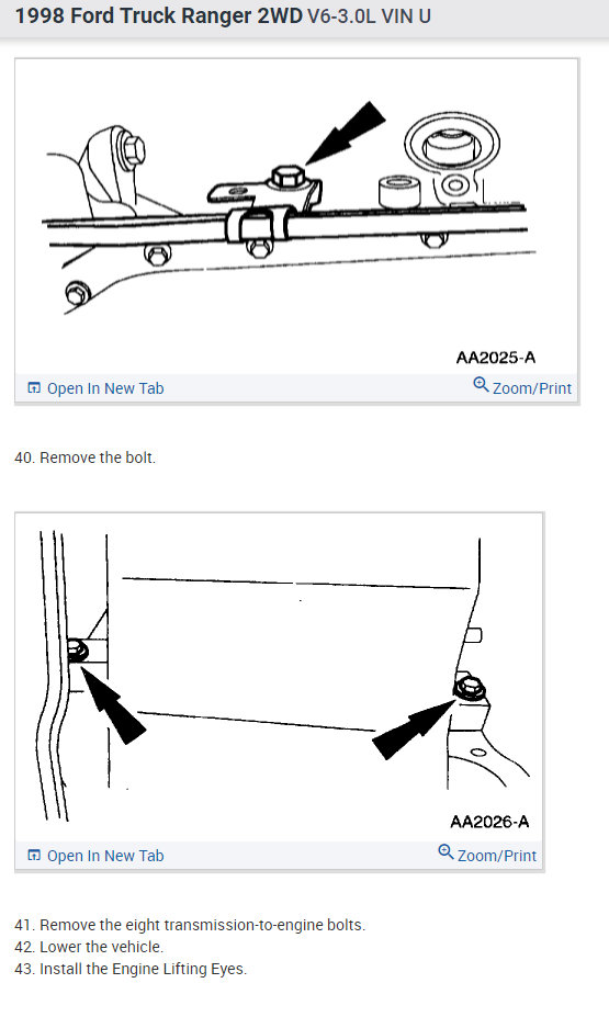

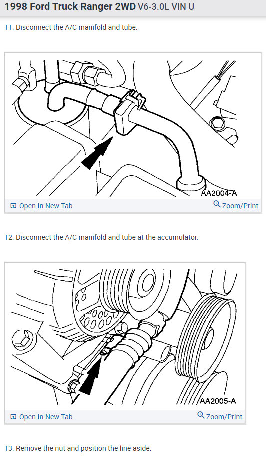

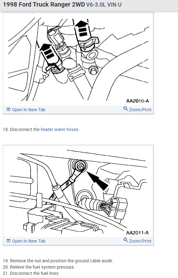

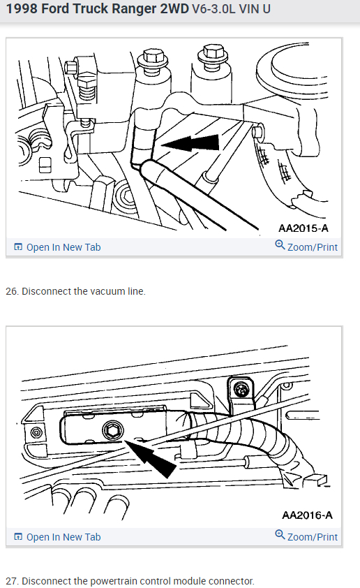

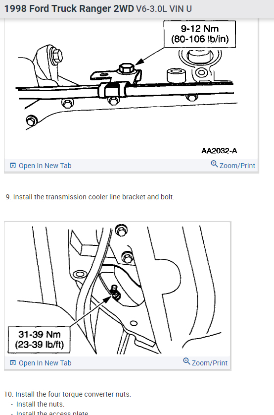

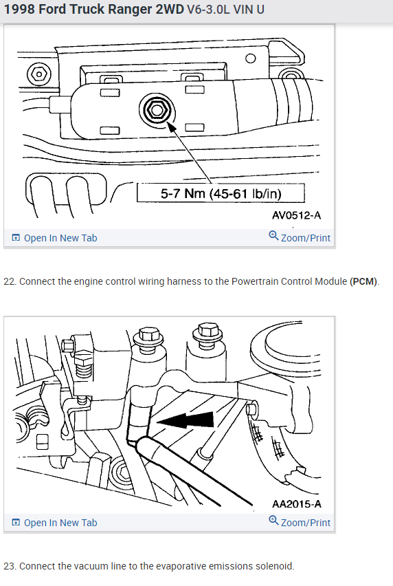

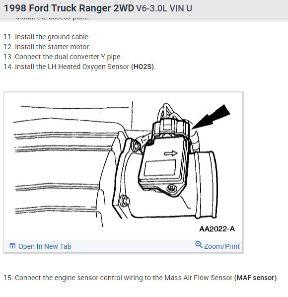

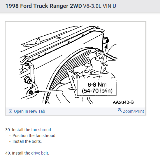

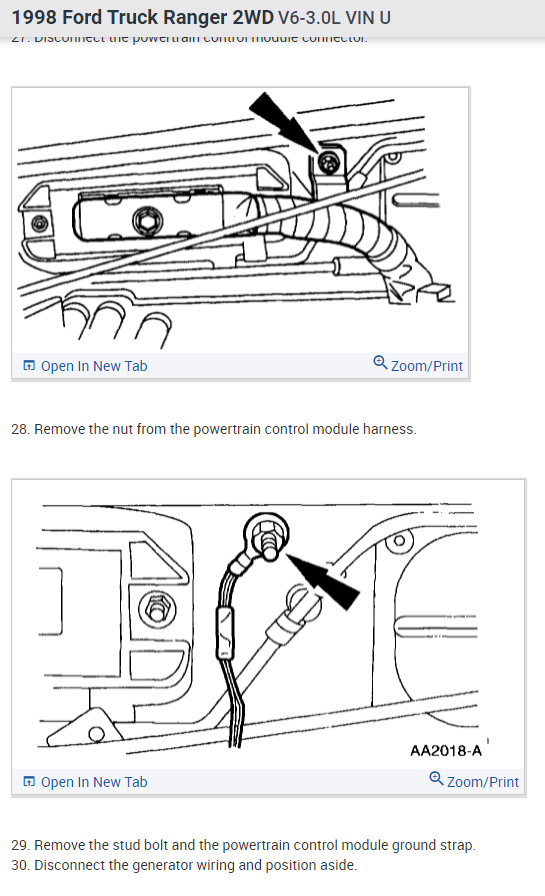

Here is a helpful tutorial on engine replacement:
https://youtu.be/zy1CozLgWUQ

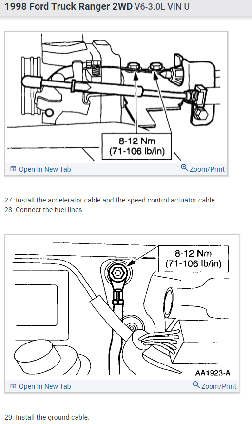

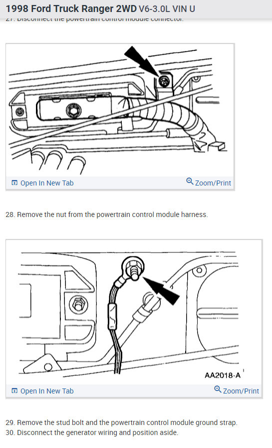

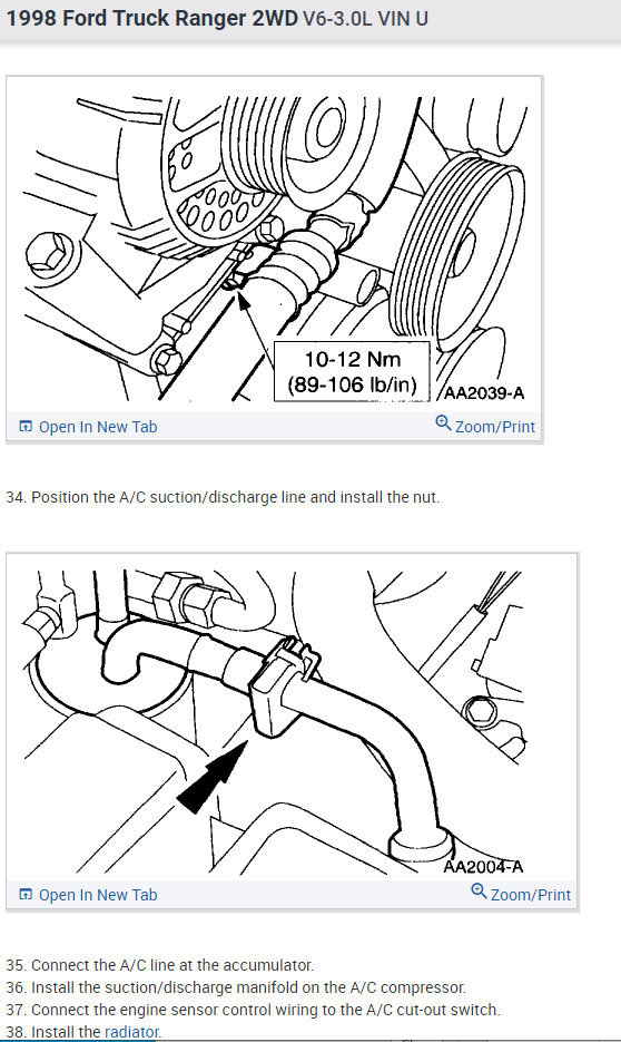

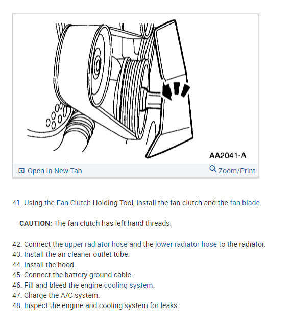

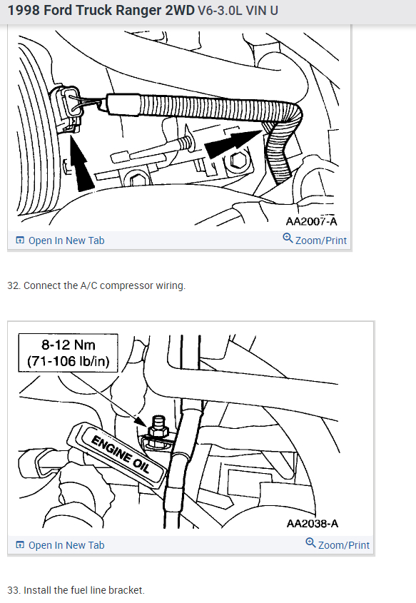

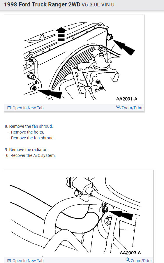

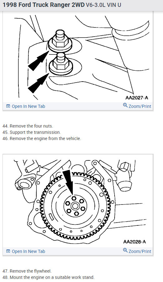

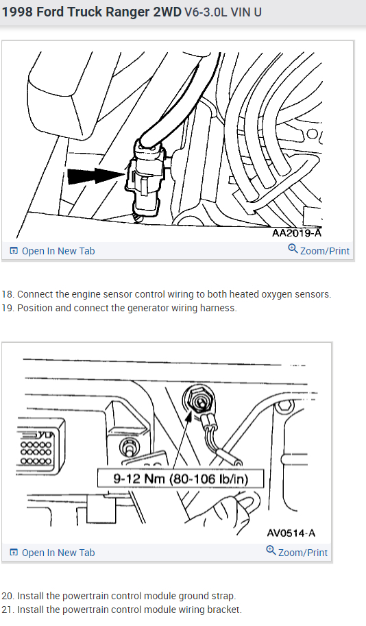

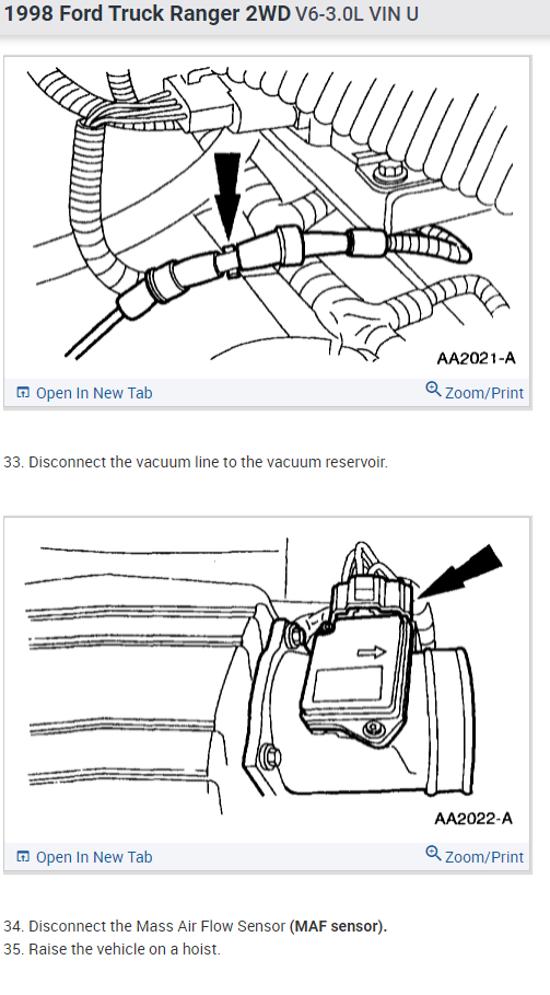

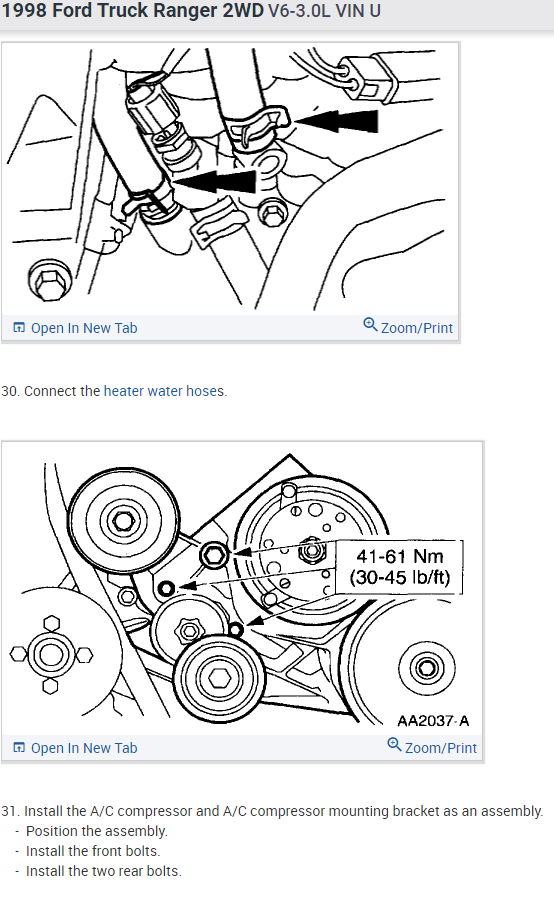

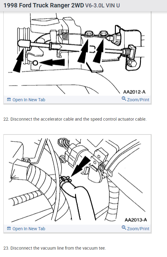

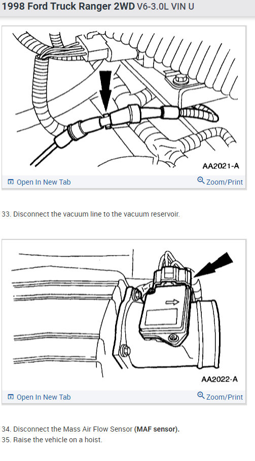

I have included the engine replacement procedure for the Ranger with 3.0.
