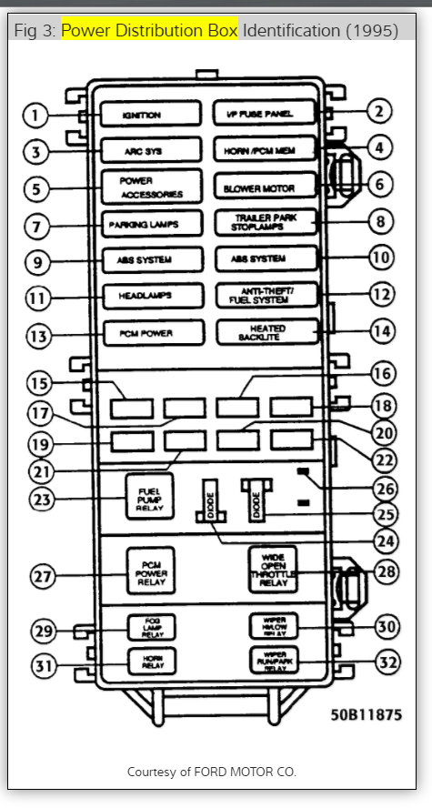

Here is the relay location with a guide to help test it. https://www.2carpros.com/articles/how-to-check-an-electrical-relay-and-wiring-control-circuit
https://www.2carpros.com/forum/automotive_pictures/12900_ranger_3.jpg
Check out the diagrams (Below). Please let us know what you find. We are interested to see what it is.

Recently my fuel pump has been running after the key is turened off. I bought a new fuel pump relay, and when I pulled the old relay out the pump continued to run. Why??
Nov 24, 2020 at 8:17 AM (Merged)
RASMATAZ
  • 75,992 POSTS
The black and yellow wire is shorted to the dark green and yellow within the fuel pump relay wiring
Pull the fuse no.1 in the power distribution box this will caused it to stop which is the black and yellow wire that powers the relay

WHERE IS THE FUEL PUMP RELAY LOCATED ON THIS VEHICLE
INTERNETMECHANIC
  • 700 POSTS
My info showed under the hood passenger side.
https://www.2carpros.com/forum/automotive_pictures/512072_ranger_fuel_pump_relay_1.jpg
