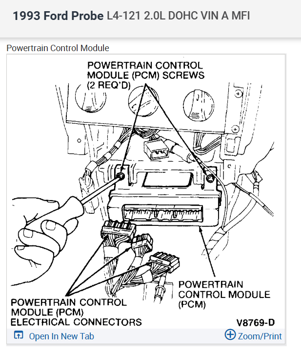

The PCM in that car is behind the center of the dash, forward of the center console. As far as swapping PCM's, the car has to be the same exact year, engine, trans, if possible see if the part #s match up as well

You should be able too, there will be a sticker, or part number, just make sure they match!located in the center console.

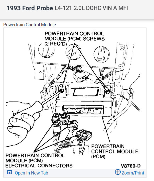

The engine control module is in the center console. Check out the images (below). Let us know if you need anything else.
