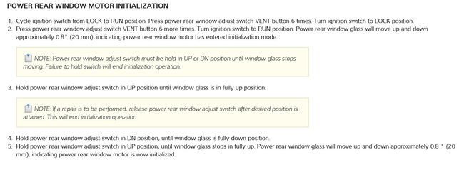

I did all those steps, and when I am done sending the window all the way up and then all the way down until it stops, the window will not work. Is there another part to the programming of the window?

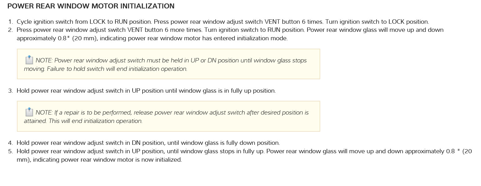

the window has failed to initialize. the instructions were incorrect as the button has to be held down/up etc., to complete it. you might have to take it to a mechanic to get it to work again so he use his scanner and command it to work. See picture on how to properly do it.
