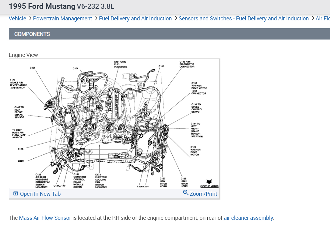

on my 95 Mustang Convertible 3.8L these are the codes im geting bank 1 and 2 to lean what shoud I try would it be the fuel mixture and if thats It how do I adjust it on this car

This problem is usually the mass air flow sensor or a vacuum leak, here is a guide to help with the leak and the MAF sensor location in the images below. Be sure to test for the leak when the engine is cold.
and
https://www.2carpros.com/articles/repair-lean-mixture-codes-p0171-or-p0174-on-some-manufacturers
Check out the images (Below). Please let us know if you need anything else to get the problem fixed.
