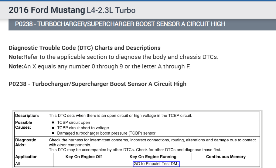

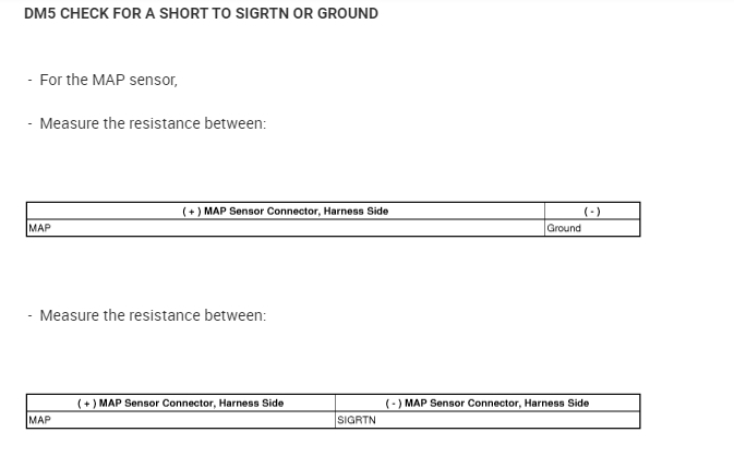

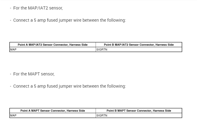

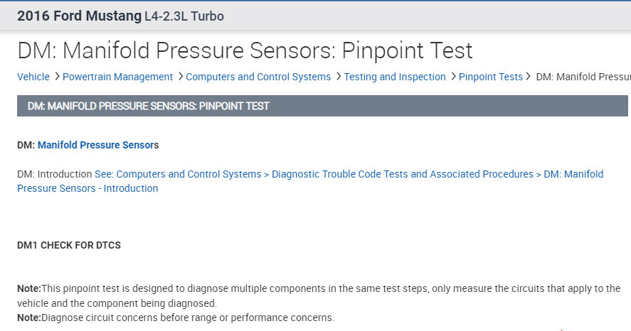

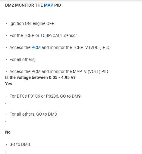

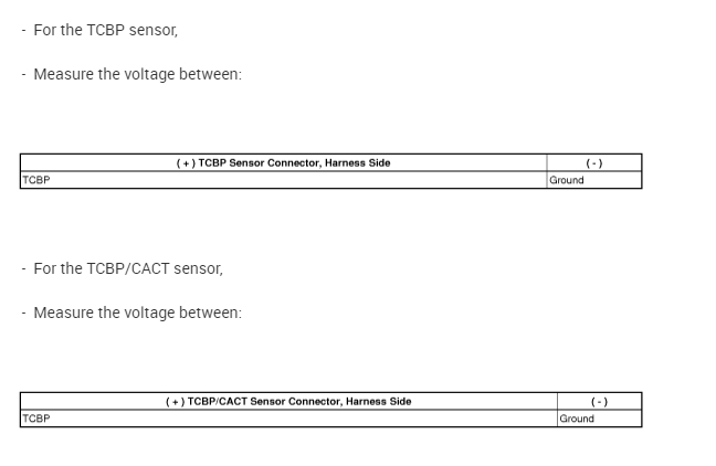

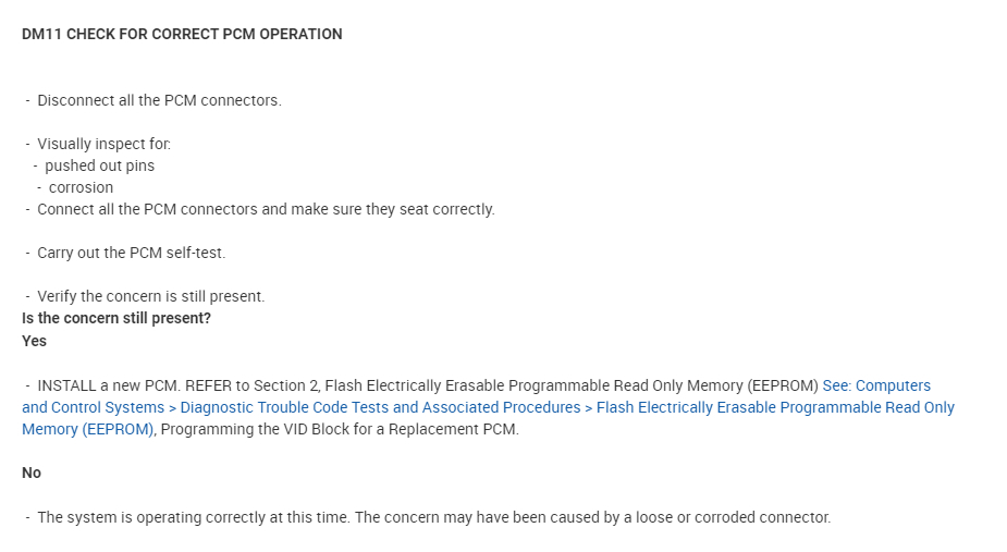

The code is related to the turbocharger boost pressure sensor. Either the sensor is faulty or there is a wiring issue. See pic 1 below.

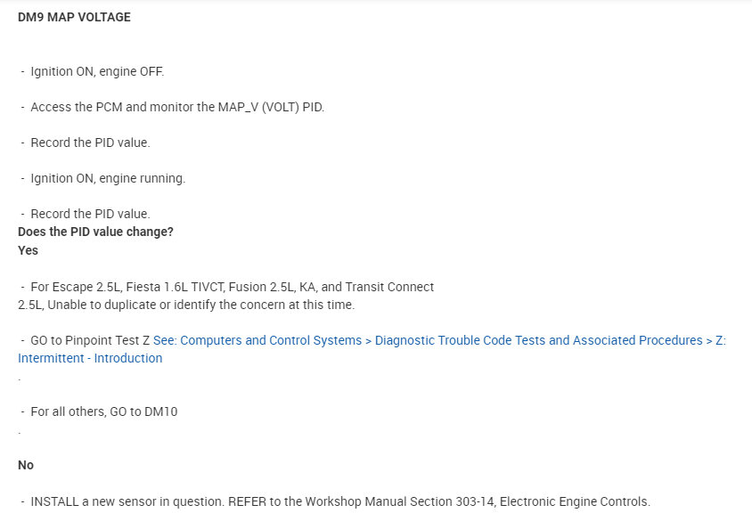

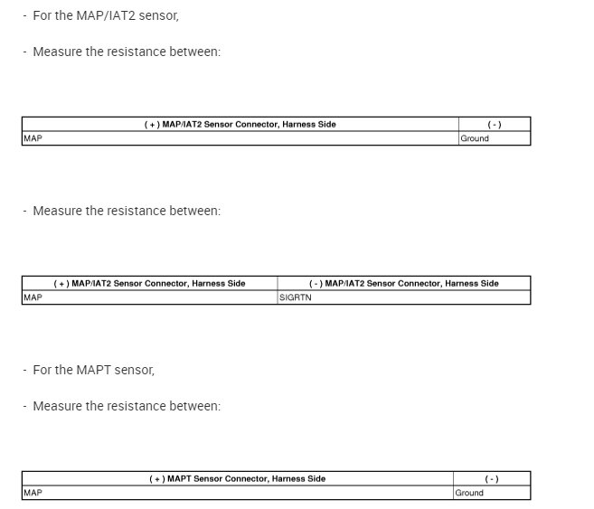

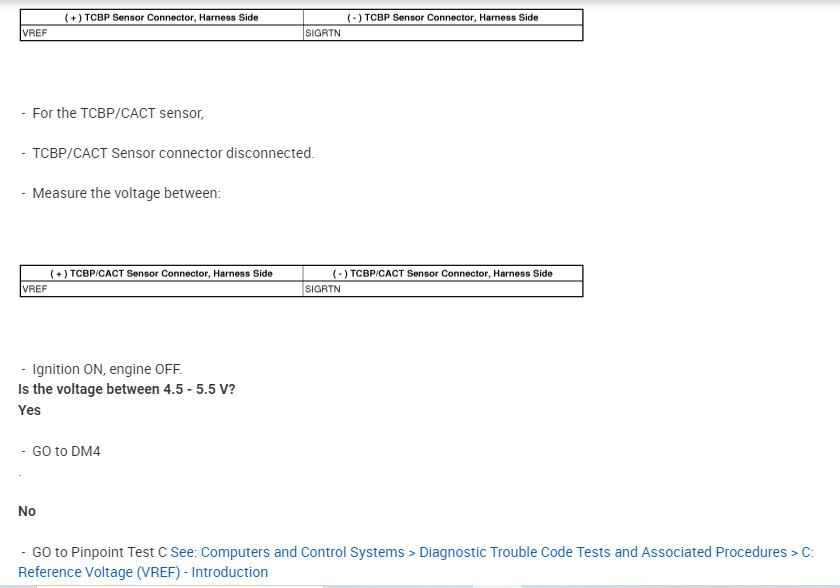

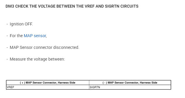

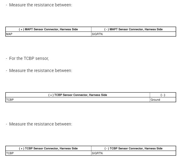

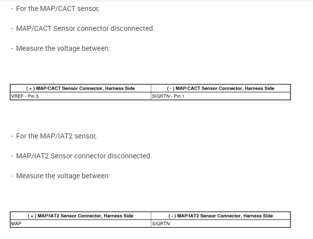

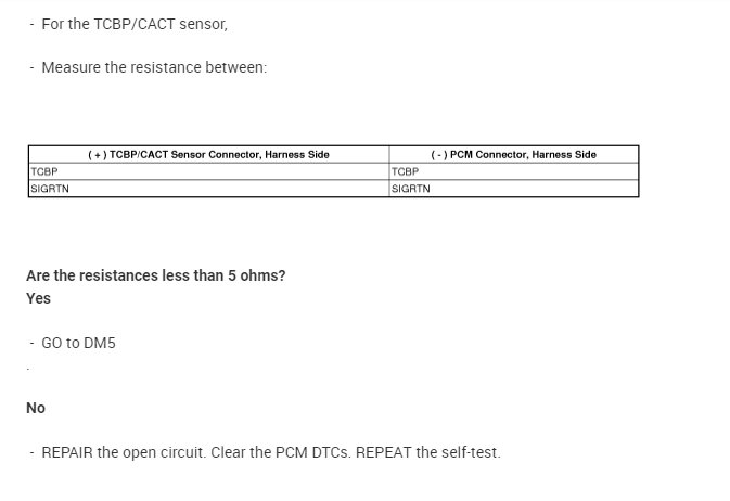

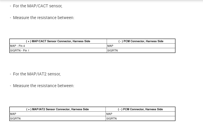

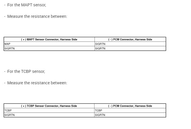

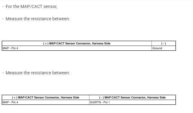

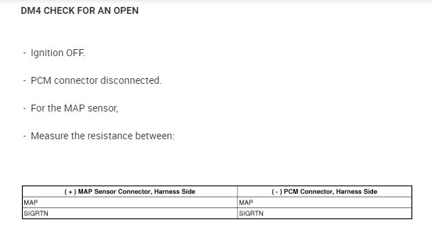

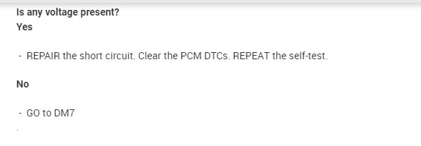

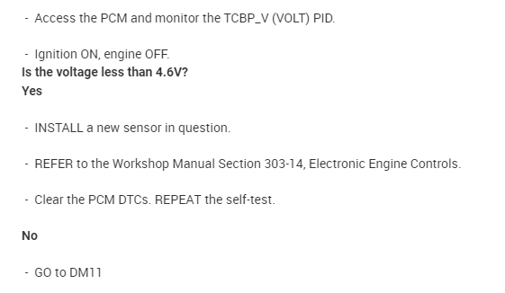

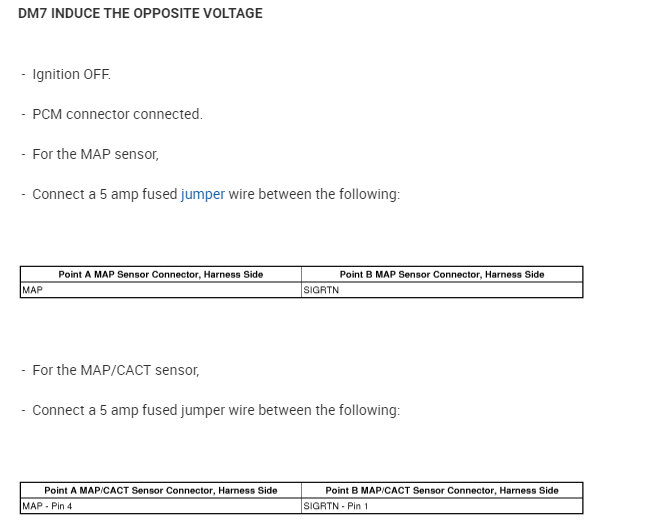

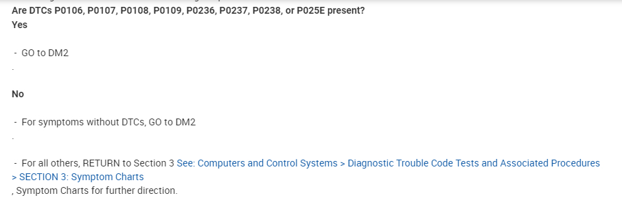

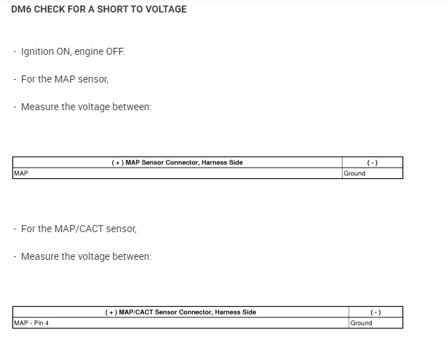

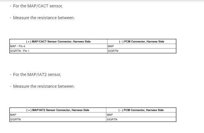

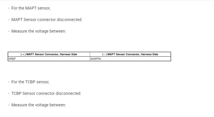

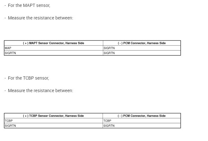

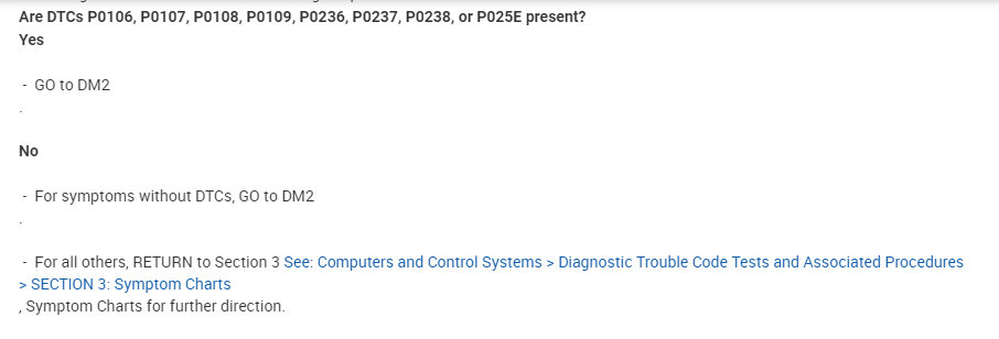

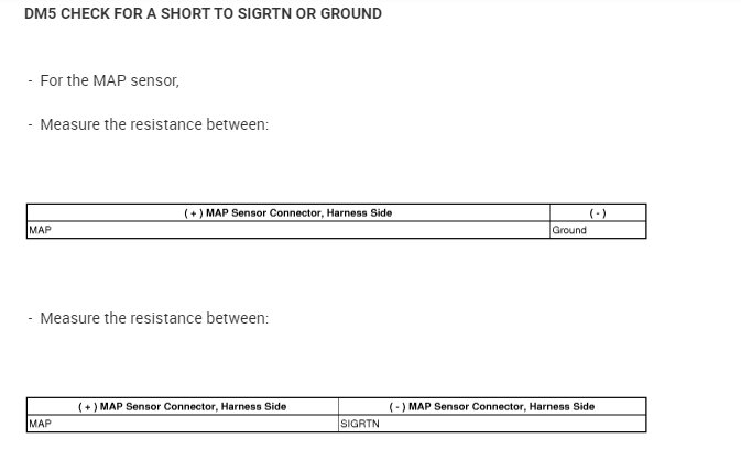

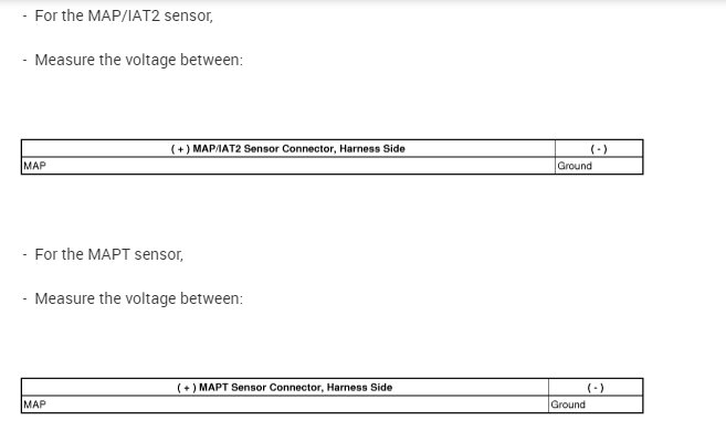

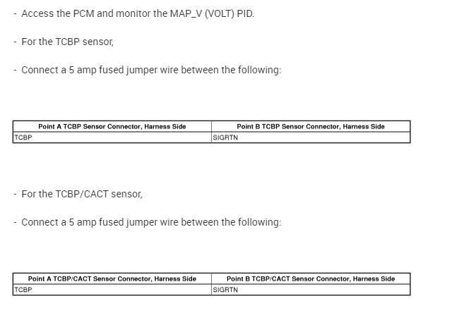

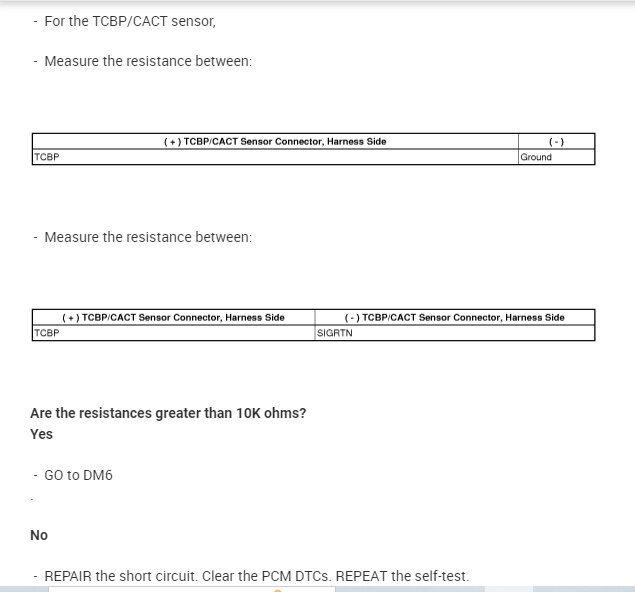

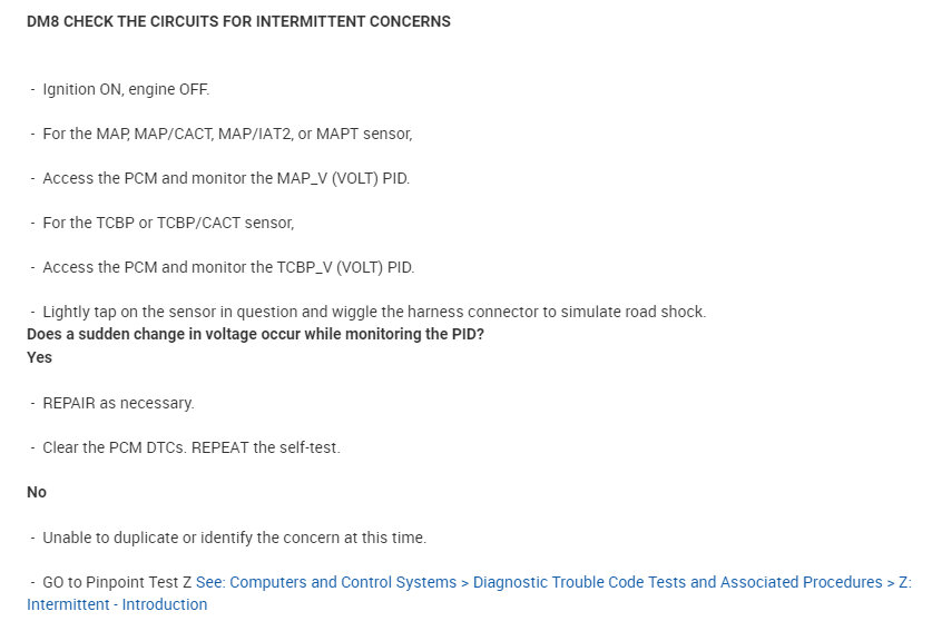

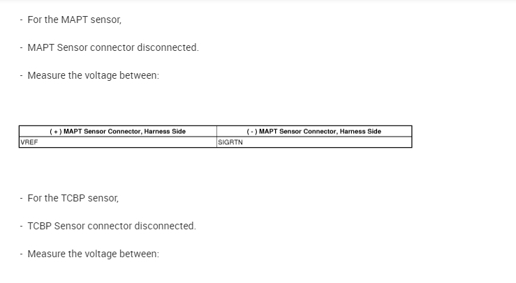

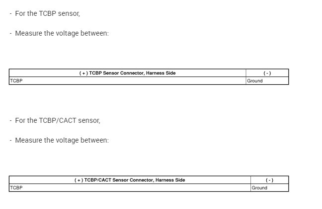

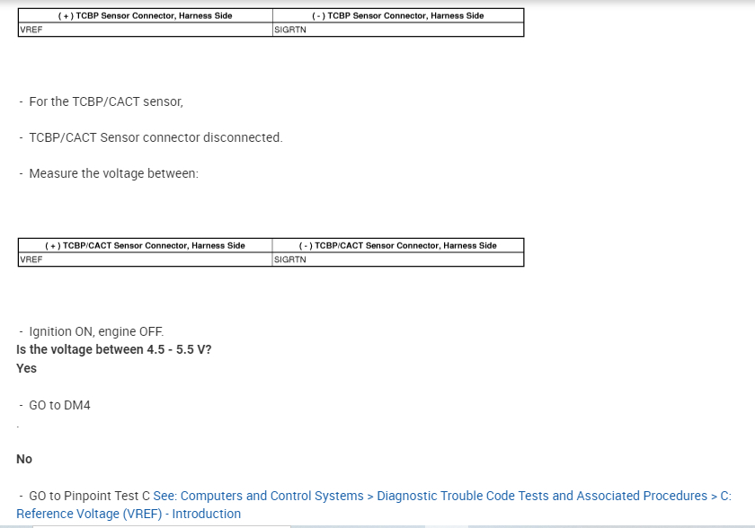

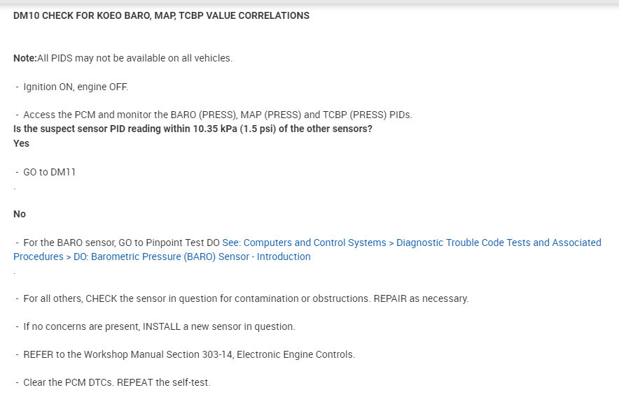

I attached the diagnostics specific to this code starting with pic 2. Don't be overwhelmed by how many steps are listed. Based on the results of each test determines where you move next or how to repair the problem.
Take a look through them and let me know if you are comfortable performing them.
See pics below.
