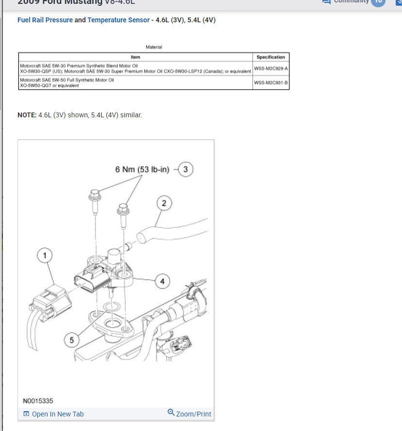

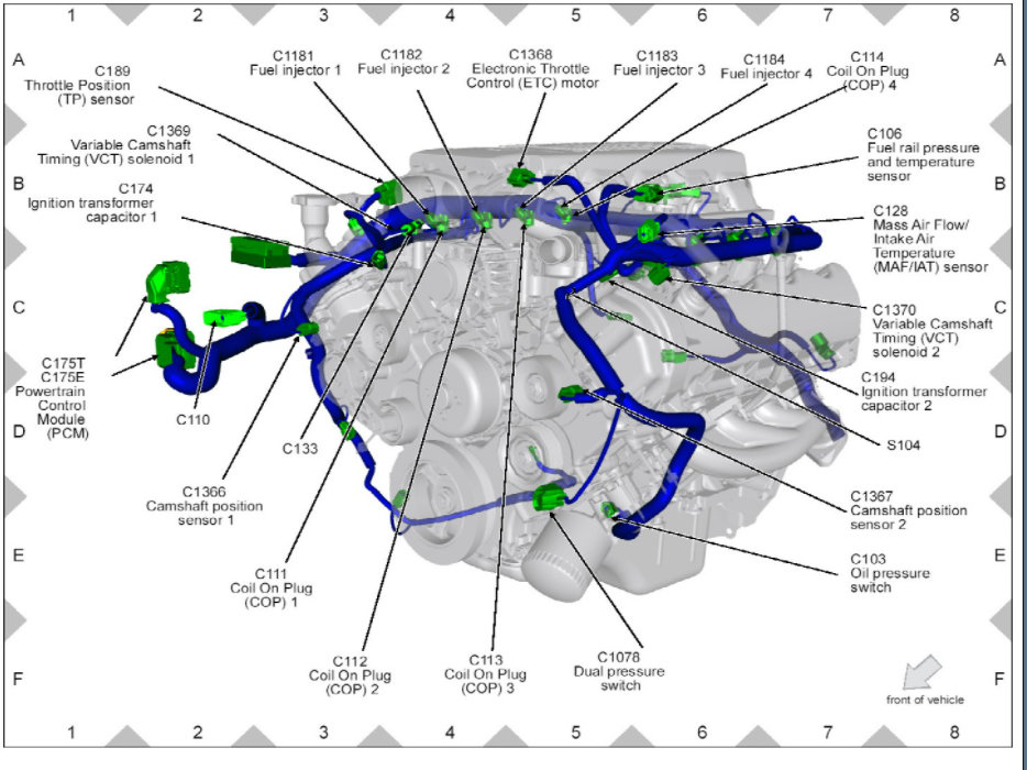

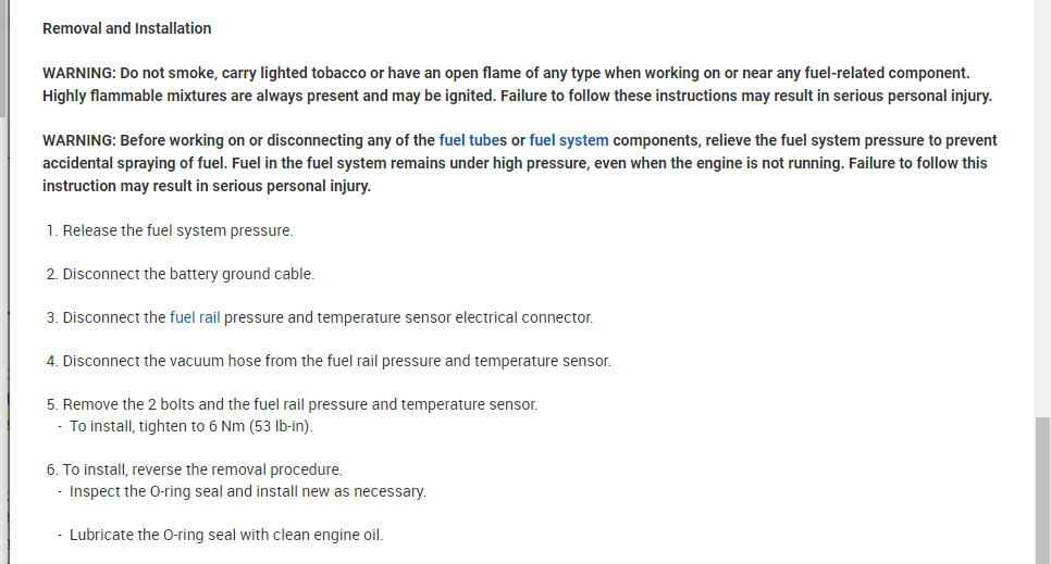

I ran the gas tank down to 10 miles before empty. I had car in Driveway. Tried to pull out of driveway and car stalled. Thought I was empty, so I purchased gas in a can and put 10.00 worth. Car will start then after 10 seconds it will turn off. Purchased a fuel pressure sensor but I cant find it.
